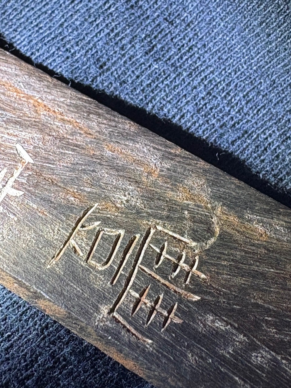

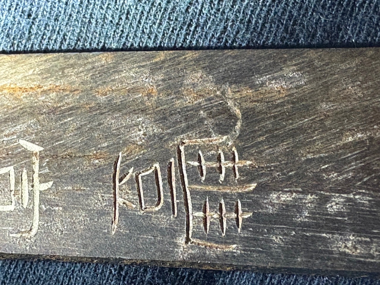

You guys are great, thank you very much. I tell you what, I'm definitely learning a lot more about these swords now! Here is another picture of the Mei , I cleaned out some of the chalk or whatever it was that was in there but it's definitely not painted on.

I actually found a Japanese person who used this name.  When there is one, there could be others.
豊富豊丸 (農薬研究所)
Old vs New
豐 = 豊
  • Wow 1

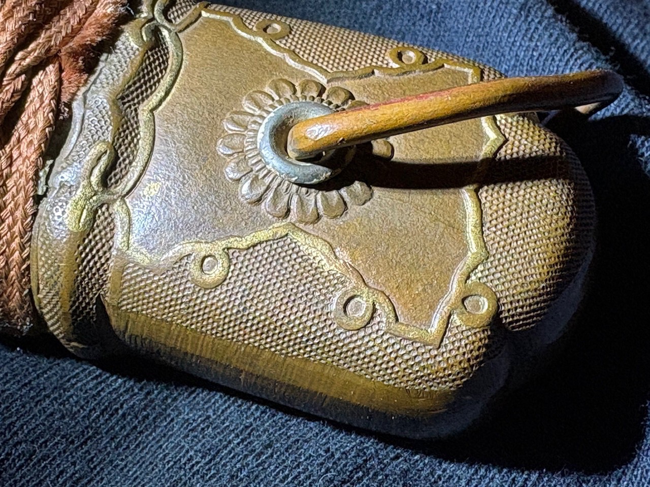

Interesting, so the Mei could be legit then? What about this on the Kabuto-Gane, in this book I'm reading (Military Swords of Japan by Richard Fuller and Ron Gregory) I thought it said that some of the fittings were brass but covered with a brown protective paint. I'm almost positive this "brass" coloring on here was painted on over the Kabuto-Gane to make it appear as though it had brass underneath.
Sesko's list doesn't show a Toyomaru, however there are many late-war smiths we have been coming across that are not in his book.  Anything is possible in the world of WWII gunto.
As with the fuchi, that kabutogane has some nice workmanship.  Not what we normally see from fakers.
The name itself is a plausible Japanese name, but I agree that the inscription looks very amateurish. Could be a real WW2 sword that someone added a name to, to make it seem more valuable. Then again, it could be something manufactured (or assembled) after the war.
Without any documentation of such a smith, it is hard to have confidence that this item is an authentic war relic - even though it may well have been made in or around the middle of the last century.

I honestly think there is little doubt the mei is fake. It just isn't done in the way that mei are done. Can't decide on the rest of the blade though. But the mei seems added for sure.

the mei is terribly cut IMO (done yesterday)
