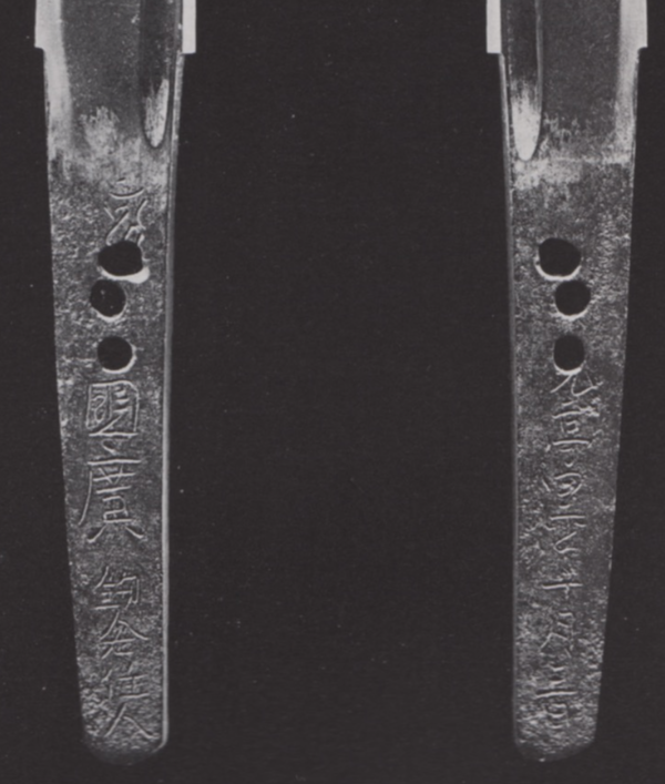

Lewis B Posted August 28, 2025 Author Report Posted August 28, 2025 1 hour ago, Jussi Ekholm said: I believe the end of mei is Buddist name Kōshin 法名光心 Right again. To go from nijimei to a more complex and comprehensive signing style seems unusual if chiseled by Shintogo himself who appears to have been more of a traditionalist (very few dated blades with archetypical nijimei signatures). This is more in keeping with Kunihiro as in the following example. Full inscription on the omote is Bonji + "Kunihiro Kamakura-jūnin"(Kunihiro Resident of Kamakura). Quote
