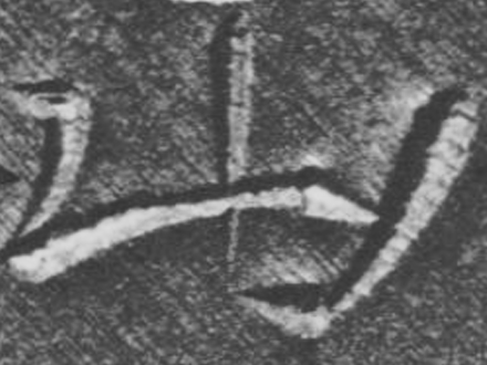

Bryce Posted August 19 Report Posted August 19 G'day Dee, I would say the mei is well within the limits of variability you see in Gassan Sadakazu's work, especially when you consider the low resolution photo of the rusty nakago we are working with. This tanto is definitely worthy of a closer look. The horimono looks strange, because at some point, someone has taken to the blade with a sander and worn it down. It is hard to say from these photos what damage has been done and how much value is left in the blade, but I stand by my opinion that this tanto could very well be shoshin. Jacques are you saying that in general Gassan Sadakazu's mei have some peculiarities or just this particular example we are looking at in this thread? Cheers, Bryce 1 Quote
Lareon Posted August 19 Report Posted August 19 I agree with Bryce, the mei is close enough to warrant a deeper look or at least better pictures, the remnants of the kokuin of Sadakazu is also a good indicator in my eye although i have also seen gimei kokuin for Sadakazu multiple times. As for what is left of the blade. It is damaged but if it was mine and real i would still send for shinsa and polish (easy to spend someone elses money though) As for the negatives on the mei, there are definitely some discrepencies. The san kanji is definitely not typical Sadakazu. If i was a betting man i'd probably go gimei Quote
Jacques Posted August 19 Report Posted August 19 Quote I would say the mei is well within the limits of variability you see in Gassan Sadakazu's work Wrong, there is nothing in this mei to suggest that it is by Sadakazu. This mei is engraved clumsily, whereas Sadakazu's is very regular, and there are obvious errors (red circle). As for the rust and wear of the mei and yasurime, they are highly suspicious for a tanto from that period. 1 Quote
Lareon Posted August 19 Report Posted August 19 for me the san is the biggest indicator. It's missing a strike on the left, the middle is horizontal instead of angled and the right hand stroke is vertical isntead of a curve Quote
Bryce Posted August 19 Report Posted August 19 G'day Guys, Great discussion. Below I have included the other photo of the mei that Gordon posted. You can see it gives a different perspective of the kanji. As I said earlier, we are looking at a fuzzy photo of a rusted nakago, so we can't be sure that what we are seeing is an accurate picture of the mei. In regard to the missing tagane in the "san" kanji, both Gassan Sadakazu and his son Sadakatsu are a little "cavalier" in their use of them. They add them or not depending on whim. Remember, this is all chiseled by hand, so no two mei are exactly the same. You have to look at the way the kanji are constructed, rather than looking for exactly, identical copies. Cheers, Bryce PS Jacques in regard to the rust, where I live steel can get that rusty in under a year, let alone 150 years. 1 Quote
Jacques Posted August 20 Report Posted August 20 @Bryce Nice strawman... Angle is still wrong. What about tagane makura ? Quote this is all chiseled by hand, so no two mei are exactly the same Totally wrong! You've never seen engraving a mei. They can be identical with exactly the same number of hammer blows. 1 Quote

Bryce Posted August 20 Report Posted August 20 G'day Jacques, The oshigata above is a daimei by Gassan Sadakatsu for his father Sadakazu. In regards to every mei being identical, here is a collage I put together of eight Sadakazu tanto mei done in this same style, all around the same time. All of these blades are papered to Sadakazu. Are they identical - definitely not. Cheers, Bryce 3 Quote

Jacques Posted August 20 Report Posted August 20 Quote The oshigata above is a daimei by Gassan Sadakatsu for his father Sadakazu.. Right (you own Fujjishiro's shinto hen) but how can you see it's a daimei ? I've a big doubt the third (from left) on the above line is a Sadakazu from Meiji... https://eirakudo.shop/token/tachikatana/detail/838671 I'm waiting for an answer to my asking 1 Quote
David Flynn Posted August 20 Report Posted August 20 Bryce accepted by whom? As far as I know, if a sword soc. is convinced it's Daisaku, they will either knock it back or paper it as Daisaku. Why not use "Probably" instead? Quote
Bryce Posted August 21 Report Posted August 21 G'day Jacques and David, I don't own any Fujishiro books. Do you accept that it is possible to recognise a person's handwriting? It is exactly the same with nihonto mei. My sole nihonto focus now is pretty much just Gassan Sadakazu and Gassan Sadakatsu. I look at examples of their blades nearly every day and have done so now for about 5 years. To me, the fact that the oshigata Jacques posted is of a blade signed by Sadakatsu for his father, rather than signed by Sadakazu himself is as obvious to me as the difference between night and day. I have a hard time believing you guys can't see it as well. Previously I have posted about a blade signed Gassan Sadayoshi, which has a Tanobe sayagaki, stating it is actually a work by Sadakazu and also a blade signed Sadakazu, with a Tanobe sayagaki stating it is actually a work by Sadakatsu. I shouldn't say daimei are accepted as shoshin, they actually are shoshin. Cheers, Bryce 3 Quote

Jacques Posted August 21 Report Posted August 21 Quote My sole nihonto focus now is pretty much just Gassan Sadakazu and Gassan Sadakatsu. And you are unable to describe the characteristics that these two smiths have in common. You still haven't told me how you knew it was a daimei. Quote

Bryce Posted August 21 Report Posted August 21 G'day Jacques, To add to what Adam said about Roger and Hizento mei, most examples of Gassan Sadakazu/Sadakatsu mei are easy to pick, but there are a small number where it isn't immediately obvious. We are dealing with humans here, not machines, so there is variation. There is no single thing that differentiates or unites the two, it is the sum total of a large number of characteristics. If I use the oshigata that Jacques posted, which I have already said was signed by Sadakatsu and sandwich between it and another Sadakatsu mei one actually signed by Sadakazu, you can see the differences. So Sadakazu in the middle, Sadakatsu each side. Cheers, Bryce 2 Quote
Bryce Posted August 21 Report Posted August 21 Actually, maybe this is a better way of showing the comparison. I replaced Jacques oshigata, with the photo of a Gassan Sadakatsu katana dated Taisho 10 (1921). Cheers, Bryce 3 Quote
Jacques Posted August 22 Report Posted August 22 Bryce, You still haven't answered my question, and I'll tell you why: You don't know the answer. For someone who claims to be an expert on these two swordsmiths, that's a bit silly. An oshigata is not a photograph; there are things that cannot be seen. Quote
