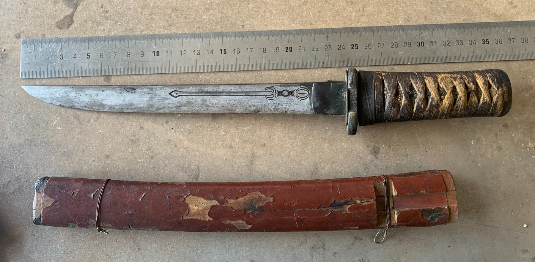

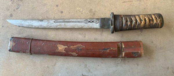

Gordon Bloxwich Posted May 28, 2025 Report Posted May 28, 2025 I have just acquired a knife; I have been told it was brought back to the UK after the First World War by my grandad. I have one very simple question, what is it? Quote
Bugyotsuji Posted May 28, 2025 Report Posted May 28, 2025 Gassan Sadakazu Tantō. (How long is the blade?) (Short answer) 1 Quote
Brian Posted May 28, 2025 Report Posted May 28, 2025 BIG name, and on the off chance that this is a legit signature, this one needs to be treated very carefully...oiled and looked at by someone in hand. If a genuine mei, it would be worthy of a proper and expensive restoration. 2 1 Quote
Bugyotsuji Posted May 29, 2025 Report Posted May 29, 2025 PS When doing your research make sure not to confuse 貞一 'Sadakazu' with 貞勝 'Sadakatsu', another Gassan smith. Quote
Rivkin Posted May 29, 2025 Report Posted May 29, 2025 I am not the person to talk about signatures, but things about this one I don't like. Still horimono is decently executed. Quote
Gordon Bloxwich Posted May 30, 2025 Author Report Posted May 30, 2025 On 5/28/2025 at 1:16 PM, Brian said: BIG name, and on the off chance that this is a legit signature, this one needs to be treated very carefully...oiled and looked at by someone in hand. If a genuine mei, it would be worthy of a proper and expensive restoration. On 5/28/2025 at 12:36 PM, Bugyotsuji said: Gassan Sadakazu Tantō. (How long is the blade?) (Short answer) 刃の長さは24センチです。 Ha no nagasa wa nijūyon-senchi desu. The blade is 24cm long Quote
Bugyotsuji Posted May 30, 2025 Report Posted May 30, 2025 Thank you! Tantō range up to 30cm +/- Gordon, so yours would not be a Wakizashi. 1 Quote

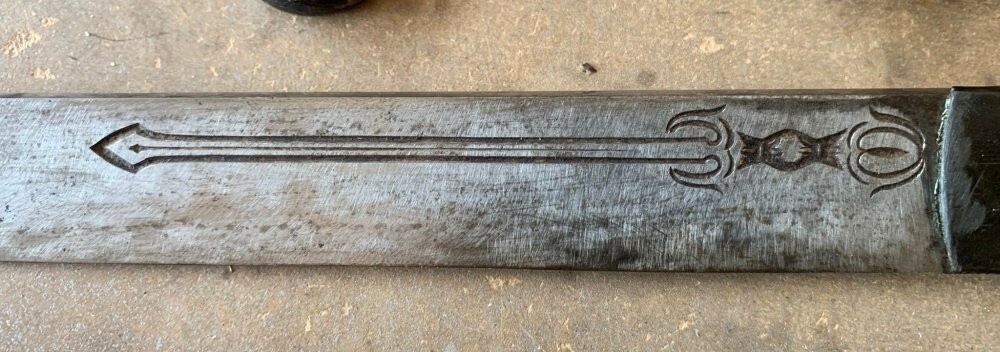

Gordon Bloxwich Posted May 30, 2025 Author Report Posted May 30, 2025 Now realising the importance, here is a better picture of the mei Quote

Jacques Posted May 30, 2025 Report Posted May 30, 2025 Obviously gimei https://sanmei.com/contents/media/N16160_T5801_PUP_E.html Quote
Franco Posted May 30, 2025 Report Posted May 30, 2025 3 hours ago, Jacques said: https://sanmei.com/contents/media/N16160_T5801_PUP_E.html A blade worthy of attention. Quote
Robert S Posted May 30, 2025 Report Posted May 30, 2025 3 hours ago, Jacques said: Obviously gimei https://sanmei.com/contents/media/N16160_T5801_PUP_E.html I think the thought is that this blade would have been made by the grandfather of the person who made the blade that you referenced, so the mei might have varied from that example. Quote
Jacques Posted May 30, 2025 Report Posted May 30, 2025 No, the style of the Gassan family's mei is very particular and has nothing to do with the one discussed here; the same goes for the horimono. I must apologise as i'm wrong with the Sanmei's Tanto it's one of Sadaichi, not Sadakazu... ps Sadakazu was an adopted son of Gassan Sadayoshi.... 2 Quote

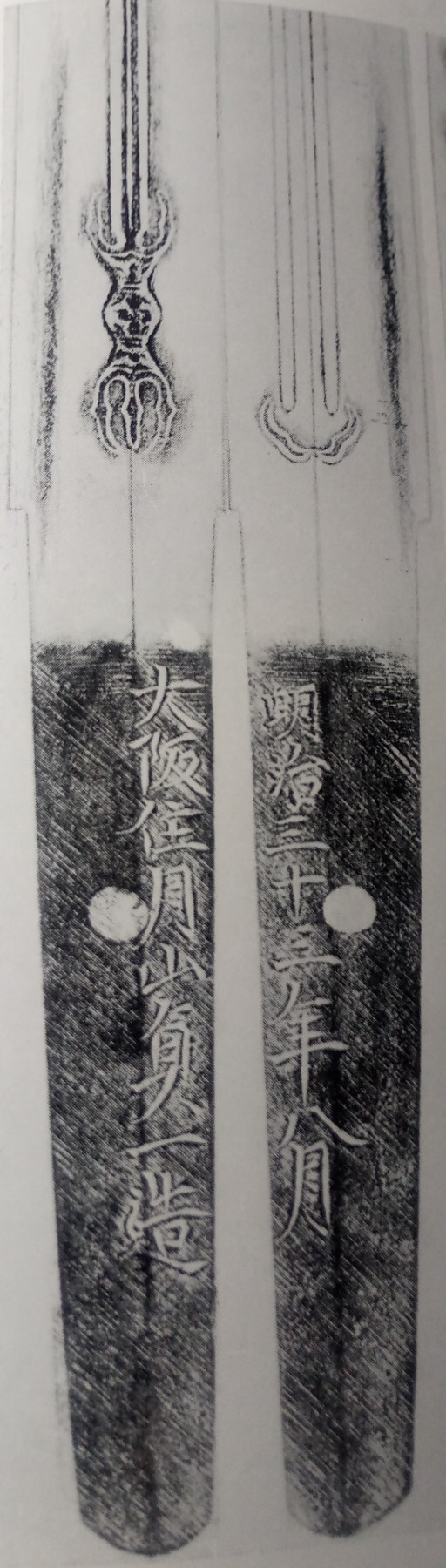

Bryce Posted August 18, 2025 Report Posted August 18, 2025 G'day Jacques, I am not sure what you are asking. Below is a photo of a comparison of two tanto from Gassan Sadakazu from the early Meji period. Both of these have been papered by the NBTHK. During the early Meiji Period you find his tanto with two distinctly different mei and kokuin. For whatever reason, it seems he signed in these two distinctly different styles. One possible explanation is that the tanto on the right was signed by one of his students. The tanto in this thread looks very similar to the right hand one. As I said, the NBTHK paper these and the work in these blades looks like Gassan work. Cheers, Bryce Quote
Bryce Posted August 18, 2025 Report Posted August 18, 2025 I should also add that the tanto in this thread is suriage thru the top of the kokuin. Cheers, Bryce 1 Quote
Jacques Posted August 18, 2025 Report Posted August 18, 2025 1 hour ago, Bryce said: G'day Jacques, I am not sure what you are asking. Below is a photo of a comparison of two tanto from Gassan Sadakazu from the early Meji period. Both of these have been papered by the NBTHK. During the early Meiji Period you find his tanto with two distinctly different mei and kokuin. For whatever reason, it seems he signed in these two distinctly different styles. One possible explanation is that the tanto on the right was signed by one of his students. The tanto in this thread looks very similar to the right hand one. As I said, the NBTHK paper these and the work in these blades looks like Gassan work. Cheers, Bryce You are not answering my question, even though it is quite specific. Quote
Bryce Posted August 18, 2025 Report Posted August 18, 2025 G'day Jacques, I am sorry mate, I am still not sure what it is you are asking. On an impersonal form of communication like this it is difficult to grasp subtle nuances. You will have to use more words or give me a hint. Cheers, Bryce Quote
Jacques Posted August 19, 2025 Report Posted August 19, 2025 Ok. There are some peculiarities in the way the mei is engraved. I ask you what they are. It is visible to the naked eye. Quote
