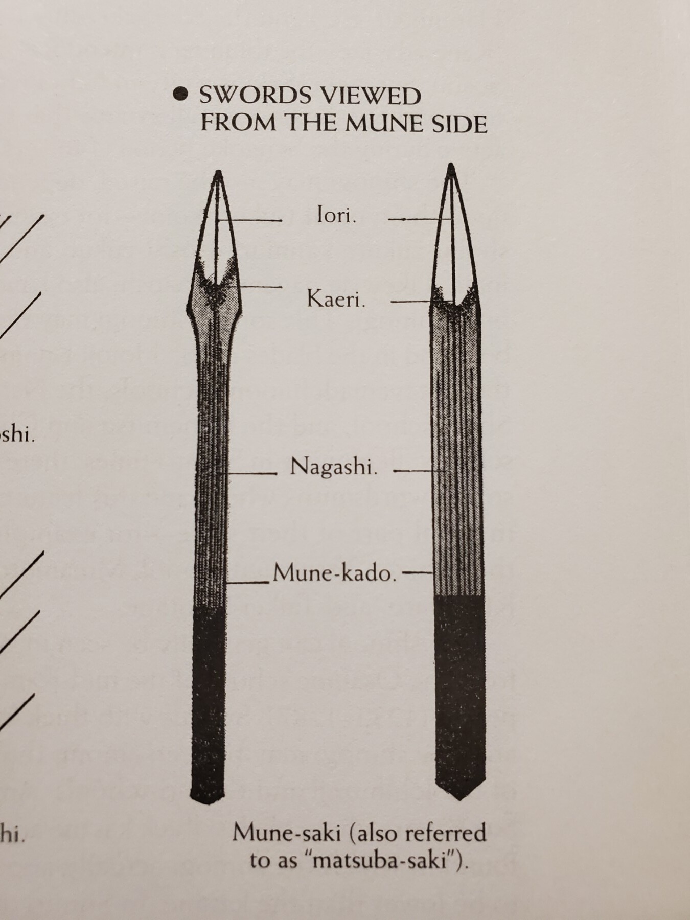

AlexiG Posted April 9 Report Posted April 9 Hi Charlie, I find the uniform thickness at moto-kasane and saki-kasane a bit troubling. In my limited experience, have not seen a traditional katana without taper and would indicate that it is very tip heavy and potentially harder to control (but could be a beast of a cutter, as Koichi mentioned). The one detail is how is it measured. There is a design where the koshinogi widens as it meets the mune. If measured there it may appear as if there is no taper, although overall there is. I have two swords like that from Bugei (decent Chinese manufacture). Its called mune-saki (or matsuba-saki). Is the sword of interest like that? For the record the Bugei swords still taper by 1mm when measured at the widest of the saki-kasane. Depending on your level of experience, 900g may be on the heavy side. Consult with your sensei. Best, Alexi Quote
Charliebrown Posted April 10 Author Report Posted April 10 Hi All, First of all, thank you for all the messages. The points you all have stated are sound. You are right, I should head over to Japan and get my hands on it and try it. Just an interesting post in regards to the thickness and the definition of kasane. Quote
