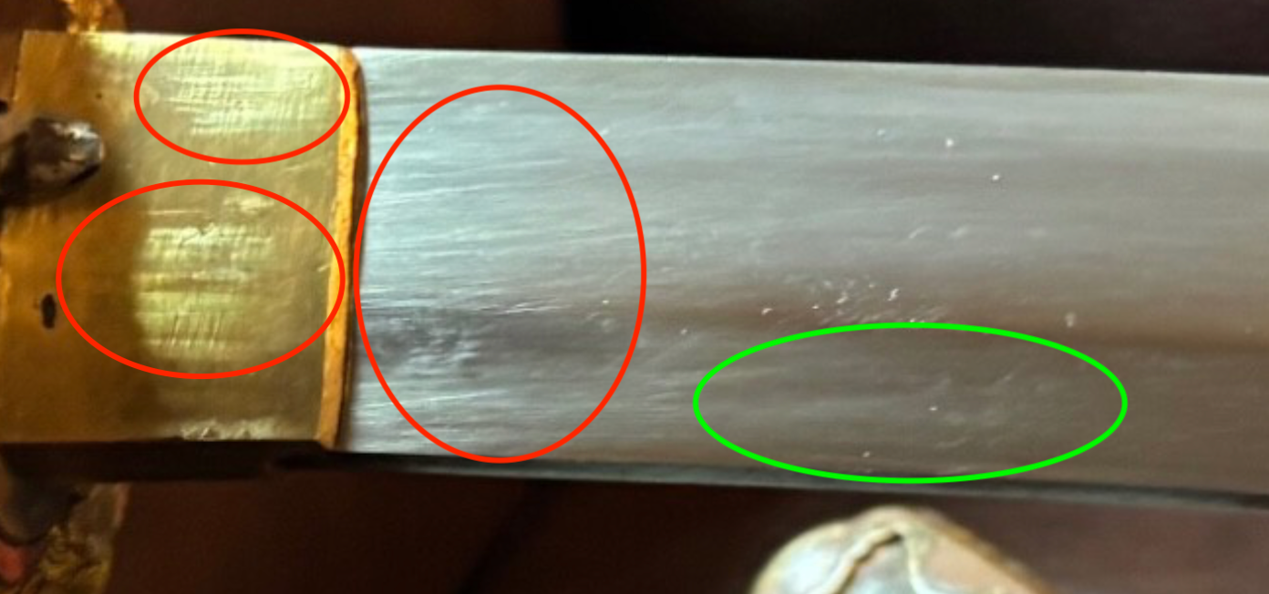

John C Posted February 16, 2025 Report Posted February 16, 2025 Steve: In this one pic, the red circles are scratches and the green circle is hamon. The scratches go all the way to the kissaki. But keep in mind, these could be period. This may have been cleaned shortly after some GI received it. John C. Quote
Swords Posted February 17, 2025 Author Report Posted February 17, 2025 Thanks for clearing up the hamon John As far as I’m concerned regardless who cleaned it ruined the integrity of the sword Not for me I’m returning it Too bad it’s a waste of a nice sword I haven’t had much luck with swords lately people who i thought i could trust cant Quote
