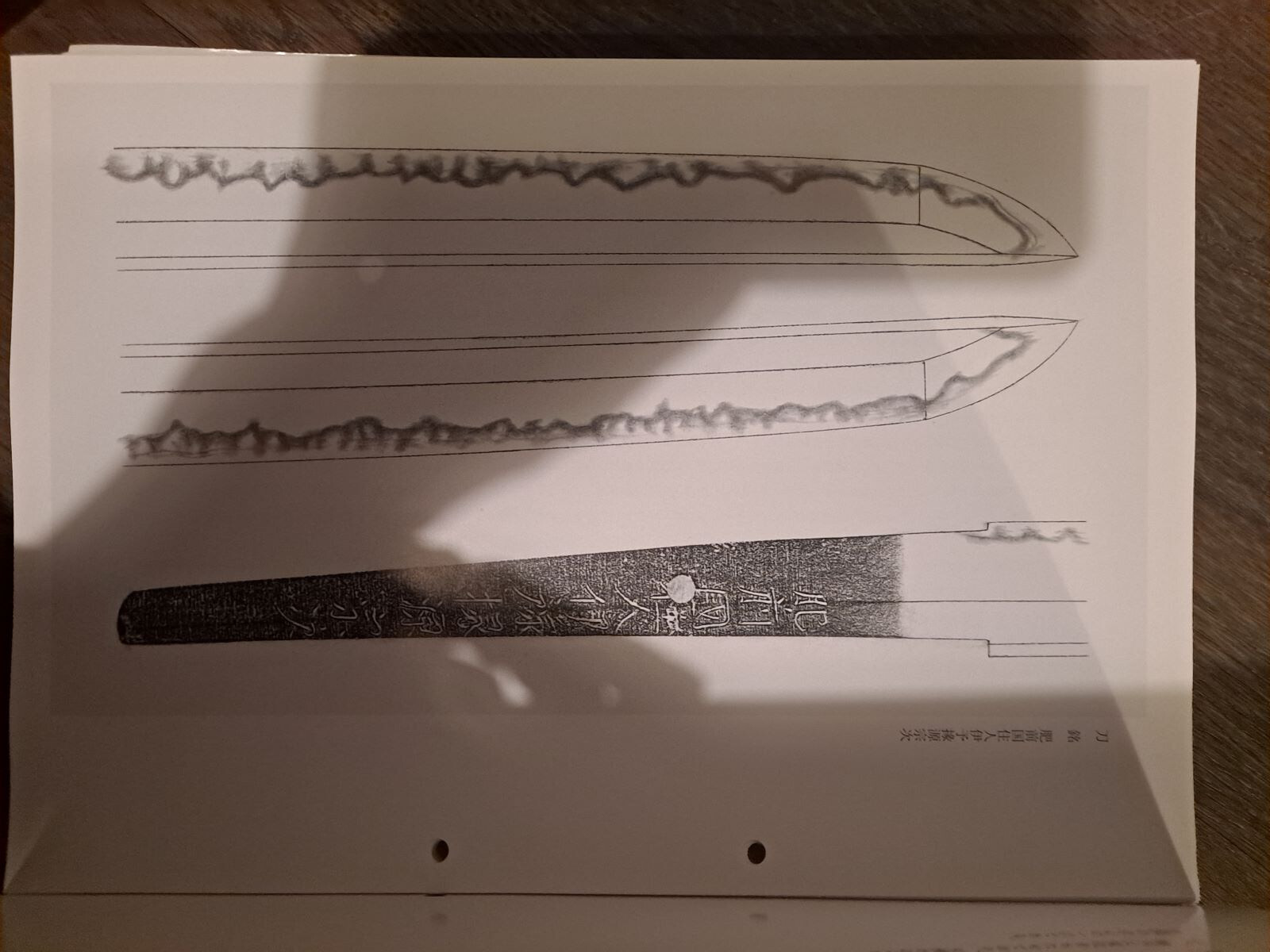

Guest When Necessary Posted January 15, 2025 Report Posted January 15, 2025 (edited) Hi! Another question to throw out there. I know that Hizento (the good ones at least) follow a rule of tachi-mei on katana and katana-mei on wakizashi. Are there any exceptions to this rule apart from obvious gimei? Thanks again! Dee Edited January 15, 2025 by KungFooey Corrected by Jean! 👍 Quote

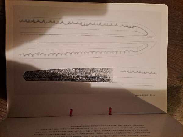

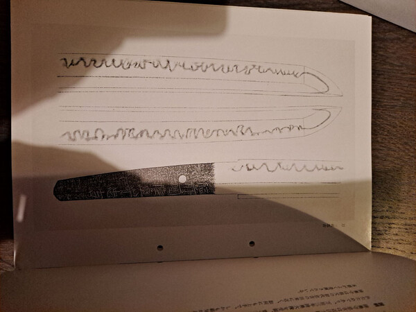

Guest When Necessary Posted January 15, 2025 Report Posted January 15, 2025 Well folks, I just checked the oshigata of all nine generations and that weird 'Kuni' character is a big NO for all of them. Dee Quote
