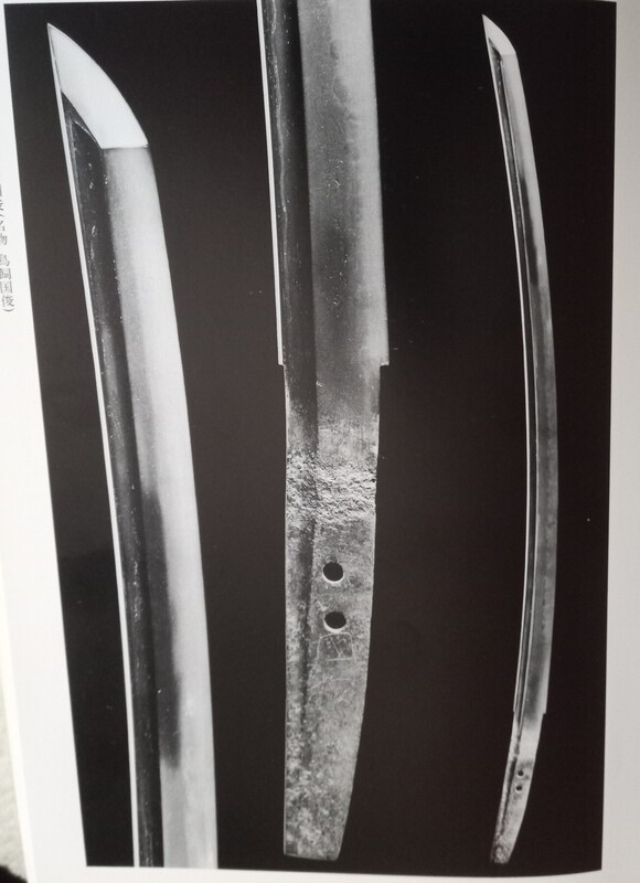

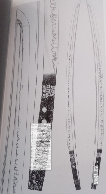

Jacques Posted December 10, 2024 Report Posted December 10, 2024 Nagasa = 60.3 cm Sori = 2.2 cm Motohaba = 3.00 cm Kissaki = 3.2 cm Era, school, smith. a description of the hamon will be a + This sword is famous Quote
lonely panet Posted December 10, 2024 Report Posted December 10, 2024 ichimonji of some sort?? something bizen or ... Quote
PNSSHOGUN Posted December 10, 2024 Report Posted December 10, 2024 Kamakura, Yamashiro, Rai Kunitoshi. Midare Choji. Quote
Lewis B Posted December 10, 2024 Report Posted December 10, 2024 9 minutes ago, PNSSHOGUN said: Rai Quote
ROKUJURO Posted December 10, 2024 Report Posted December 10, 2024 Reminds me somewhat of OEI BIZEN TACHI, YASUMITSU. But difficult to guess without HADA and more details. Must have been close to 70 cm long before SURIAGE. Quote
Mark S. Posted December 10, 2024 Report Posted December 10, 2024 A expert here tells us we can’t tell anything without blade in hand. This is a useless endeavor. 3 1 1 Quote
Jussi Ekholm Posted December 10, 2024 Report Posted December 10, 2024 I refrain answering due to knowing that exact sword. However I must say that just looking at the hamon I would have been in totally incorrect location but pretty much correct time. 1 Quote
Gakusee Posted December 10, 2024 Report Posted December 10, 2024 Well, the oshigata does look more Osafune Bizen than the sword actually is - hence the need to know nie vs nioi, utsuri or not, indeed the finesse of the jigane or the slightly more outstanding typical Bizen hada (even though some have very fine hada)…. 1 Quote
Jacques Posted December 10, 2024 Author Report Posted December 10, 2024 4 hours ago, Mark S. said: A expert here tells us we can’t tell anything without blade in hand. This is a useless endeavor. Don't change what I said, I said you can't see anything on photos (proof attached); that said, you can't really appreciate a sword without holding it in your hand. Quote
Jacques Posted December 10, 2024 Author Report Posted December 10, 2024 This sword is a kodachi signed Kunitoshi (Juyo Bunkasai). It is ubu and the hamon is a mix of gunome and midare choji, towards the mono_uchi we have a suguha with some ko gunome. Hada is a tight ko_itame with ji nie and a dan utsuri. As this sword is featured in numerous publications, it was easy to find its maker Quote
lonely panet Posted December 10, 2024 Report Posted December 10, 2024 Im surprised how difficult the photo and the oshigata make the nakago look. I would have said suriage with daimei Quote
