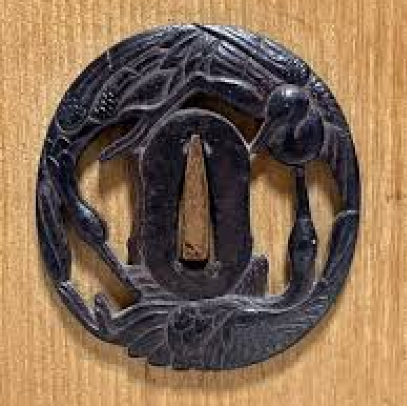

thewarning Posted May 7, 2024 Report Posted May 7, 2024 I'm very happy with my very first tsuba I just received! This opens a whole new world of collecting for me (my poor wallet ð). As soon as I saw it I knew I needed it. I know it's Edo period and in the sukashibori style. What do you guys think and does anybody possibly have any additional information on it? 3 1 Quote
Curran Posted May 7, 2024 Report Posted May 7, 2024 Very good first purchase. Is the red from light fresh rust (you can probably halt or fix with a brush at this point), or did someone paint or lacquer it red? Â My memory says the school is from Kyushu, but I would have to find it again either in the Nihonto Koza or Torigoye. I still owe another member here some Goto references...., so I am hoping someone else can nail it first. One of our Italian members has a great database of NBTHK school attributions. Â It is definitely better than my first tsuba purchase back in 1992. Â Â Â Quote
thewarning Posted May 7, 2024 Author Report Posted May 7, 2024 1 hour ago, Curran said: Is the red from light fresh rust (you can probably halt or fix with a brush at this point), or did someone paint or lacquer it red? It's more lighting than anything else. In person it's more brown with only a faint reddish hue. Quote
Curran Posted May 7, 2024 Report Posted May 7, 2024 25 minutes ago, thewarning said: It's more lighting than anything else. In person it's more brown with only a faint reddish hue. Â Perhaps best to give it a rub-down, now and then, with some undyed flannel. Over time, you'd be surprised how much that can help a tsuba. These little art objects don't get handled as much as they once did when in use and resting against someone's kimono. 1 1 Quote

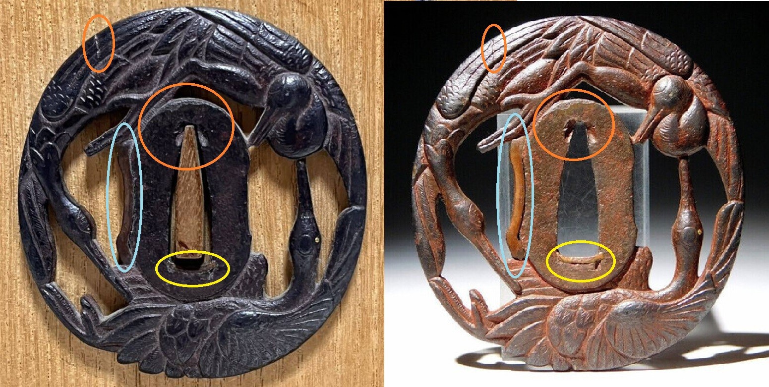

Spartancrest Posted May 8, 2024 Report Posted May 8, 2024 5 hours ago, thewarning said: As soon as I saw it I knew I needed it. Hi Mike, you know you can never just have one - I hope your wallet can take it.  Was it an ebay sale? I found this older [very grainy] image, I am pretty sure it is the same guard. The image might give people a better view of the colour.  A better choice than my first tsuba buy. 1 Quote
thewarning Posted May 8, 2024 Author Report Posted May 8, 2024 15 minutes ago, Spartancrest said: Hi Mike, you know you can never just have one - I hope your wallet can take it.  Was it an ebay sale? I found this older [very grainy] image, I am pretty sure it is the same guard. The image might give people a better view of the colour.  A better choice than my first tsuba buy. Yes, got it on ebay from a recommended seller. And the price was very good IMO. Quote

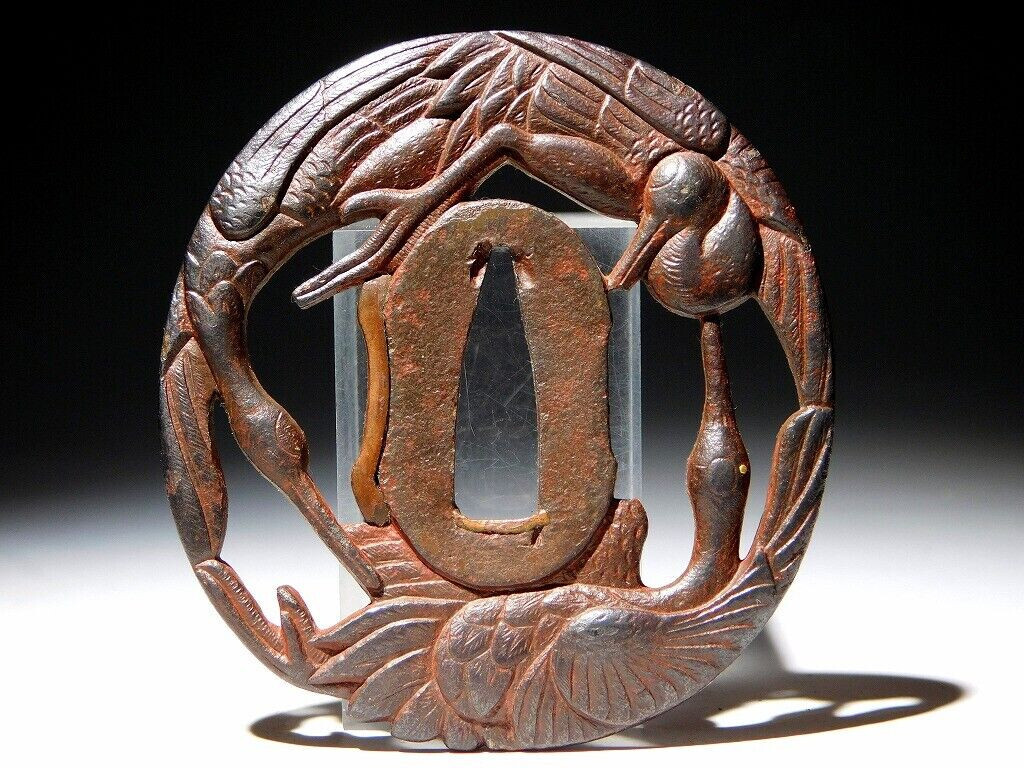

Spartancrest Posted May 8, 2024 Report Posted May 8, 2024 I found it. Jauce/ Yahoo  https://www.jauce.com/auction/e1124708518  or  https://page.auction.../auction/e1124708518  I bet ebay put a higher price on it than you could have had it from Japan though?    70.9 mm x 66.3 mm x 6.5 mm  WT. 92 g. 1 1 Quote
thewarning Posted May 8, 2024 Author Report Posted May 8, 2024 No, that's definitely not the same one. Size, color, condition, etc are all different. Quote
Spartancrest Posted May 8, 2024 Report Posted May 8, 2024 I am not trying to argue but please don't rely too heavily on Digital calipers [they have a tendency to vary every time they are used and certainly between each machine] Just from the visual signs it is unmistakable to me that both are the same tsuba. In particular the sekigane/ategane infill in the left side of the seppa-dai and the tagane-ato marks top of the nakago-ana. If this is not the same tsuba then the only other conclusion is the 'two' are cast [which I don't believe - and I hope I am correct] A nice piece, seen under two different lighting conditions. All the best.  3 Quote
Bugyotsuji Posted May 8, 2024 Report Posted May 8, 2024 Having looked at both of these these repeatedly, I now think Dale has it right. There are other pointers which support this, like on the seppa-dai, the two vertically aligned dots on the right inner rim, and the square hollow diagonally further up towards the beak. 1 Quote
thewarning Posted May 8, 2024 Author Report Posted May 8, 2024 Dale, good eye! I have to agree that is the same one. I was still looking at the grainy image pic and comparing size and weight. What a difference lighting makes too. Thanks for looking into it! I guess this was sold a few months ago to another Japanese seller and he put in on ebay. I'm still just as happy with it. 3 Quote

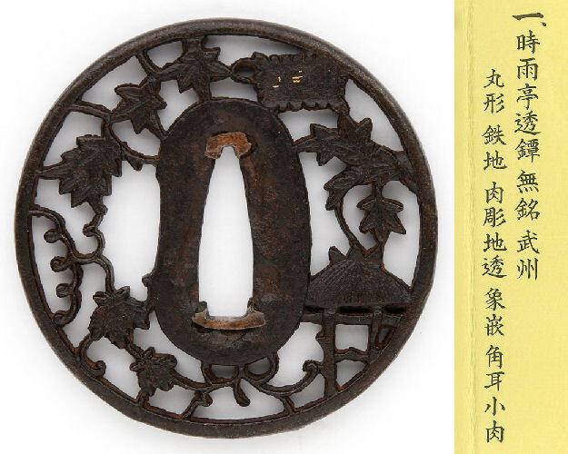

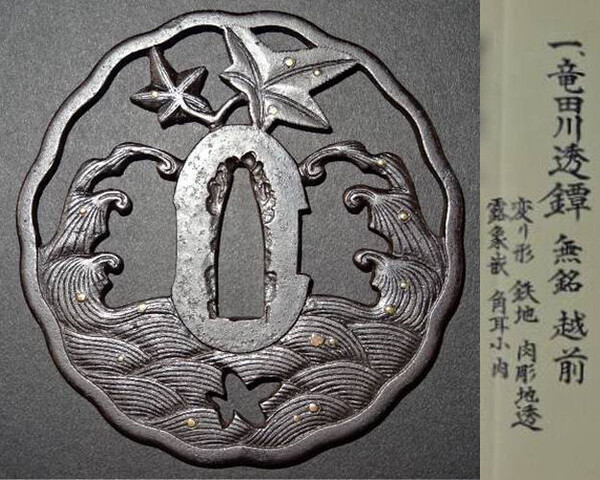

MauroP Posted May 8, 2024 Report Posted May 8, 2024 Hi Mike, nice catch as first tsuba. Curran prompted me to give my not-so-educated contribution. So here we have a piece we may describe as: mitsu tsuru no zu tsuba - äžã€é¶Žå³é maru-gata tetsu-ji nikubori ji-sukashi kin-tsuyu-zÅgan - 䞞圢 éå° è圫å°é éé²è±¡åµ ryÅ-hitsu-shitate (kata-ategane) - äž¡æ«ä»ç« (çåœé). I assume this is a wakizashi-sized tsuba from the middle/late Edo period, not easy to assign to a defined school/tradition. I would suggest 3 hypotheses: Echizen (è¶å), BushÅ« (æŠå·) or ShÅami (æ£é¿åŒ¥). Here just one example for each call:  4 1 Quote

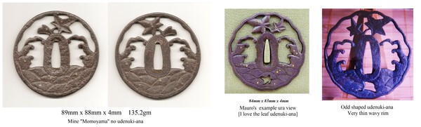

Spartancrest Posted May 8, 2024 Report Posted May 8, 2024  but I could not help but notice Mauro's "Waves & Maple" guard, I have it on my image records along with many of the same design. So you can view the ura of that piece here along with a large one of mine and another with a very thin rim. Sorry, but as I said . 2 Quote
