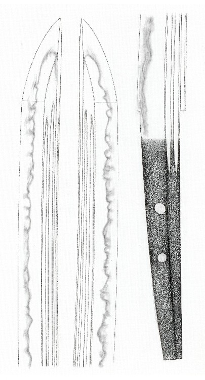

Jean Posted October 2, 2009 Report Posted October 2, 2009 Now guys, forget everything. There is no study blade unless being advanced. Rules of thumb : 1 - read a lot and pound a lot 2 - become member of a Nihonto association 3 - after 2/3 years buy a sword I am not kidding. 70 % (probably more than 85%) of people on Board (I count myself in) are not able to decipher correctly a blade: meaning able to draw a correct Oshigata (even if clumsy :lol: ). So, no study blades (out of polish ...) Go and see a dealer's shop ans study blades there if no associations available. Kantei is "easy" when you have a blade description with oshigata. Most of us (me included) are unable to describe correctly a blade. I have read the nihonto Nyumon and made some kantei, with not too much difficulties. I remember being the only one to kantei Darcy's Miike Juyo, years ago, I was not on the board at the time being and did it through the help of Bob Cole website (a mint of information). I would have been otherwise unable to do it. Learn by heart all the characteristics of a school/smith; match it with the given description/oshigata ==> right answer at 90% atari. Now match what you are seeing on a real blade with what you have learned, unless blatant outstanding blades you'll be far from atari at 90%. Study blades in Nihonto associations and /or Collectors but don't buy low to medium out of polish blades to learn ... you have wasted money I AM TALKING BY EXPERIENCE, I DID IT Quote

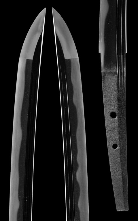

Jean Posted October 3, 2009 Report Posted October 3, 2009 In fact what is an oshigata : it is a hand drawing no more nor less which represents all the characteristics shown by a blade. That's all. As stated by Clive, it takes a lot of concentration (hours) in order to be able to capture all the activities of hamon. Above all when considering a tachi/katana. You must see through the polish. As comparison, for flyfisher fellows (I know they are numerous on the board) it is not unlike fishing at sight with nymph a greyling or trout under running water and watch the strike. It take years to be trained. I shall give an example : here is a picture of my last sword and its Oshigata. Surprising , isn'it Yes Oshigata is an art Doc1.doc 1 Quote
Stephen Posted October 3, 2009 Report Posted October 3, 2009 here is a picture of my last sword and its Oshigata. Jean id love to see it, but the doc file wont open for me. Quote
Jean Posted October 3, 2009 Report Posted October 3, 2009 Stephen, old friend, your desires are orders Quote
