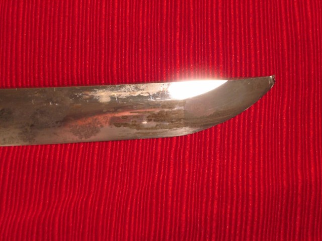

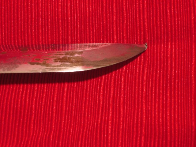

Bruno Posted September 7, 2009 Author Report Posted September 7, 2009 HI everyone! I have another question different than the one I asked. I join pics of a showato which tip is dented.I would like to know your opinion about it. Is it fatal dent or is it easy to repair? Because it should be tempered steel I am afraid the tip will be broken(like glass) if I try to repair it. I will maybe swap my NCO for this showato, but this dented kissaki make hesitate. I will be very happy to have your opi,ions about it; Best regards Bruno Quote
Gunome Posted September 8, 2009 Report Posted September 8, 2009 Hi Bruno, Not a fatal flaw because boshi is safe. A polisher would have enought place to reshape it. Sebastien Quote
Bazza Posted September 8, 2009 Report Posted September 8, 2009 I join pics of a showato which tip is dented.I would like to know your opinion about it. Is it fatal dent or is it easy to repair? Because it should be tempered steel I am afraid the tip will be broken(like glass) if I try to repair it. Bruno Bruno, My opinion is that it is fatal because it should have broken in the first place if it was correctly hardened. The bend as opposed to a break means the steel is soft, which means it isn't correctly hardened or has been damaged by excessive heat that has drawn the hardening. Either way definitely a sword to be avoided like the plague IMHO (In My Humble Opinion) Regards, Barry Thomas. Quote
george trotter Posted September 8, 2009 Report Posted September 8, 2009 Hi all, Two comments...first, Bruno, I would have to agree with the above warnings that a bent tip or curled edge is a bad sign...if you are considering acquiring this sword, I would advise you to save your money...it is a sign that the metal is soft. Next, about the sources for my comment that it is said that one can't really tell if a sword is tamahagane even when it is traditionally polished. Remember, the discussion context was WWII Seki production by tosho (eg Fukumoto Kanemune) capable of making traditional swords from tamahagane and also of different steel...but made, shaped, signed in the identical way (not stamped gunto). Kapp and Yoshihara 'Modern Japanese Swords and Swordsmiths 1868 to the Present, pages 62-63 says about Seki WWII production that both types were made there but that the vast majority were not made from traditional steel (tamahagane) and those not made of tamahagane are called Showato to distinguish them. "The range and quality of these Showato is very broad. The better ones are almost impossible to distinguish from traditional blades" (I presume these to be in full polish). Also this work was "...of such a high standard that it was almost impossible for swordsmiths or experienced collectors to determine if the blade was traditionally made or Showato". They were so good that mei were forged and the blades sold as genuine old swords. I have read this elsewhere also (Ohmura?) but as most of my books are in storage I can't quote other sources just yet. I would be interested in discussion on this point from the other Nihonto site members as there are a number of factors to discuss on "Traditional Nihonto-Tamahagane" issues. Regards, George. Quote
