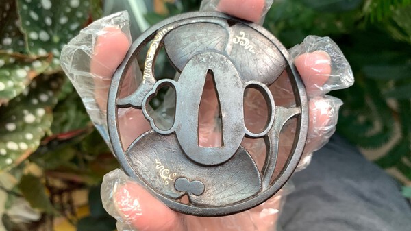

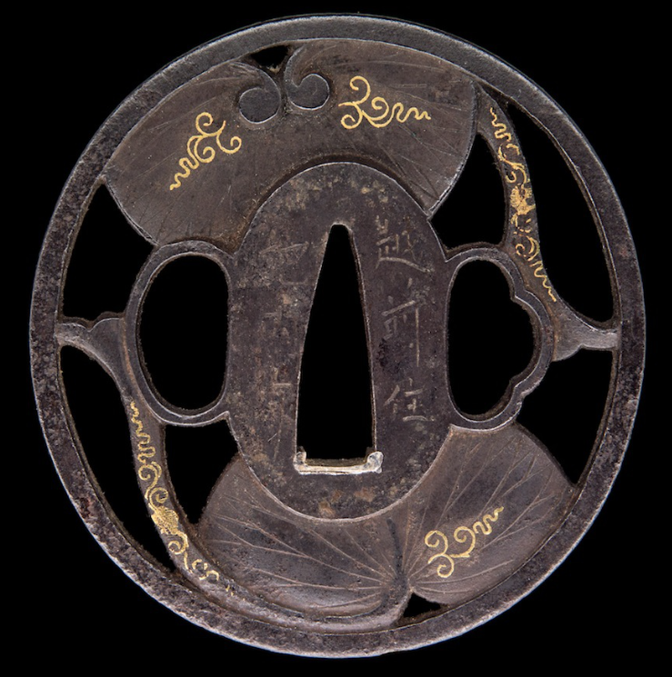

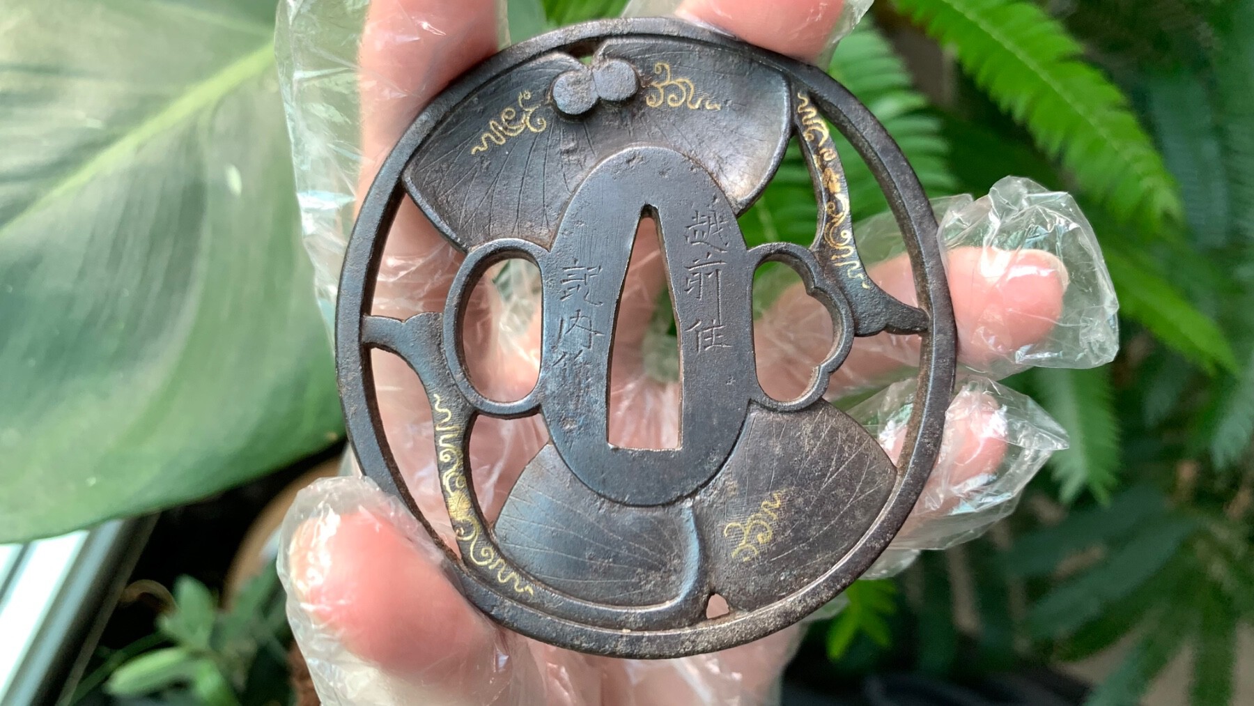

I am looking at this tsuba.  I like this aoi leafs motif. Have seen already like 20 different tsuba with the same design, but they all looked very poorly executed.
Also I can see hatching under brocken inlay.
Don't know about the signature.
Is this an authentic piece?
picture(33).thumb.jpeg.8c859072dca7be5406220a3b4fd15727.jpegpicture(32).thumb.jpeg.2bff1f89e8638b46085d23e33ccbbfec.jpeg
Vitaly, it's likely authentic in the sense that it was made during the Edo period by the Kinai school, but it probably wasn't intended for a "samurai". It doesn't look like it was ever mounted on a sword either.
At a certain point, this school cranked out lots of mass produced "shiiremono" (ready made) tsuba, often with some light hand finishing (like that gold nunome) to dress them up a little. They also did quality handmade commissioned pieces. I've got a good quote somewhere to back that up, based on Japanese research on the Echizen smiths that was translated to English... gotta dig that one up again and post it, but this is what I recall from memory.
So when it comes to this school, you need to take your time and learn to distinguish the high quality ones from the generic tsuba that were made for the masses, as souvenir items.
These types of "ripples" in the seppa-dai are quite common in cast pieces.
There should also be "alarm bells" going off when you see weird gaps or missing areas in the relief pattern, like on the mimi (rim) of this tsuba... it doesn't look like a proper delamination of layered/folded steel, and looks more like a strange casting flaw.
Whether it was cast or not, it's not a high quality piece.

I have an almost identical one I think. I see nothing wrong with it. Fairly standard and genuine Kinai tsuba. Not cast, just a decent example of a fairly typical example. Worth what he's asking easily.

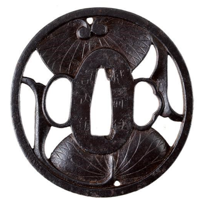

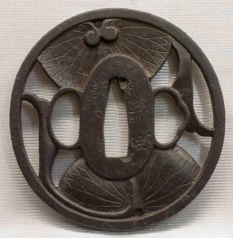

These two have the same "verticalness" to the stem on the left, and the same lopsided seppa-dai and faux punch marks as tegane-ato... definitely cast
image.thumb.png.f1b8d298d41ad59075058bacd720038c.pngimage.thumb.png.40920452729e56c0372959b061cc68f9.png
These three look more like the one Vitaly is looking at (I had to remove the background on the second one, so there's some chunks missing from the image, not the tsuba). The third one is obviously cast, while the second one has some interesting "remnants" and irregularities inside the sukashi in certain areas.
image.thumb.png.6043e7ed2b596cf60e4e6bfeb81a0d4e.pngimage.jpeg.137f62213bddb5d533d45a55a267fd54.jpegimage.thumb.png.c1fa85d38fe3017298976f70c857864d.png

Glen is correct there are various 'grades' of these Aoi design guards. They are in fact still being made! Vitaly the one you are looking at is probably mid range? It does have the gold accents and it looks in good condition but I also agree with Brian that it has not been mounted, so that could well account for its good condition.

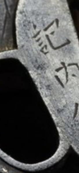

If they are cast I wonder if there are more with the same crooked “記” kanji as mine. I have a couple of them but only one has a “ribbed” pattern on the edges of the leaves. An example of the different “grades”?
