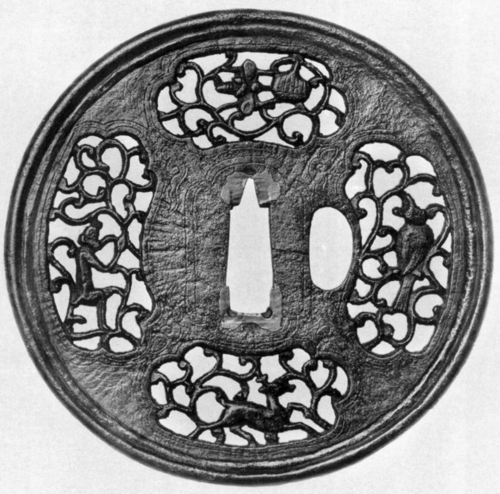

Gakusee Posted January 15, 2022 Report Posted January 15, 2022 Oh, well, as you are so very interested ….. 6 Quote
Spartancrest Posted January 15, 2022 Report Posted January 15, 2022 (edited) Michael, where did you find number two? Just noticed it is top row far right, the nakago-ana gives it away. Only two with dimensions which is a pity. [I can't see one being bigger in only one dimension - it may be a typo or bad measurement?] Edited January 15, 2022 by Spartancrest closer look 2 Quote

Gakusee Posted January 15, 2022 Report Posted January 15, 2022 No, no special book. Have to work with the Juyo Zufu directly. 2 Quote

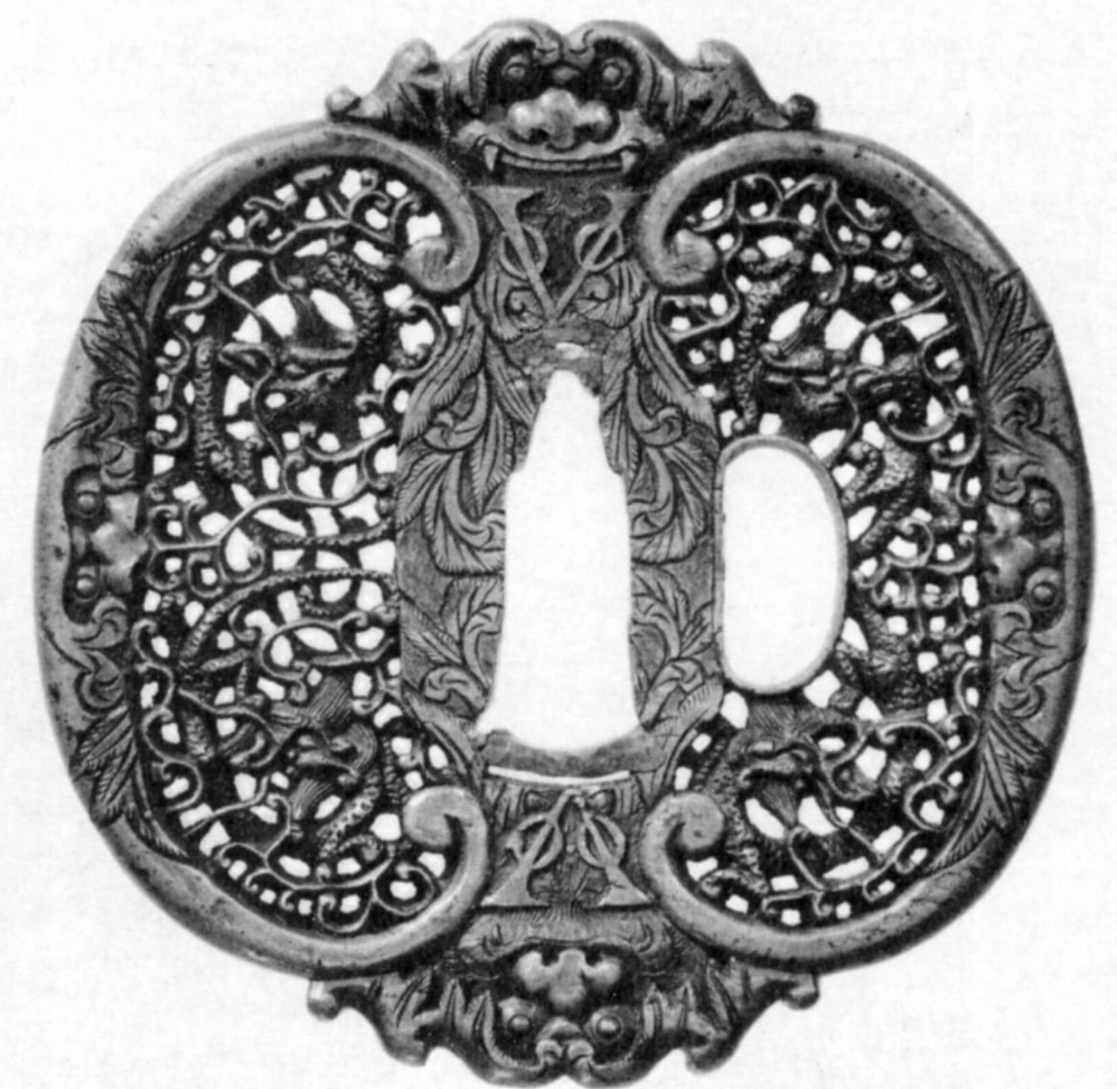

Spartancrest Posted January 16, 2022 Report Posted January 16, 2022 Sorry but can someone explain why this tsuba would be awarded Juyo status when it was made in some numbers - possible Shiiremono, or may even have been made in Sri Lanka? Quote
roger dundas Posted January 16, 2022 Report Posted January 16, 2022 And carrying the 'Dutch East India Company' logo oVc. Roger j 1 Quote
Curran Posted January 16, 2022 Report Posted January 16, 2022 53 minutes ago, Spartancrest said: Sorry but can someone explain why this tsuba would be awarded Juyo status when it was made in some numbers - possible Shiiremono, or may even have been made in Sri Lanka? I can't. To add to the complexity of this art or hobby interest, the difficulty of passing Juyo has changed over the years. --There are some Juyo that I think would barely pass TH. Conversely, there are some tsuba that would barely make Tokubetsu Hozon these days that are Juyo. Omissions like why no Juyo Saotome? There are a few incredible ones, but I've been told "There are no Juyo ones, so the NTBHK won't make any Juyo" And so on. Incredible work by Jussi. 3 1 Quote

Jussi Ekholm Posted January 16, 2022 Report Posted January 16, 2022 Awesome job Glen. As tsuba and other fittings are not my forte, if you guys find any errors you can message me and I will correct it for the next update. I was trying to look into the Nanban tsuba that is being discussed, unfortunately I can't get the text typed in today and trying to figure it out. It has been attributed to Momoyama period by NBTHK. The size of it is 7,4 cm X 7,3 cm. 1 Quote
