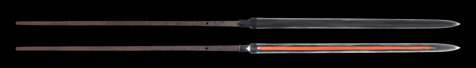

This is the best representation, so far, of the size comparison of different types of yari. I really don't want to call the one I am getting an Omi Yari, since that seems to imply that it is very long. The one I am buying is resembles the thick one in the center of the picture, but in my opinion, may be a little thicker than the one shown.

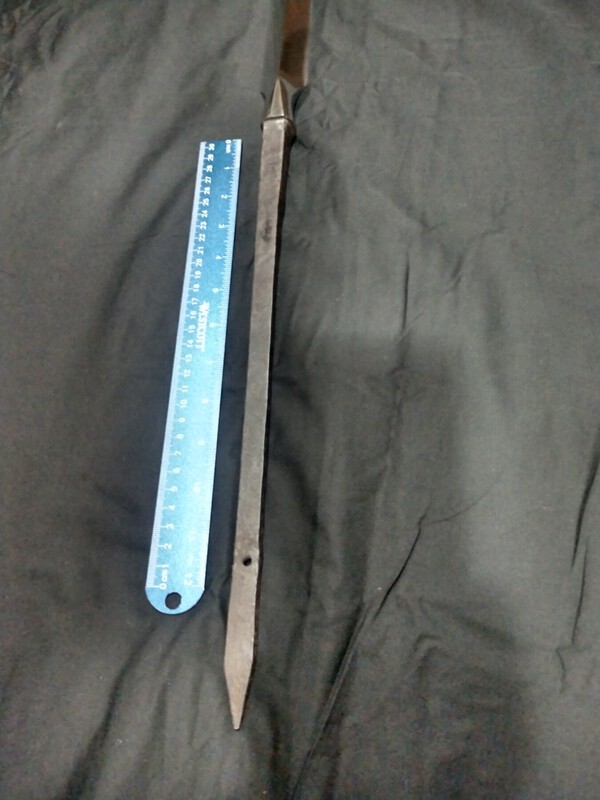

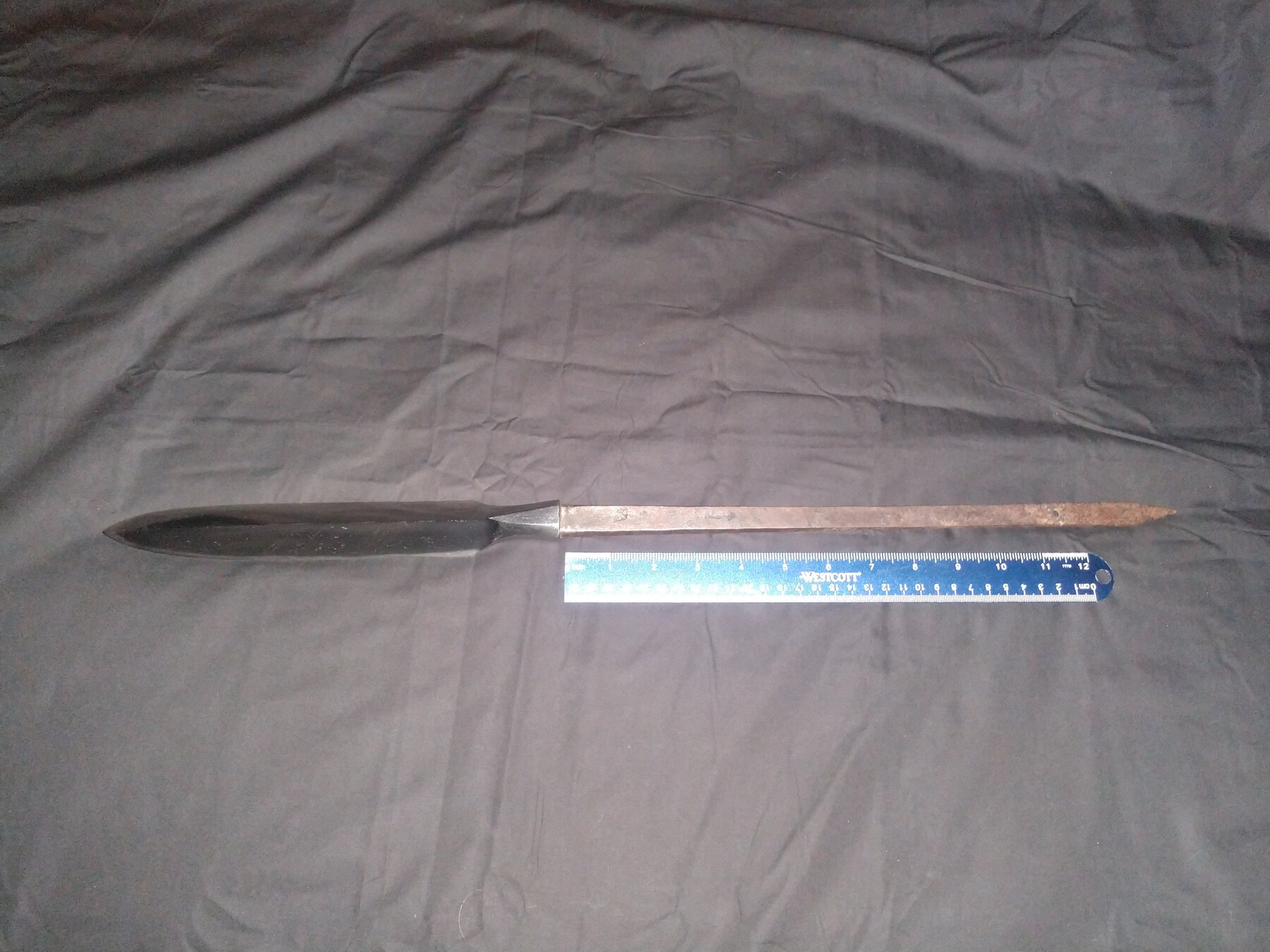

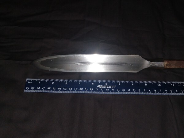

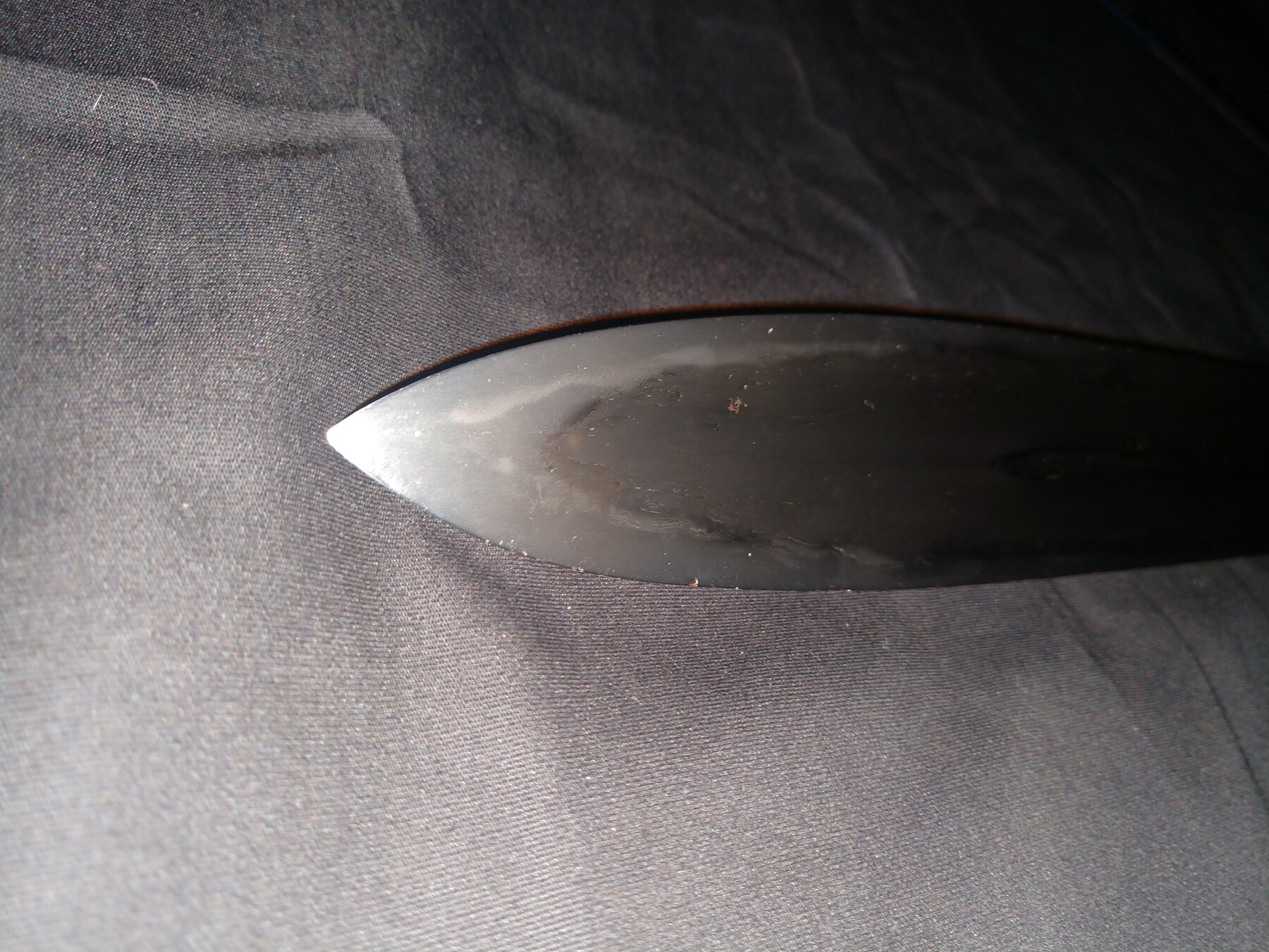

Came home from work today and it was here, waiting on me.
So the actual nagasa is 9" (22.8cm) the overall length is 24.5" (62.2cm) the width across the wide flat is 1.5" (3.8cm) the nakago is 11/16" (17.5mm) square, at the largest point and is 14.5" (36.8cm long)
That is going to be a huge pole to mount that monster!
  • Wow 1
Hard to tell from the pictures, but the nakago is a brownish black, and the mekugi-ana is punched. I would guess early Edo period. Could it possibly be late Muromachi period?
A long kerikubi (the part between the blade and the tang) is usually an indicator of a koto yari. The one on yours is long so, yes, it could be muromachi.
