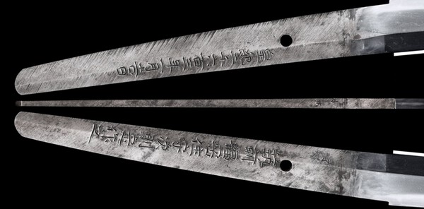

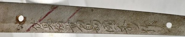

I have a RJT star stamped blade by Takashima Kunihide of Fushimi, Kyoto - dated August 1944 and numbered on the back of the tang 98.
Here also  is a pic of a NBTHK papered sword signed by Takashima Kunihide of Fushimi, Kyoto - dated August 1944 and numbered on the back of the tang 90.

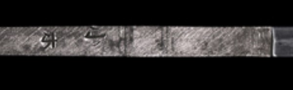

The star stamp on mine (see pic) is almost invisible - so lightly stamped. The same applies to the papered blade...I think I can see it in the poor pic ...wouldn't say for certain...look just to right of top peg-hole (same place as on  mine).
So you have two blades made at the same time, same place, by same smith, with same army stamping numbering system and one is papered.

I’m going to continue this conversation with you Jacques, for a little longer, but I realize it’s probably a waste of my time. You obfuscate and sidestep factual points of the conversation.
The reason we posted the swords above with papers was to directly counter your claim that I just quoted. No other reason than that.
