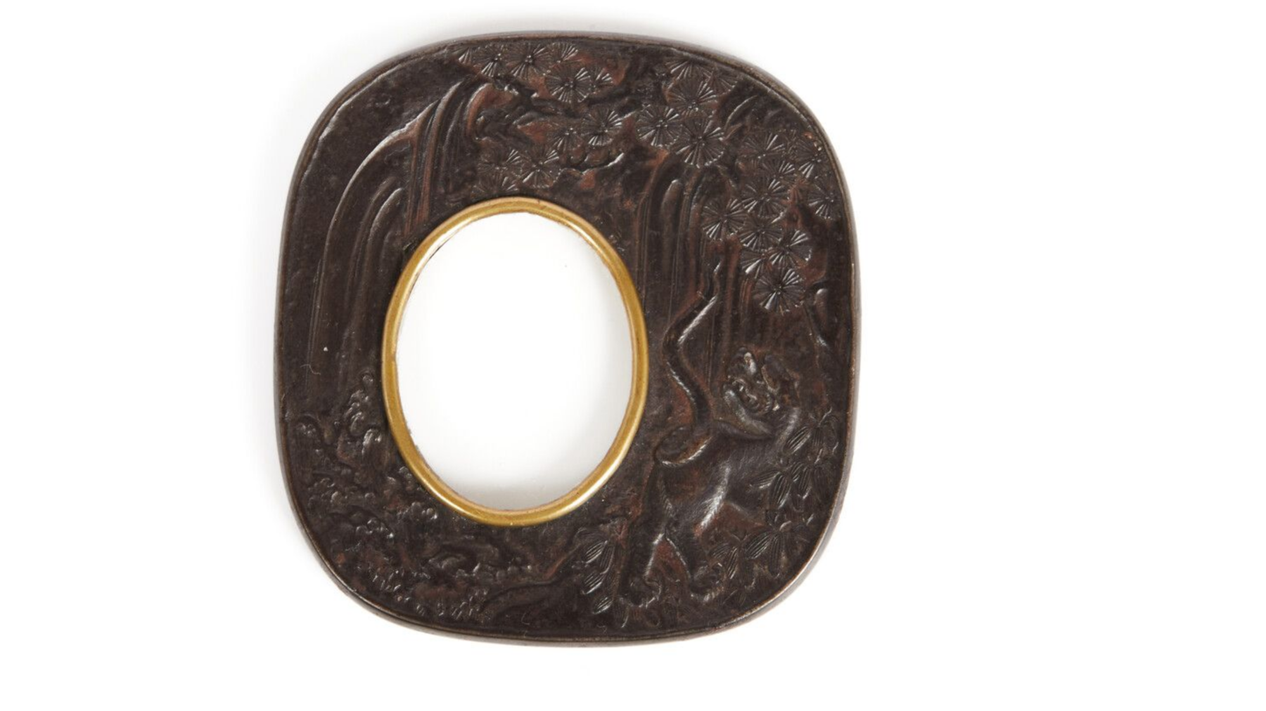

PietroParis Posted June 2, 2021 Report Posted June 2, 2021 Hi All, This object is currently on sale in a French auction. It is described as a tsuba but it's obviously something else, it looks as if it would be attached to the saya rather than the blade. If that is the case, what would be the point of simulating a tsuba? Quote
Gunome Posted June 2, 2021 Report Posted June 2, 2021 Hello, Probably a (very late) tsuba transformed in a photo frame. 1 Quote
PietroParis Posted June 2, 2021 Author Report Posted June 2, 2021 The hole is nicely framed by the decoration, it does not look like it was added later. 1 Quote
Geraint Posted June 2, 2021 Report Posted June 2, 2021 Dear Pietro. After the Haitorei a lot of very skilled craftsmen suddenly found their livelihood under threat. Fortunately a thirst in the west for Japonisme came to their aid. Some items were sold as antique, some were made especially for export and a whole host of items were produced as examples of Japanese decorative art. We have all seen the cutlery with kozuka handles, menu holders and so forth. My Father in law had a beautiful Vesta case or match safe in iron with exquisite takazogan, clearly made by a fittings craftsman but a Western artefact. Tsuba shaped objects such as you illustrate do crop up mounted with small clocks and as Sebastien suggests, photograph frames. In this case I do not think this is converted, I can't visualise a seppa dai fitting with the design, but I suspect it was made as a tsuba shaped object with the frame, never converted from a truly Japanese object. Many years ago I came across an illustration of a pair of candlesticks, each formed by stacking twenty or so fuchi on a tsuba and soldering the whole thing together. Upset me for a long time. All the best. 3 Quote
Sunny Posted June 2, 2021 Report Posted June 2, 2021 could be used as a fancy offline uneven hand guard for a Nagitana ? lol Most likely made into a picture frame like said above. I've seen Kozuka sets turned into handles for European knives and fork sets. Almost stopped breathing for a bit and gagged to take air back in. Looks like it was a nice piece before someone decided to mount Grandma in it. thanks for sharing. Quote
Bugyotsuji Posted June 2, 2021 Report Posted June 2, 2021 How thick is it? There were some fancy finger catches for sliding Shōji or cabinet doors, but they had a plain ‘pan’ section, not cut out like that, and if metal would probably have been quite thin.(?) 1 Quote
MauroP Posted June 2, 2021 Report Posted June 2, 2021 Hi, I think it's just a tsuba for a bokken. Possibly this one was originally made to be mounted on a wood sword (late Edo to Showa), but I've seen some true old tsuba modified accordingly. 1 Quote
Toryu2020 Posted June 3, 2021 Report Posted June 3, 2021 Is the other side decorated? If not then I vote for "door handle" as suggested... -t 1 Quote
Spartancrest Posted June 3, 2021 Report Posted June 3, 2021 You will notice the clock example completely covers the seppa-dai area of the guard - however in this case the hole is round and not oval. 2 Quote

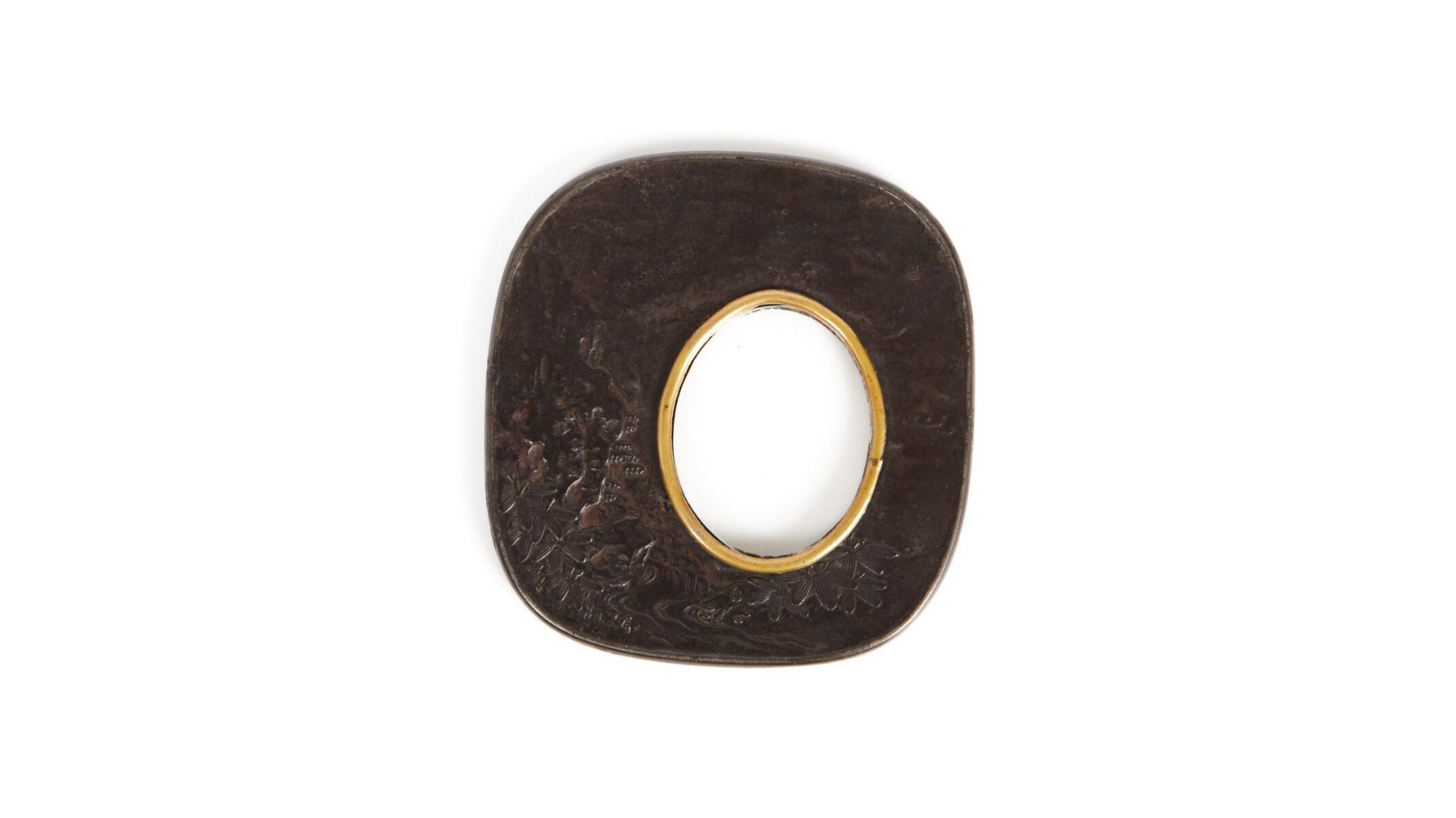

PietroParis Posted June 3, 2021 Author Report Posted June 3, 2021 8 hours ago, Toryu2020 said: Is the other side decorated? If not then I vote for "door handle" as suggested... Yes, the other side is decorated: BTW, this is the link to the auction in the (unlikely!) case that anybody is interested: https://www.drouotonline.com/l/15215803--tsuba-en-bronze-patine-a-deco Quote

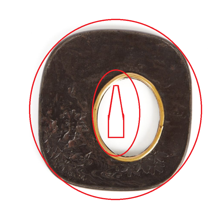

Spartancrest Posted June 3, 2021 Report Posted June 3, 2021 It could have started out as an ordinary tsuba with a flush rather than raised seppa-dai from my experiment with the image - still doesn't explain why it was done? The same auction house has https://www.drouotonline.com/l/15270086-japon-tsuba-bronze---boucle-en The 'bronze' tsuba is a steel bottle opener from the 1960s 1 Quote
PietroParis Posted June 3, 2021 Author Report Posted June 3, 2021 1 hour ago, Spartancrest said: The same auction house has https://www.drouotonline.com/l/15270086-japon-tsuba-bronze---boucle-en The 'bronze' tsuba is a steel bottle opener from the 1960s It's a different auction house - this one in Belgium. "Drouot Digital" is an aggregator site for auctions. Of all the explanations proposed above, "bokken tsuba" seems the least unlikely to me, but what do I know. Quote
Gunome Posted June 3, 2021 Report Posted June 3, 2021 Not for a bokken or naginata, otherwise the hole would have been centered in the "tsuba". 1 Quote

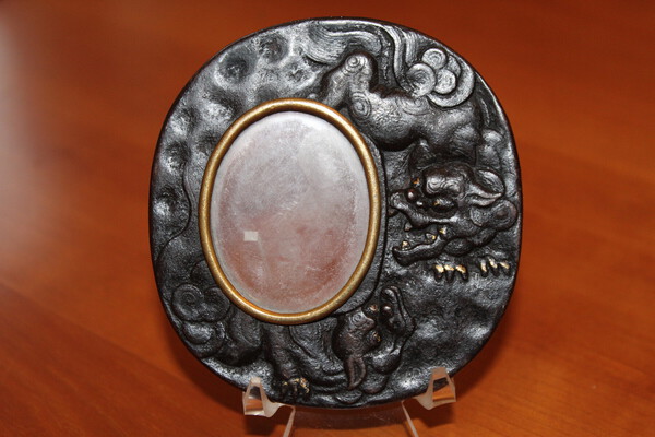

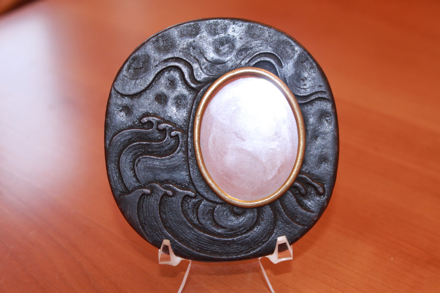

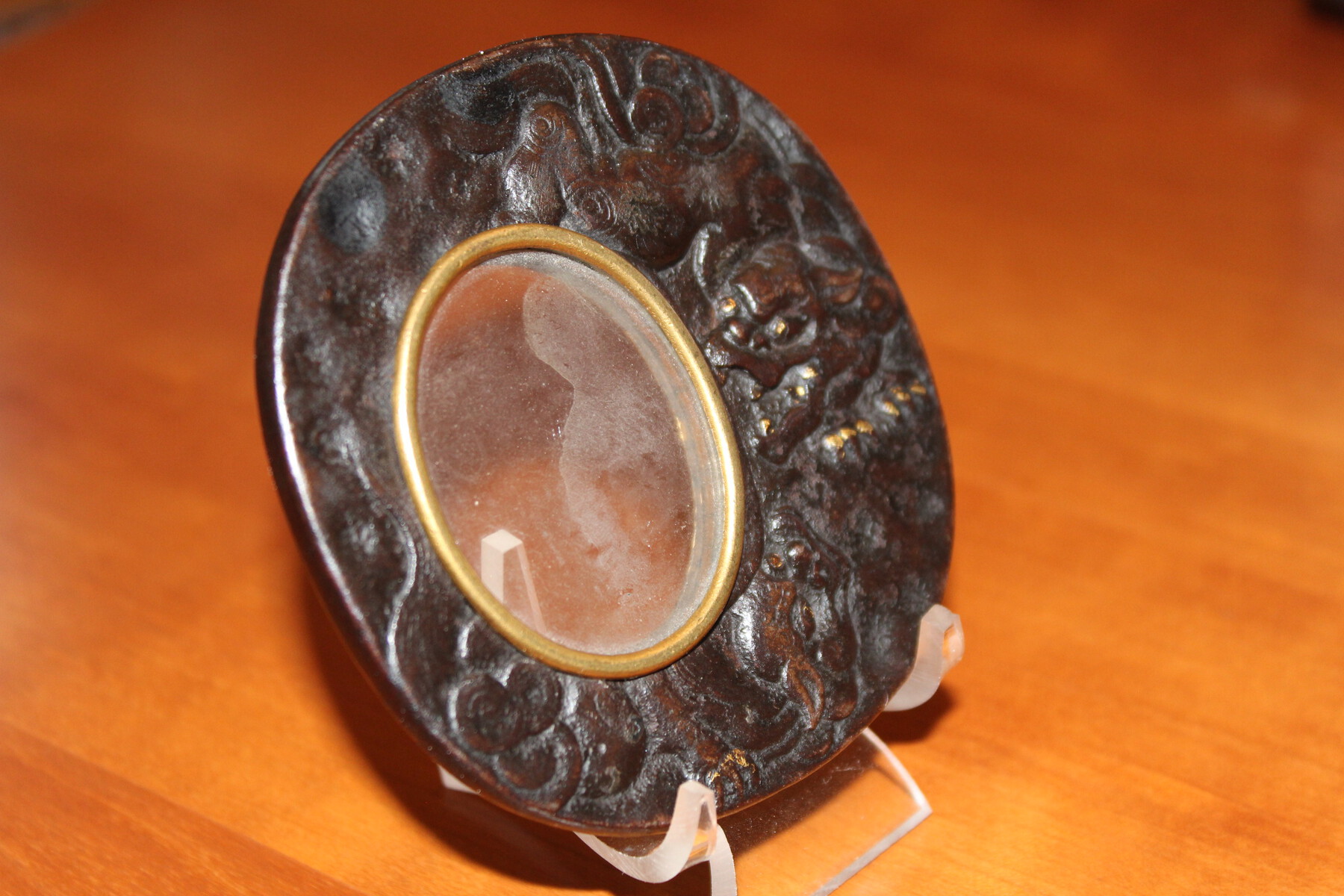

Leporello Posted June 6, 2021 Report Posted June 6, 2021 Dear Pietro, this object is clearly a picture frame that is supposed to give the appearance of being made from a genuine tsuba. I agree with Dale that this piece only looks like a tsuba. The poor workmanship and the lack of seppadai suggest a fake, which was made for the western market to satisfy the hunger for Japanese antiques around the end of the 19th and the beginning of the 20th century (as wonderful described by Geraint!). For comparison here are some pictures of another ´picture frame tsuba´ out of my own collection, which unfortunately was made from a nice Choshu tsuba. Sorry for the bad picture quality. I´ll do better when this one enters the for sale section All the best, Thomas 4 Quote
PietroParis Posted June 7, 2021 Author Report Posted June 7, 2021 OK then, picture frame it is! To be clear, I was asking just out of curiosity, the thought of bidding on it never crossed my mind. Quote
