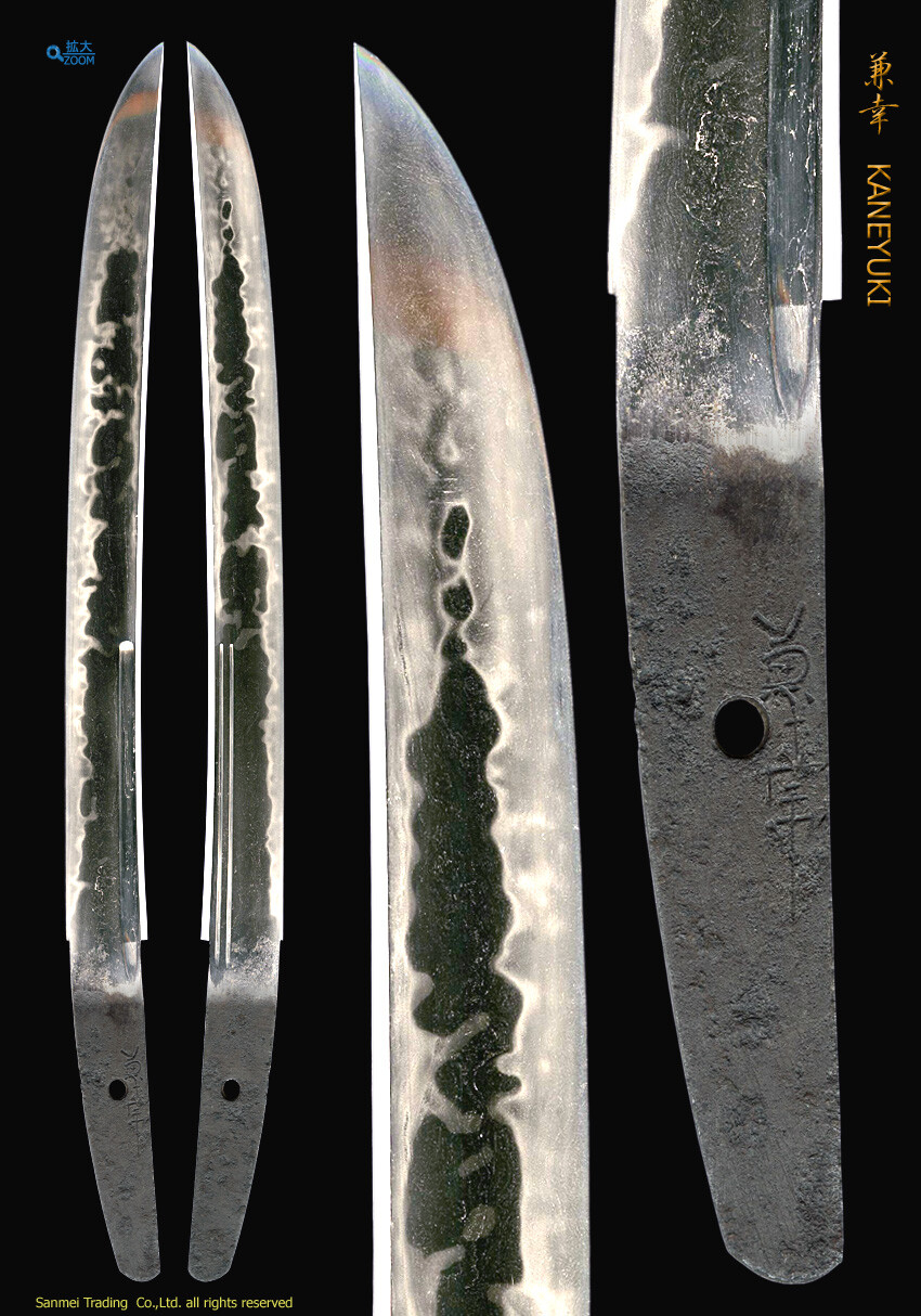

16k Posted November 29, 2020 Report Posted November 29, 2020 I think it was also a fad. It was apparently first developed (officially) by the Soshu tradition and then copied by others. If it had been so bad, I don’t think it would have stuck, especially during the Sengoku Jidai. And unless the first one was indeed a mistake, the others weren’t. Hitatsura creates tobiyaki, but the type of blade you seem to describe isn’t unheard of either. 2 Quote
envocat Posted November 29, 2020 Report Posted November 29, 2020 I could look at that for hours. 1 Quote
