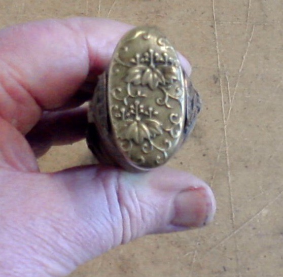

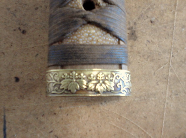

IJASWORDS Posted November 13, 2019 Author Report Posted November 13, 2019 Photos of menuki, no idea what it is. The ashi is a steel band wrapped around the wood saya with a leather protector between the steel and painted wood saya. The ring holder is secured with a bolt and nut. I have other civilian koshirae with the same "add on " ashi. So my guess is an army adaptation of an otherwise civilian sword . 3 Quote

Dave R Posted November 13, 2019 Report Posted November 13, 2019 Photos of menuki, no idea what it is. The ashi is a steel band wrapped around the wood saya with a leather protector between the steel and painted wood saya. The ring holder is secured with a bolt and nut. I have other civilian koshirae with the same "add on " ashi. So my guess is an army adaptation of an otherwise civilian sword . Interesting and germane to another thread. Here we have a koshira with Showa stamped and cast f/k and tsuba, but evidently very nice and old menuki. Quote

Dave R Posted November 19, 2019 Report Posted November 19, 2019 I would really appreciate to see more pictures of civillian mounted swords. Do you mean Showa era civilian, rather than earlier? I have an example I own myself, and pictures of others I don't. Some of them garnered from here. And, here is my own example...... The menuki look to be nice old ones though. 3 Quote
IJASWORDS Posted November 19, 2019 Author Report Posted November 19, 2019 Hi Dave , I have the same menuki on full military mounts. It is a dragon wrapped around a ken, which I believe has some religious significance . 4 Quote
David Flynn Posted November 19, 2019 Report Posted November 19, 2019 The Dragon stands for wisdom and the Ken is the blade that cuts through ignorance. 3 Quote
