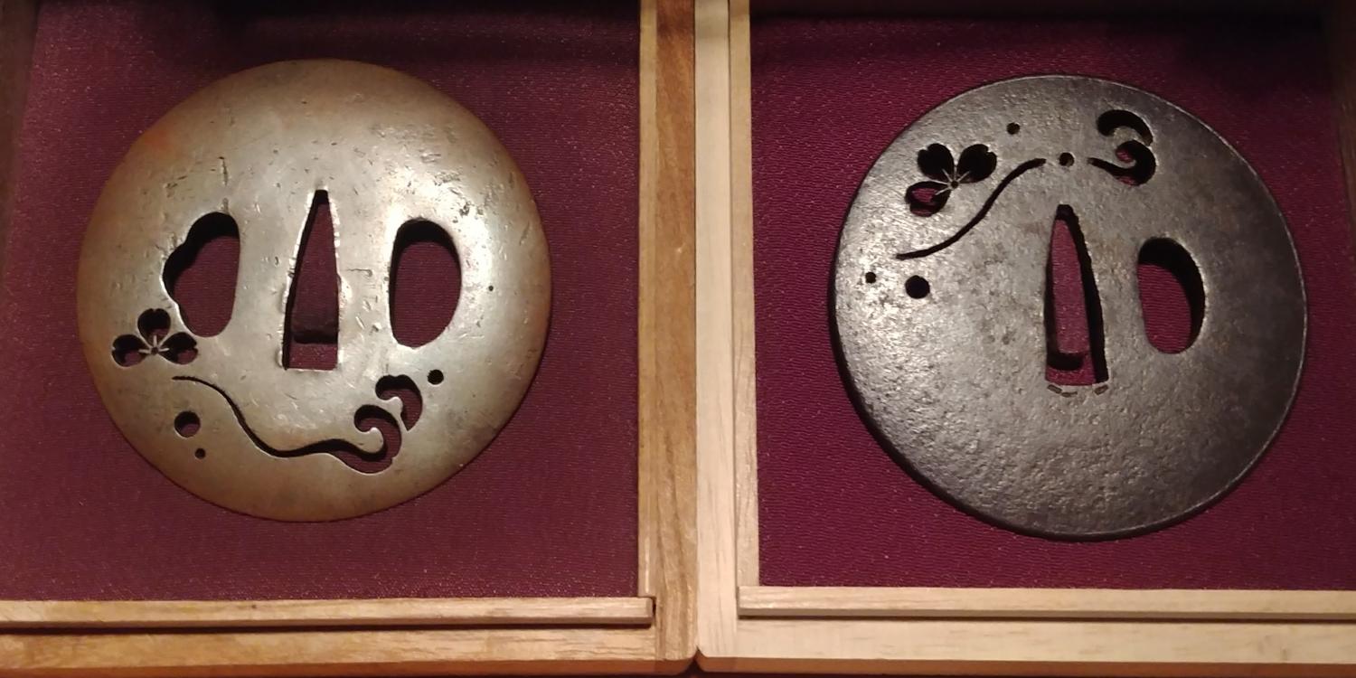

The tsuba arrived also
Iron chrysanthemum with inome sukashi...Shoami?
And so this project came to an end. :)
Robin
  • Like 4
The copper tsuba can enjoy it's retirement in peace now. :laughing:
It looked nice, but a bit out of place and a perfect round tsuba isn't the most practical.
I think the "new" iron tsuba looks much nicer, has a practical shape and...for balance...the right weight.
Robin :)

The original tsuba that came with the iaito, was 90 grams...the balance was too much tip heavy to my liking. This made it hard to stop a cut and this put a nasty strain on my muscles.
The copper one is a whopping 165 grams. Balance more towards the tsuka...despite the extra weight much easier to handle, but a tad bit heavy.
The iron tsuba is 145 grams...this should be just fine for me.
Robin  :)
