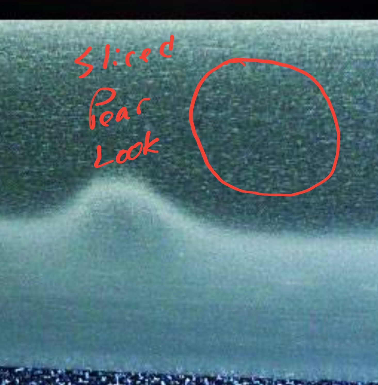

Hamfish, I checked all my '41s and agree - their nakago remain pretty uniform in width, without taper or much taper. Also, the Mantetsu nakago mune began as flat, like other blades, but in '40 they began rounding them, not all but a mix. By '41, all Mantetsu mune were rounded, EXCEPT those specifically made for Rinji (type 3) mounts, which were flat. Both these wavy blades are '41s and are flat, but in Type 98 mounts. That would lean toward fakery, but not proof alone, as a custom blade could be made any way the smith desired obviously.
On the other hand, the "skin" of this blades does have the look of a polished Mantetsu. When I had mine polished, the polisher called the look "sliced pear", which this one has.

that hada is nashiji hada, and i have seen a few showato with it.
off the top of my head i sold a custom navy gunto on the NMB by kojima kanemich, a nagamura kiyonobu with this type of hada. all non traditionals
also about the oil quenching removing hada?? i havnt heard that before.
Oil quenching is only favourable in that it is less stressful and had fewer failures, Desirable for fast wartime production where quantity was paramount and hardness of the ha was a less critical consideration. Because oil has such a low transfer of heat compared to water less nie are produced and this is apparent in the hamon being weak and less attractive. The grain produced by folding and forging should not be affected by the type of quench. Most modern heat treatment of non-Japanese swords are oil quenched and you can see many examples of well defined grain structure. John
