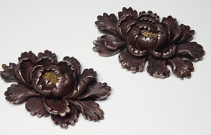

Menuki are not exactly my cup of tea (meaning that I do not know nothing about tosogu, and or menuki even less) but nonetheless I bid for these menuki on yahoo Japan out of a impulse.
I was not really expecting to win the auction though they look nice to mount on a project of mine.
They seems to be made of silver whose black patina in the recesses highlight nicely the recessed regions of the peonies.
Looking at the mei it seems to read as Katsura Eiju (桂永寿) but I think they are gimei, given that I win the action with a relatively low bid.
I would like to hear some comment from the collector more experienced in menuki than I am.

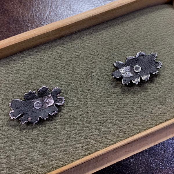

I can see why you liked them but I don't think you need to worry about mounting them.  The tanzaku mei should be engraved on separate thin metal plates that are held in place by a tiny metal stitch.  I fear that on yours they are cast in one piece with the post.  I would love to be wrong.  Have a look here,   https://www.aoijapan.com/menuki-tanzaku-signature-tsuchiya/    Note the right hand menuki, back view.

Geraint - I'm afraid I have to disagree with your appraisal.  On magnification the tanzaku are separate and (poorly) placed by a punch hole around the posts.
I checked Wakayama and see little resemblance to what is presented there so probably gimei.

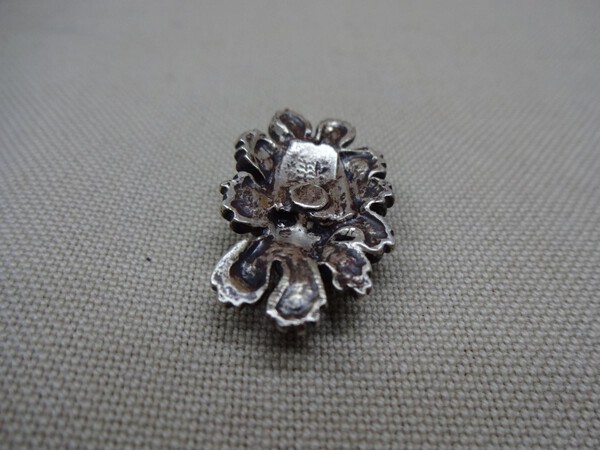

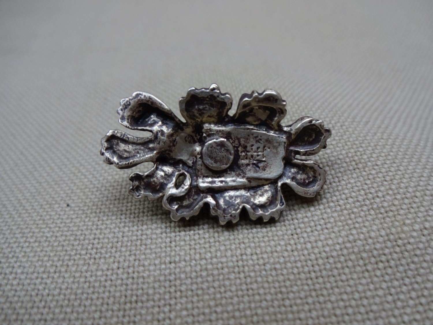

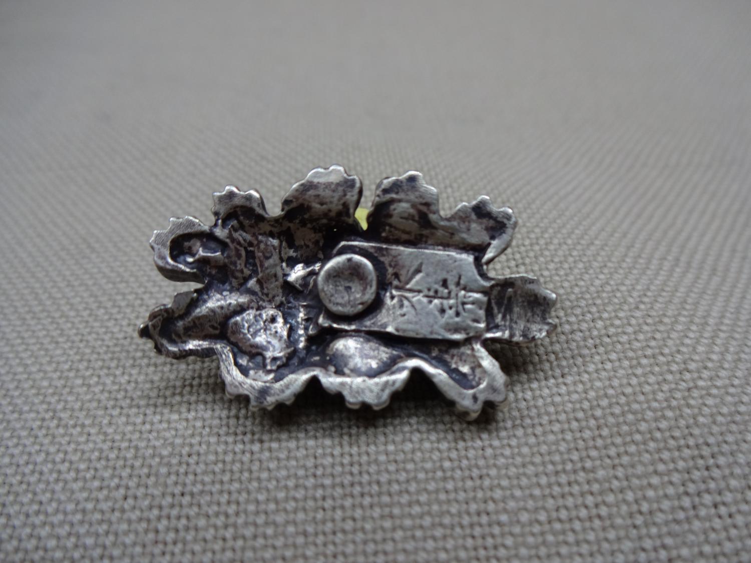

After some time I was able to clean them up.
Boiling water softened up the stuff on the back and I was able to removed it with a toothpick. After that I let them soak for a week in nitro thinner and the brushed them.
Sorry for the quality of the pictures I had a little time to take them, however they show the main features of what was under the stuff on the back.
To me it look like casting but menuki are not my piece of cake. What is your opinion?
Regards
Luca
P.S. The front of the menuki was not affected at all by the cleaning process.
Why you do that Luca? Now you can throw them in a liter box.
That was fine looking menuki good for mounting.  :dunno:
In my opinion this was a good learning experience. These are modern cast fakes. Now that the fake instant patina and very suspicious pitch from the back has been removed the truth is glaringly evident.

The advice of Steven made perfect sense since to determine the nature of the menuki (real or reproduction) was needed before further analysis.
Following the advice of Steven I have removed the stuff on back to see how the menuki was made. The tanzaku-mei is integral with the rest of the menuki. It is most probably a wax casting copy as said by Tom.

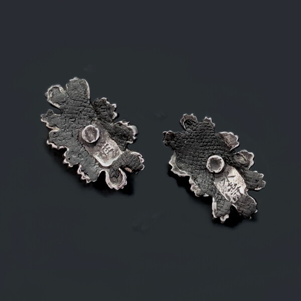

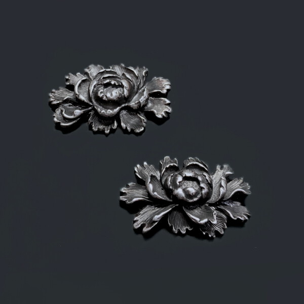

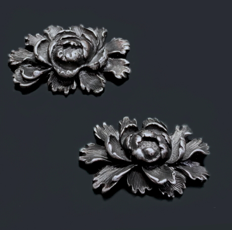

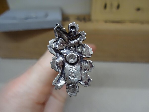

I've found the originals that Luca's forgeries were probably made from.  See below (study them closely - they are turned differently, but they are exactly the same).  I've described the process of vulcanized rubber mold copying and lost wax casting of modern copies here before (see lost wax entries below the sand casting entries).
Interestingly, in this case the forger used a different signature on the back (easy to change in the wax state).
Original:
Luca's Copy:
Original Back:
Luca's Copy Back:
The seller of the original is samurai77ki on Yahoo Japan.  Brian already did the detective work in discovering the jeweler making and selling the forgeries, but he would have had these originals to make his rubber molds.
