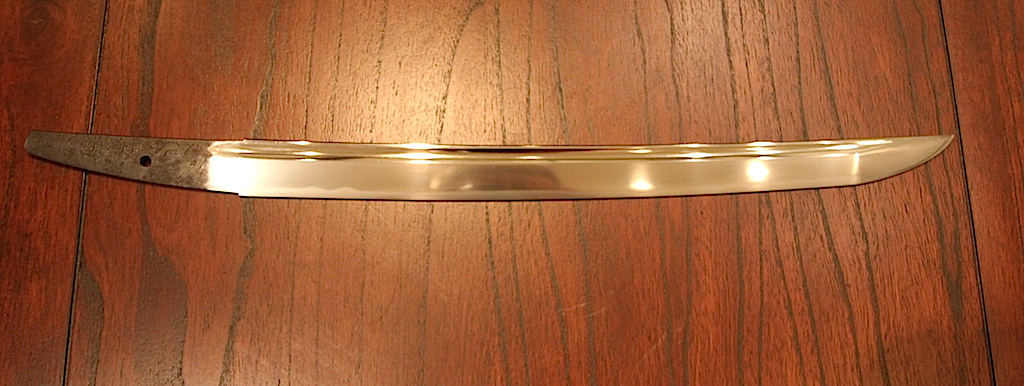

Nice blade, Chris! Got that "meaty" Satsuma
look to it. These guys didn't play around when
it came to heavy swords.
I will take some pictures of my wakizashi later on.
Got some really interesting features.
Thanks for the picture, Chris!

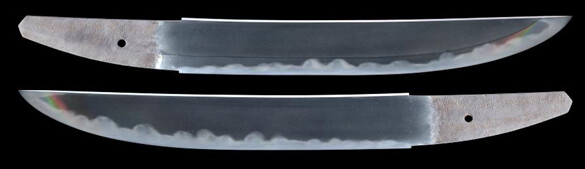

Thomas; I don´t feel I´m the right person to argue with Mr Fukunaga, but Kyoho 18 seems a bit strange considering that Motoyasu should be the youngest of the three :dunno:
1753 perhaps... :D
Peter; nice sword. Have all the traits you look for in a Satsuma sword.
The sword is made by Motoyasu but I can´t translate the "...Oku Motohira meishite korewo zozu" part of the mei. Is that some kind of memorial inscription. Cos 183 years ago would be 1831 and Motohira died a few years earlier...

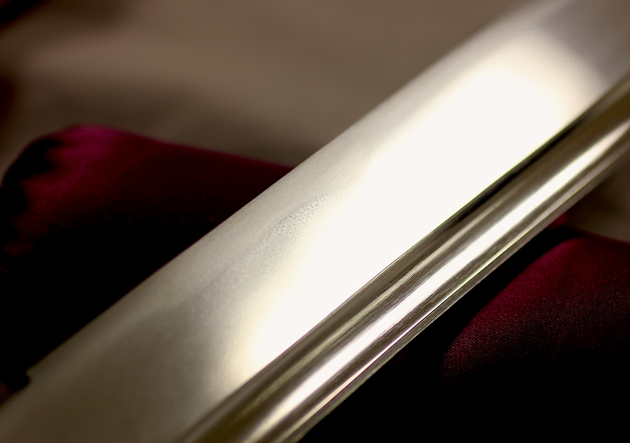

Here´s finally some pictures of my Motoyasu wakizashi. It´s a really heavy meat cleaver. A true Satsuma sword made for battle.
Total length about 53 cm and it´s over 3 cm wide.
A gentle sugata. The jihada is very subtle with nie along the entire hamon. Not so easy to catch with my camera.
Along most of the blade runs a crisp hi. Finishing off with a Nanbokucho style o-kissaki.

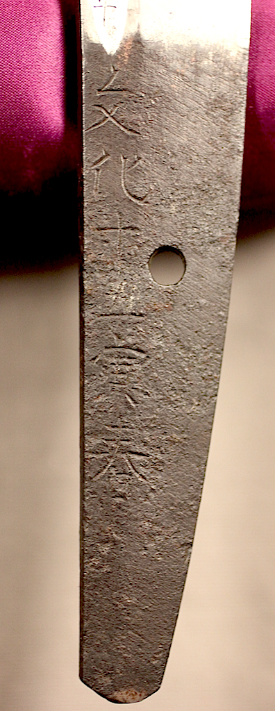

Signed and dated, comes with Hozon-papers. In near perfect condition apart from the nagako, which seen better days.

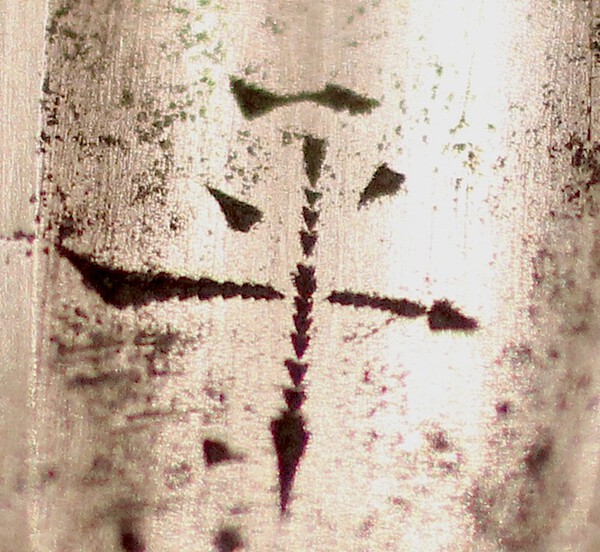

But now it gets interesting. And why wouldn´t it with a Oku-family nihonto :) Imagine my surprise the first time I removed the habaki.
On both sides is a small kanji ingraved in the middle of the hi. Never seen this before in any Japanese swords.
The kanji is close to the "hira" in Motohira. Placed smack in the middle of the hi.
Could this, a longshot I know, mean that Motohira (1 generation or perhaps a later edition) helped with the hi. Modest as the only the Japanese
can be, he signed it and hid it under the habaki, not to take any cred from Motoyasu?
I open the floor for suggestions.

Jan,
That area is usually reserved for a polishers mark or signature. But it is usually burnished in, and not cut.
However, I do not think it alludes to any smith name helping with the forging. That is a bit far fetched.
Brian

Brian; I´m sure you are right about this and I´m out on a wild goose chase :D I´ve also heard about the polishers mark but never seen one before.
But you have to agree that the kanji is very similar to the one done by Motohira.
Managed to take a real closeup of the kanji and under the habaki and I also include the end kanji from a Motohira mei.
