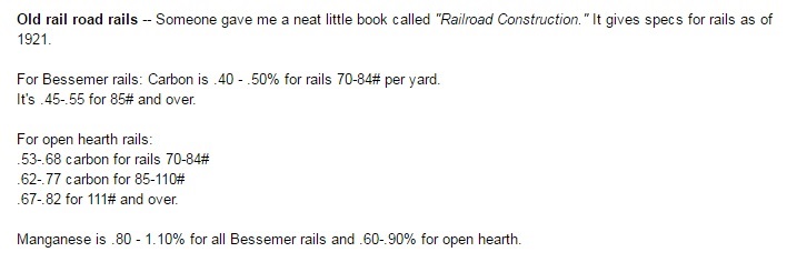

 Once upon a time Mantetsu blades were thought to be the ones made of obsolete rail-track, but I think that theory is now debunked.... Though such swords are on record as made at Seki and in occupied Beijing.
Hamfish. I got very interested in the railway track story, and did some digging. The trouble is it seems to get contentious very quickly when they are mentioned, and discussion rapidly descends into argument. I am in fact looking for  such  a blade to collect, but I want it documented or otherwise confirmed. They would be one hell of a cutter.
Morning Dave, over the years I have found that these type of low production, almost experimental methods of making swords in the early times didn't get much respect or documentation,
all I could find is small snippets of info, that have been translated. the book I mention above is the only published reliable information.
I wish you luck with your research, I have no time now due to family commitments
if you get really ambitious, theres is a very rare "combination sword" made about the time of the russo war.
its a cross of a dress sword but with a real blade inside, how or what is made from I never found out.
regards H
I also heard that a Koa Isshin Mantetsu Saku made in 1943 incorporated some degree of "foreign steel"  likely from Sweden. Whereas a Mantetsu Kitae Tsukuru Kore made in 1943 was made with 100% Manchurian steel.  Looking forward to any comments on this. Thank you
Hi Dave,
Regarding using rail tracks for making Mantetsu, from my sources, you are completely correct. The Japanese never used rail tracks to make blades.
The Japanese did do sample tests on the purity of the tracks, and realized it's superior qualities compared to tamahagane.
Makes sense when you think about it. Why would the Japanese Imperial Army tear up rail tracks when they needed the rail lines to expand their control over the region.
I think the confusion comes from the term "Railway Steel" which has been used and misinterpreted over the years to be railway tracks. I know in the early days of Paul Chen swords they used this railway steel and most people thought it was literally old railway tracks.
Manchurian railway whispers if you will!
