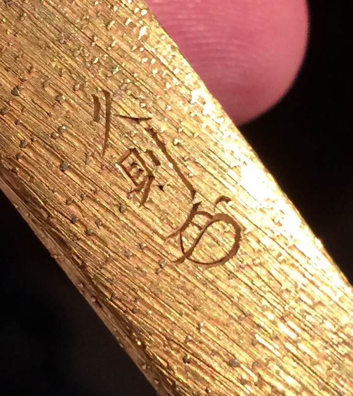

Darcy Posted November 2, 2014 Report Posted November 2, 2014 I picked up a futatokoromono with no papers at the DTI based on "just liking them"... signature is Hisanori on the back. The style seems to be related to Omori and I have two candidates for Hisanori. Either Chizuka Hisanori or Mito Hisanori. I had read that Mito Hisanori was a daimyo and made these as a hobby essentially training under Teruhide. Chizuka Hisanori I don't know anything about but seems to be high level. I don't have any examples of the Mito guy but the signature is close enough to the first that it just may be a gimei. Or maybe OK. Most of it looks pretty right and the kao seems to be the kao of Chizuka Hisanori. What I don't like is that in the one example I could find from Mike Y's site that has Hozon papers, the two horizontals in the Nori meet up with the right vertical in the left radical but clearly do not here. If you were copying a signature though that seems to be one you would copy correctly and the rest of it is close enough that it is not drawn out of thin air. So, don't know what to think about it. I have a guarantee of Hozon. Just the mei for now as I'm too tired to take a reasonable photo. Quote
Stephen Posted November 2, 2014 Report Posted November 2, 2014 Please share the set when you have time. Quote

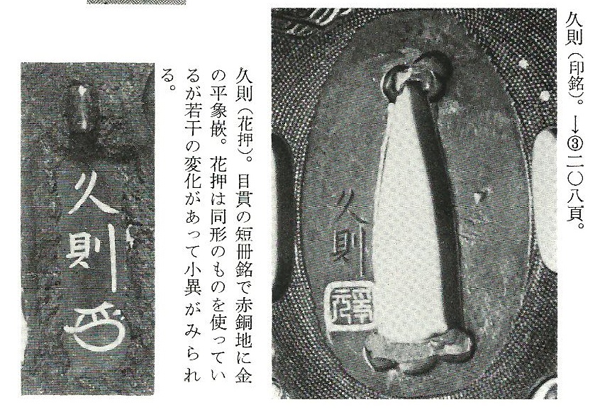

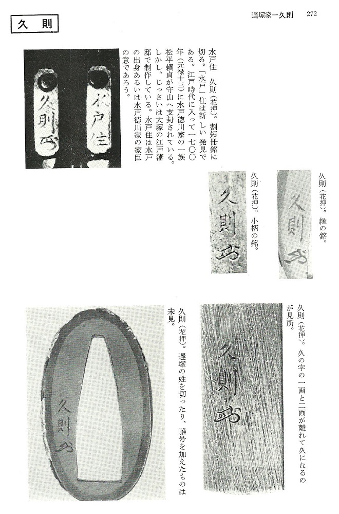

Pete Klein Posted November 2, 2014 Report Posted November 2, 2014 From Shinsen Kinko Meikan, Kokubo Kenichi, page 307: From Toso Kodogu Meiji Taikei, Wakayama, volume I, page 271 and 272: I believe this is Chizuka Hisanori, Haynes 01508, student of Omori Teruhide. Quote
Brian Posted November 2, 2014 Report Posted November 2, 2014 From Pete's example, I would say it is good. Markus' book also shows some examples, showing there are some variations in his mei. Brian Quote
Darcy Posted November 2, 2014 Author Report Posted November 2, 2014 Wow, Pete, very impressed. Just had a sleep and woke up to that pile of great news. Mine is right in the middle I think of all of that. Sure feel good about it now. I will do some photos when the sun comes up and share the rest of the work. Mike Y's set of menuki was a bit unlike these above in small parts of the mei and I just assumed those were standard things. So bottle of Scotch to you Pete is coming. Quote
