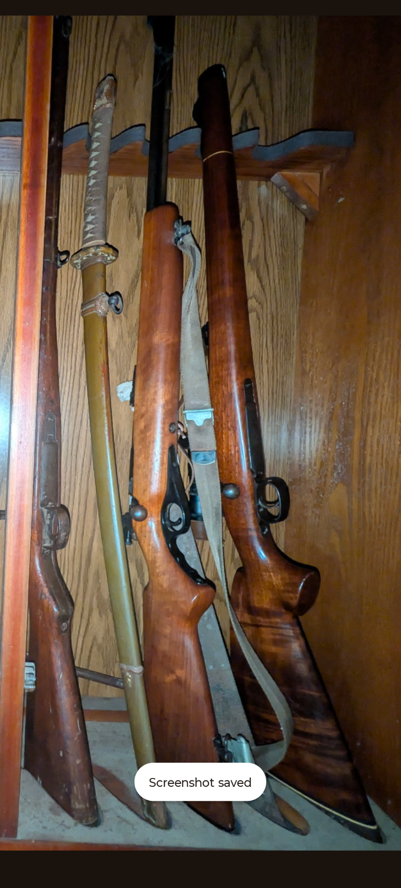

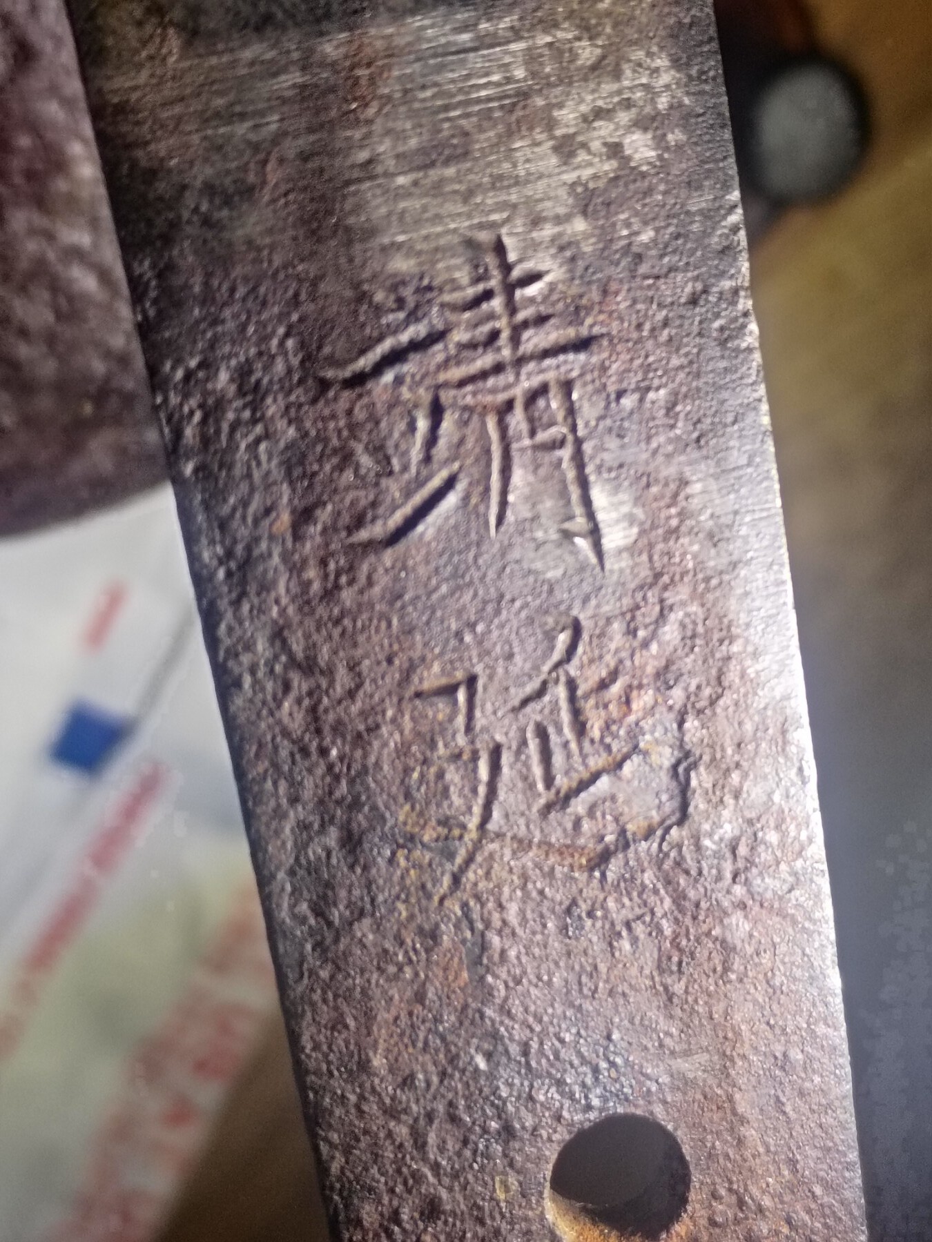

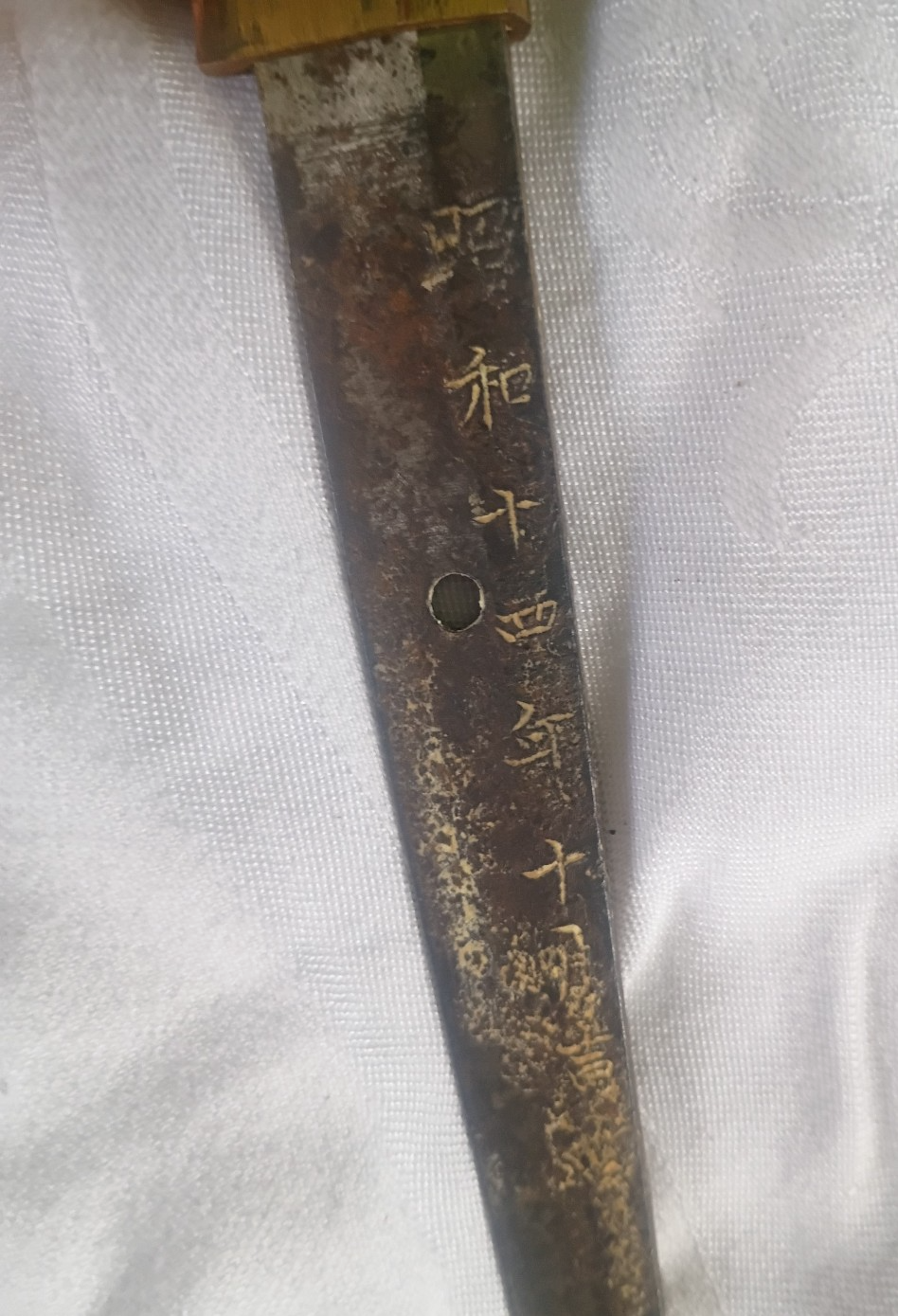

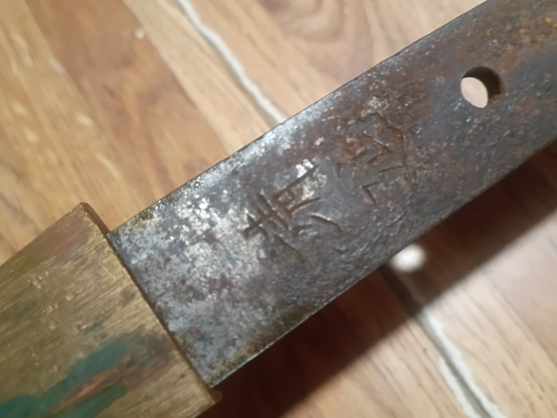

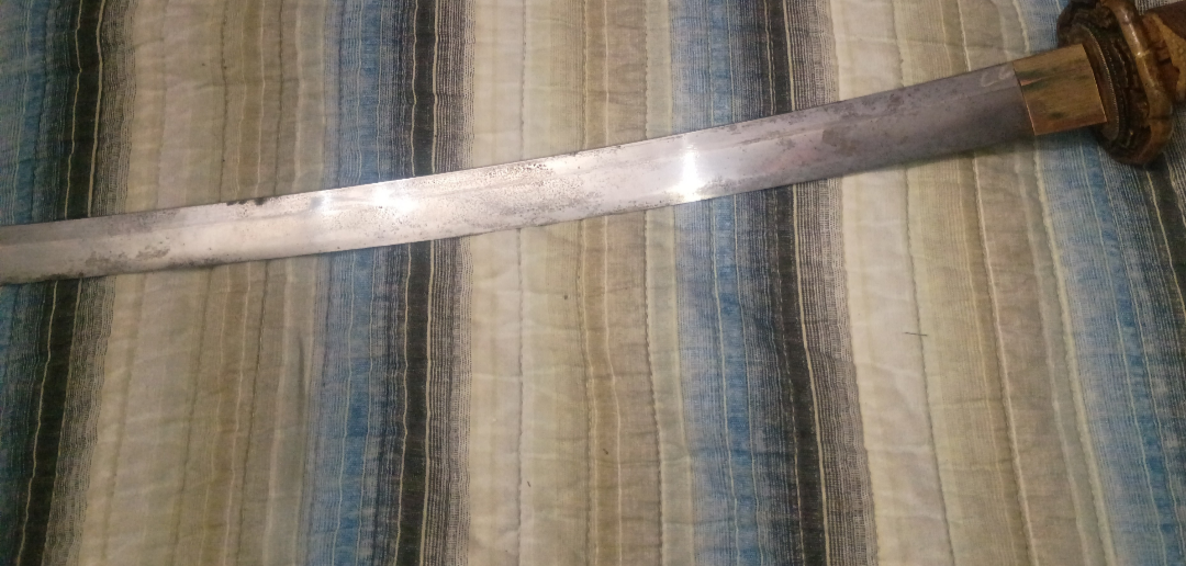

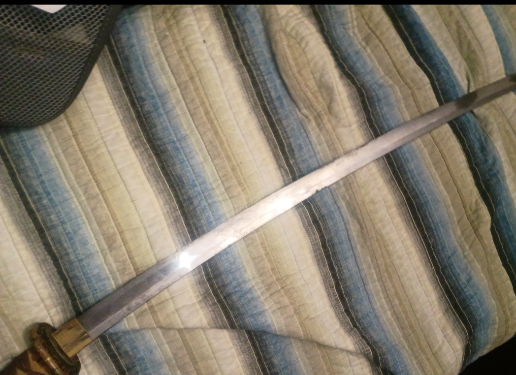

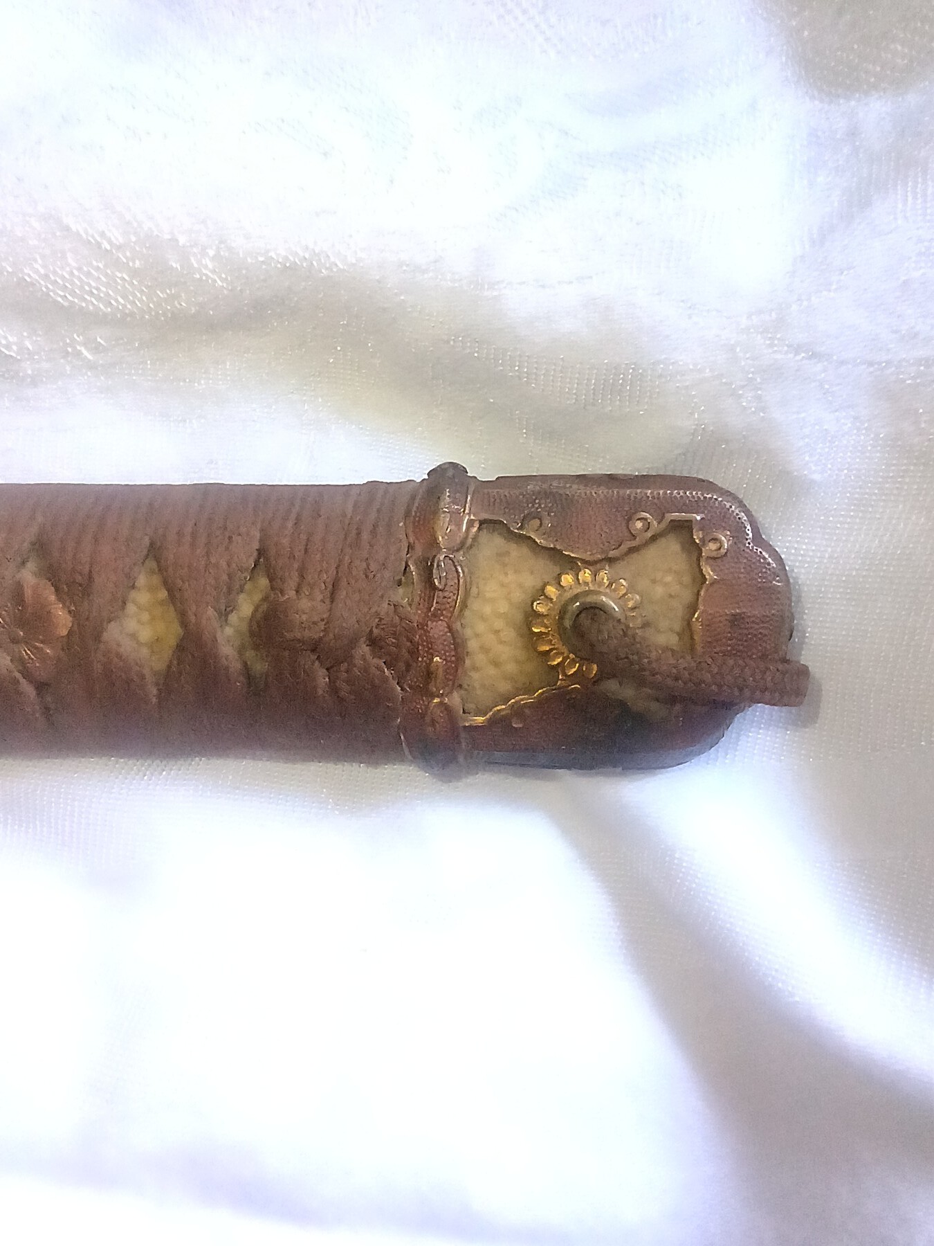

tumbleweed5780 Posted August 23 Report Posted August 23 I found the store last week and my grandparents' basement cleaning up things after the passed away and I knew my grandpa participated in world war II but I don't ever think you went overseas but he had a bunch of Japanese equipment and stuff. Not quite sure if I should clean it off a little bit so I can read this the signatures in the descriptions better or just leave it how it is but it's very old and it looks like it was used by the chips in the blade. Quote

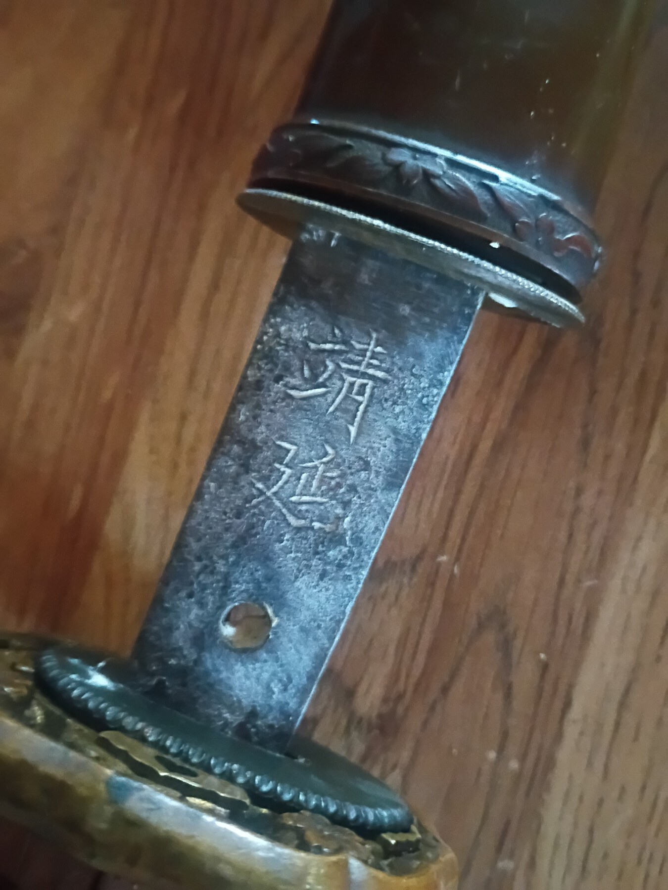

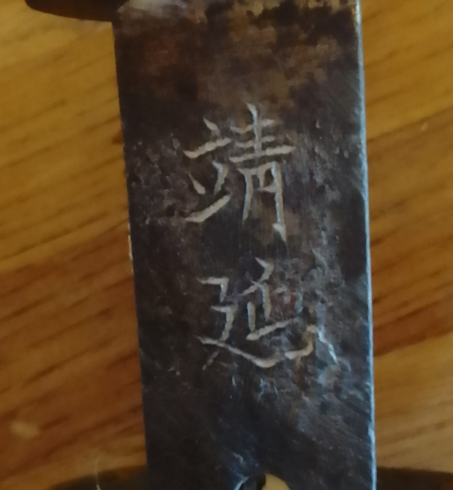

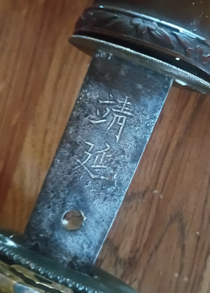

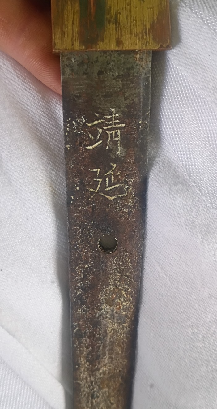

Ray Singer Posted August 23 Report Posted August 23 Very nice find, this is a sword by the Yasukuni shrine smith Yasunobu. The blade is dated 1939 (Showa 14). https://www.google.com/search?q=Yasukuni+Yasunobu+site%3Awww.militaria.co.za&oq=Yasukuni+Yasunobu+site%3Awww.militaria.co.za+&gs_lcrp=EgZjaHJvbWUyBggAEEUYOdIBCTEwNDExajBqNKgCAbACAQ&client=ms-android-google&sourceid=chrome-mobile&source=chrome.ob&ie=UTF-8 5 1 Quote

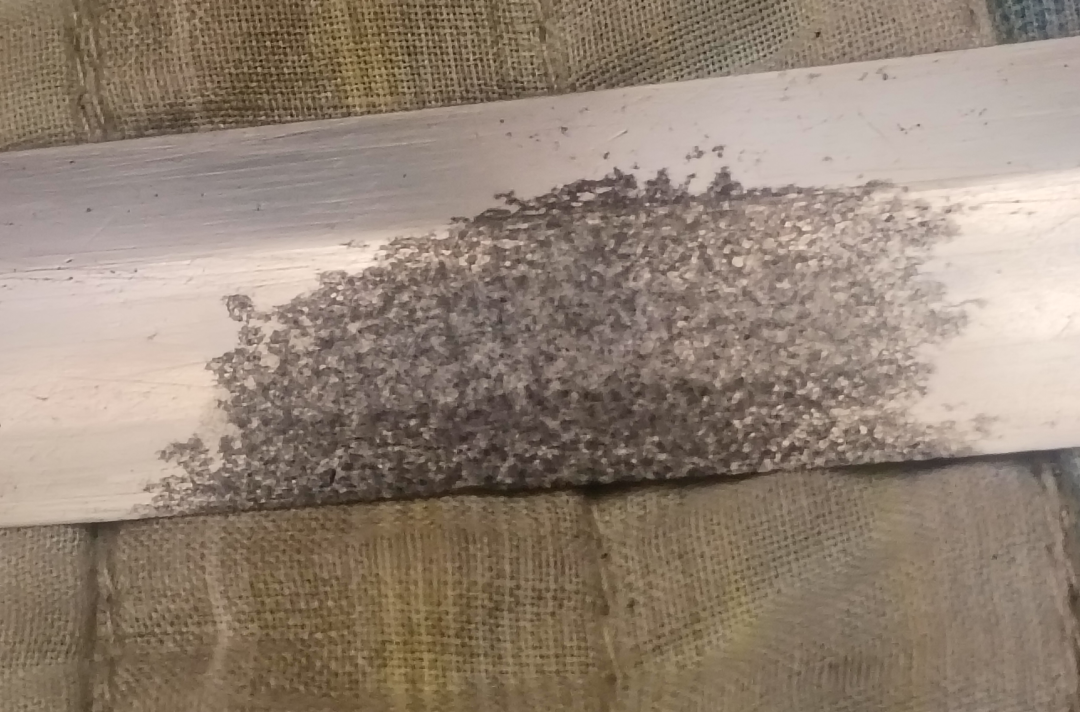

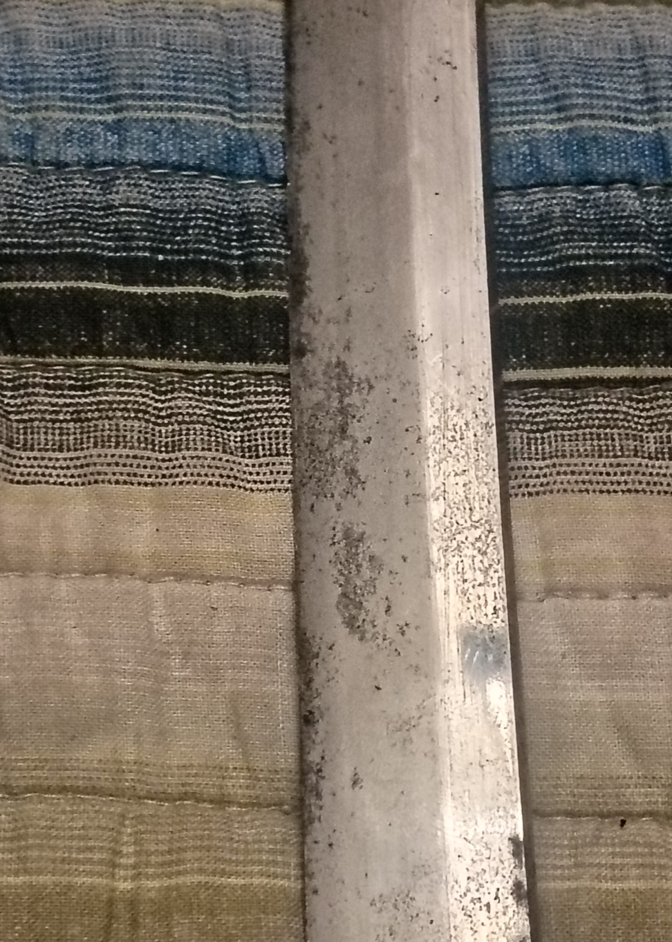

Ray Singer Posted August 23 Report Posted August 23 Please absolutely do not do anything on your own to clean the blade or remove rust. 3 1 Quote
Grey Doffin Posted August 24 Report Posted August 24 Hi Charles, Look here for care and handling: https://nbthk-ab2.org/sword-characteristics/ You should read it. I notice you're in Minnesota. I'm in Duluth and am available to answer all sort of questions. Cheers, Grey 3 1 Quote
Brian Posted August 24 Report Posted August 24 Kinda a significant find. One of the better of the WW2 swords and has some decent value. Follow the advise above, and don't clean anything except careful oiling of the blade. You have a few thousand $'s there, so time to sit back and take things slowly. 4 1 Quote

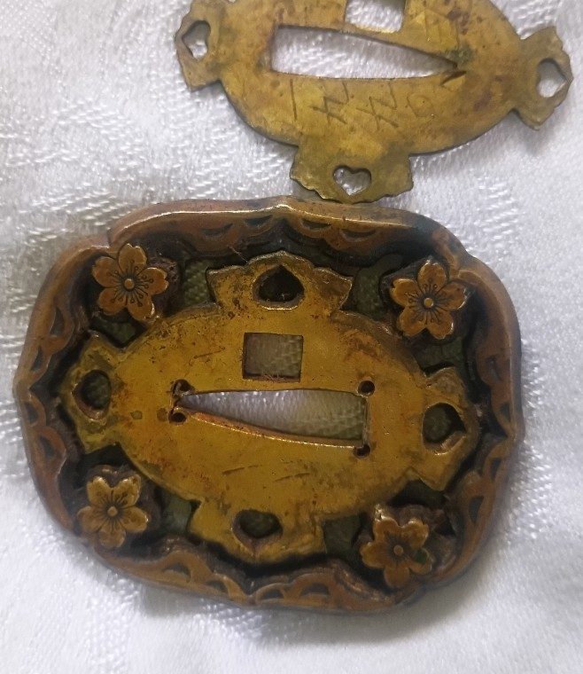

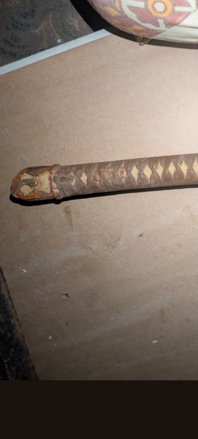

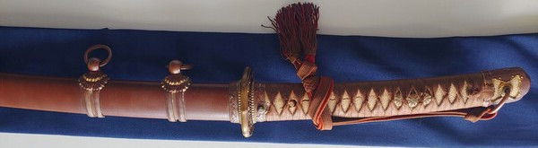

Bruce Pennington Posted Monday at 03:05 PM Report Posted Monday at 03:05 PM Hi Charles, The fittings are the Japanese Army officer gunto Type 94 or 98. If you show a shot of the top half of the rig, showing the side with the latch, we might be able to give you an idea of which version it is. Otherwise, you can learn about this sword style on Ohmura's site: Commissioned Officers Gunto - Type 98. 1 1 Quote

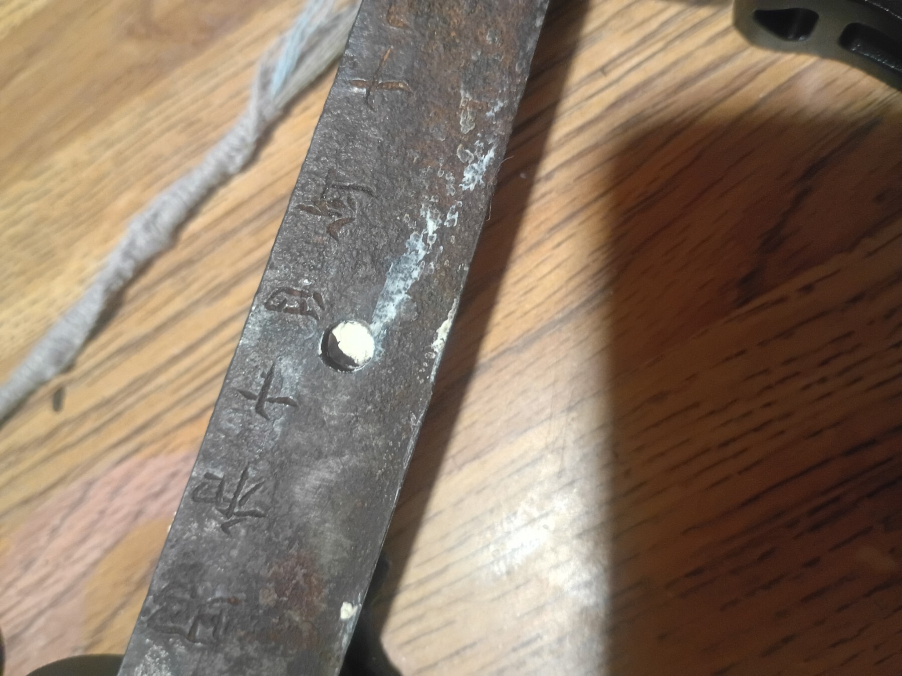

Ray Singer Posted Tuesday at 12:04 PM Report Posted Tuesday at 12:04 PM You have shown the date side more clearly here and in the correct orientation. The full date inscription is: an auspicious day in October, 1939. Best regards, Ray 1 Quote

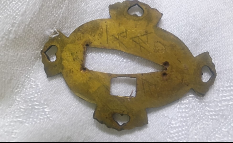

Bruce Pennington Posted Tuesday at 03:59 PM Report Posted Tuesday at 03:59 PM Thanks Charles, I can see the release button is centered, like a Type 94. I was hoping for a photo more like this: Yours only has one haikan (belt hanger) but the second one was removable, and most often were. If you have a caliper, you could measure the thickness of the edge of the tsuba (handguard). The 94s had a thicker tsuba, 11mm I think? 1 Quote
