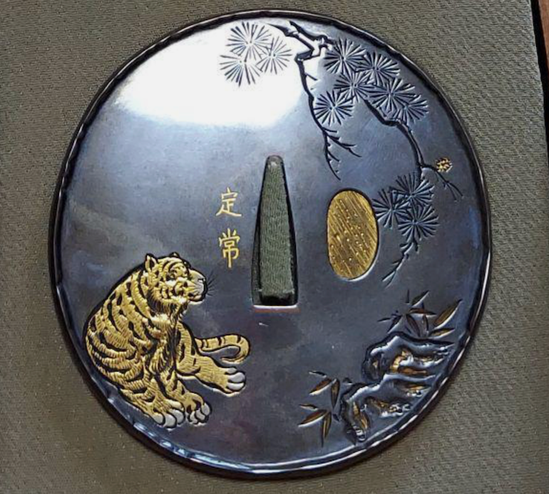

John C Posted December 14 Report Posted December 14 The details/quality of this silver tusba don't seem to warrant the use of precious metals to me. I'm probably missing something. Opinions? https://www.ebay.com/itm/126480417057? John C. Quote
Bazza Posted December 14 Report Posted December 14 ?Modern fake? There's just 'something' about it.. BaZZa. 5 Quote
Spartancrest Posted December 14 Report Posted December 14 If you want a real Silver tsuba it will have hallmarks on it https://www.jauce.com/auction/o1211899326 3 Quote
eternal_newbie Posted December 14 Report Posted December 14 1 hour ago, Bazza said: Modern fake? There's just 'something' about it.. Or made solely for foreigners to buy in a souvenir shop. 1 Quote
Exclus1ve Posted December 14 Report Posted December 14 1 hour ago, eternal_newbie said: Or made solely for foreigners to buy in a souvenir shop. Most of all it seems to be true. These are not the lowest quality items, but the carving is quite simple, there is no inlay, just painted. https://www.bonhams.com/auction/15678/lot/291/a-large-shibuichi-tsuba-after-unno-shomin-meiji-period/ 2 Quote
Matsunoki Posted December 14 Report Posted December 14 Horrible! Somehow lacks the refinement of quality found in Bakumatsu and Meiji pieces Personally I’m thinking they are much more recent and intended to deceive. Quote
Hokke Posted December 14 Report Posted December 14 I wouldn't go so far as to say it is horrible, although I don't know to which Colin was referring, but I would say simply not representative of what can be achieved when made traditionally. That said, $2600 for 8oz of silver in this configuration is....optimistic, to say the least. Still potential for a good bit of work there, I dont see any obvious signs of casting, but the pictures arent great either. Has anyone taken a crack at the hakogaki? 1 Quote
Matsunoki Posted December 14 Report Posted December 14 12 minutes ago, Hokke said: although I don't know to which Colin was referring, Sorry….the original tsuba, the subject of this topic. Look at things like the tigers’ feet. Also I haven’t checked the actual description but the tiger looks cut into the plate rather than inlaid. It has no finesse or subtlety The one Victor shows is better. Quote
Exclus1ve Posted December 14 Report Posted December 14 1 hour ago, Hokke said: That said, $2600 for 8oz of silver in this configuration is....optimistic, to say the least. I think it's just an alloy with a low silver content. However, we do not evaluate tosogu based on the content of precious metals. 54 minutes ago, Matsunoki said: It has no finesse or subtlety The one Victor shows is better. Do you really think so? Because the inexperienced person who bought this tsuba turned out to be my countryman, I will share live photos of this tsuba. This tsuba was definitely made by hand, there is carving, but there is no refinement, small details are blurred. Just a good souvenir for an inexperienced tourist, but not for that kind of money… I think these are original Meiji or Showa items, but they were made without attention to detail and original technologies. The tourist will buy, and this is proof of that! In general, I think there is no deception in high-quality tosogu, everything is visible here if you know where and what to look at. I think it would not be superfluous to recall: Quote
Matsunoki Posted December 14 Report Posted December 14 1 hour ago, Exclus1ve said: Do you really think so? Actually looking again…..no. How about this one on bay…..it is dated 2001.….same shape nakago ana. Same artist? These are all modern imo 1 Quote
Exclus1ve Posted December 14 Report Posted December 14 45 minutes ago, Matsunoki said: How about this one on bay…..it is dated 2001.….same shape nakago ana. Same artist? These are all modern imo Maybe modern, I agree, Colin. Your example is even better than the previous ones, but there is still something missing...sophistication... I think this is the fate of many modern artists, few people will be able to find the meaning to spend their whole lives on this craft in order to achieve perfection. 1 Quote
Matsunoki Posted December 14 Report Posted December 14 6 minutes ago, Exclus1ve said: Maybe modern, I agree, Colin. Your example is even better than the previous ones, but there is still something missing...sophistication... I think this is the fate of many modern artists, few people will be able to find the meaning to spend their whole lives on this craft in order to achieve perfection. I agree totally Victor. The deer tsuba above looks lovely at first glance but closer examination shows that the meticulous detail and subtlety is not there. It is a bit stiff and wooden. However, this deer piece is still an attractive tsuba and maybe the artist will continue on his journey. But the extra detail is what takes 10 times longer to achieve. It’s the best modern one I’ve seen except for Fords’ work. Quote

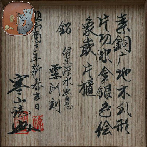

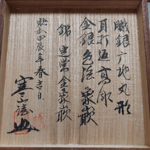

MauroP Posted December 15 Report Posted December 15 The hakogaki is well written and states some perfectly legitimate assumptions about the tsuba. Unfortunately (or rather, thank God), it is not by the Satō Kanzan. Below are others hakogaki, likely written by the same “pseudo-Kanzan,” concerning modern tsuba. 2 Quote
Dan tsuba Posted December 15 Report Posted December 15 Hello Mauro, Thanks for the hakogaki pictures and your statement of “The hakogaki is well written and states some perfectly legitimate assumptions about the tsuba. Unfortunately (or rather, thank God), it is not by the Satō Kanzan. Below are others hakogaki, likely written by the same “pseudo-Kanzan,” concerning modern tsuba.” Unfortunately (as much as I have tried!) I can’t read Japanese. Why is everything written about tsuba in Japan always written in Japanese? Ha, ha, ha, ha, etc! Just having a bit of fun! Anyway, I don’t know enough about computer translation to translate the hakogaki. If someone out there can translate them, I think that would be of interest to many members that read this thread. Thanks! 1 Quote
MauroP Posted December 15 Report Posted December 15 24 minutes ago, Dan tsuba said: If someone out there can translate them, I think that would be of interest to many members that read this thread. Thanks! Dan, stay tuned! https://www.militaria.co.za/nmb/topic/53919-tsuba-hakogaki-written-by-satō-kanzan/ 2 Quote

MauroP Posted December 16 Report Posted December 16 1 hour ago, Matsunoki said: I am really interested to see what the inscriptions on the boxes say, that might shed some light on them. Know what you buy! 鐔 寒山拾得図 * tsuba Kanzan Jittoku zu 朧銀銅广地丸形 * oborogin migaki-ji maru-gata 耳打返高彫 * mimi uchikaeshi takabori 金銀色絵象嵌 * kin gin iroe zōgan 銘定常金象嵌 * mei Sadatsune kin-zōgan 昭和甲辰年春吉日 * Shōwa kinoe-tatsu-nen haru kichijitsu [1964, spring, an auspicious day] 寒山誌 * Kanzan shirusu 5 Quote
Dan tsuba Posted December 16 Report Posted December 16 Thanks Mauro, I may have finally found out how to use Google translate (yes, you can teach an old dog new tricks!). So here is your translation shown above- 鐔 寒山拾得図 * tsuba Kanzan Jittoku zu 朧銀銅广地丸形 * oborogin migaki-ji maru-gata 耳打返高彫 * mimi uchikaeshi takabori 金銀色絵象嵌 * kin gin iroe zōgan 銘定常金象嵌 * mei Sadatsune kin-zōgan 昭和甲辰年春吉日 * Shōwa kinoe-tatsu-nen haru kichijitsu [1964, spring, an auspicious day] 寒山誌 * Kanzan shirusu Then Google translates that as shown below- Tsuba (sword guard): Kanzan and Jittoku design Oborogin (frosted silver) and copper ground, round shape Raised relief carving with turned-back edges Gold and silver inlay Signed: Sadatsune (with gold inlay) Shōwa Kinoe-Tatsu year, spring, an auspicious day [1964, spring] Recorded by Kanzan Quote
Matsunoki Posted December 17 Report Posted December 17 I have no knowledge on Kanzan or his inscriptions and I’m very confused. I would have bet that this tsuba did not exist in 1964 and it certainly isn’t something that a tsuba expert would hype up (imo) so is the box inscription fake or Did the tsuba really exist in 1964 and Why did it deserve such a prestigious box inscription, and why did Kanzan do it? one further obsevation….the way the tiger is portrayed is nothing like the ones encountered on traditional works from the 19thC ….interesting! Quote
