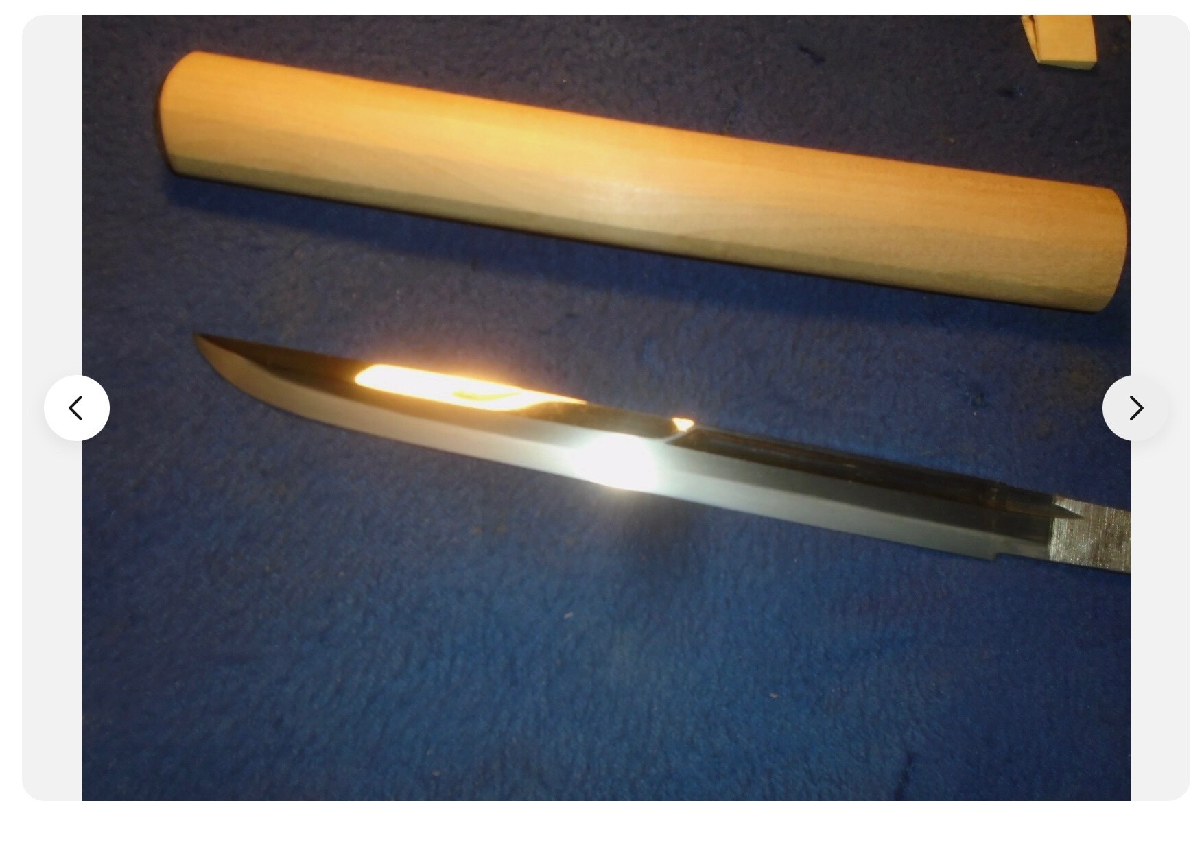

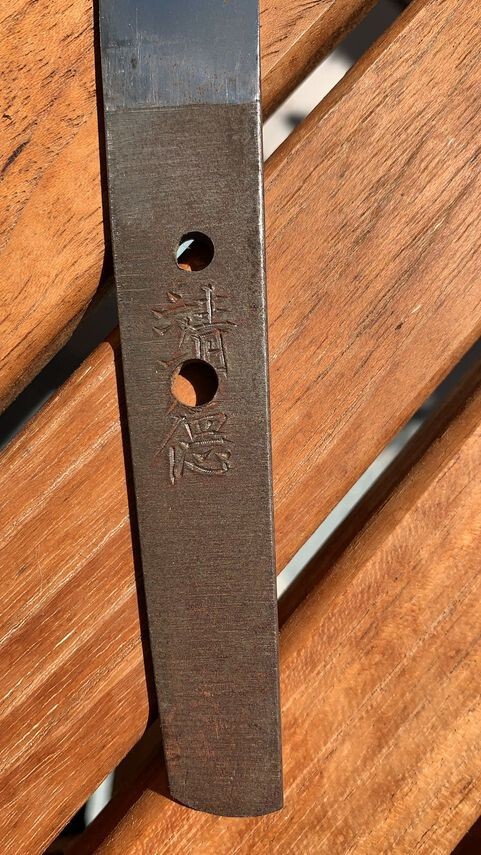

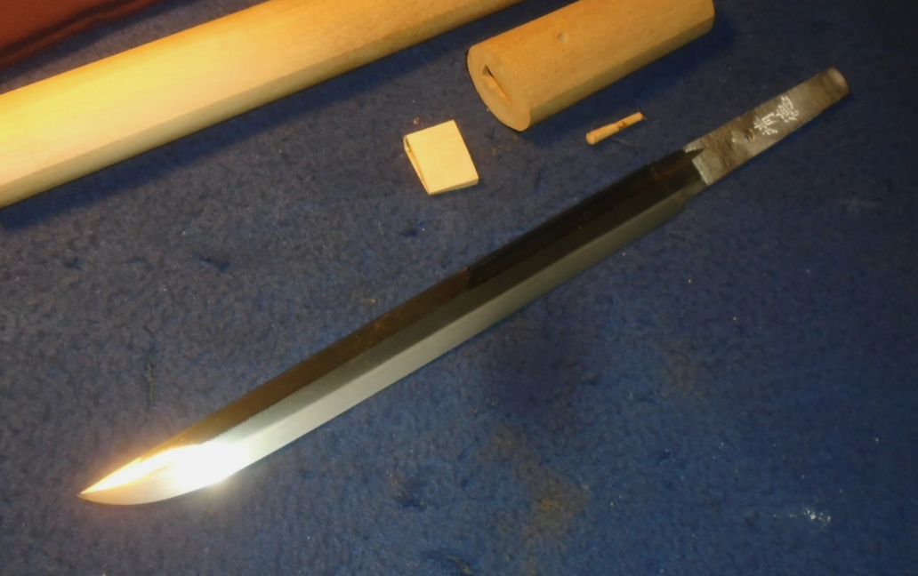

im going to go straight to the hamon ahahhahaha,  wrong. way to thick
construction is always Hira zukuri. not kanmaru Otoshi for the nihonto taren kai
 and the old chalk/powder filled mei is a tactic used to cover a fresh mei.
and the metal is lifeless,  like elon musks personality.
never a chance in a snowballs hell that this "new: tanto was ever shoshin.

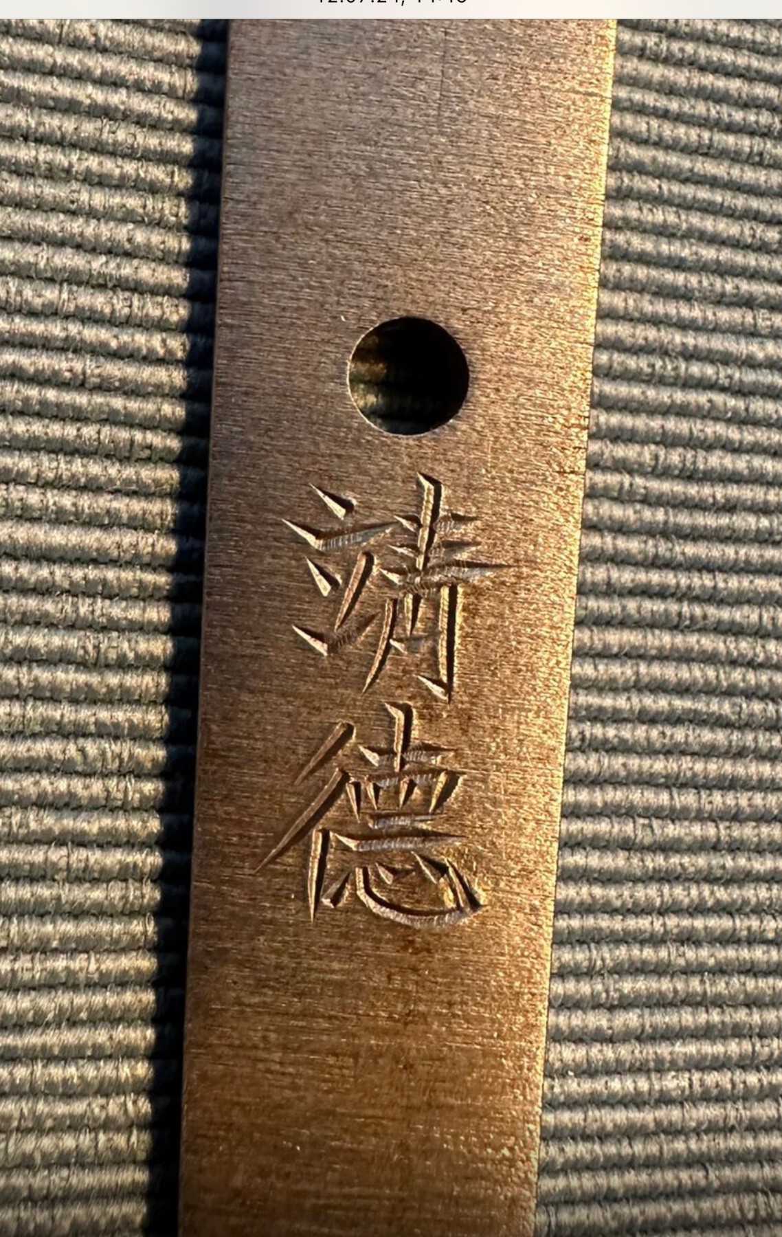

I must admit I've never seen a Yasukuni tanto which wasn't hirazukuri (and I've been looking at them for 20 years now).
Guest When Necessary

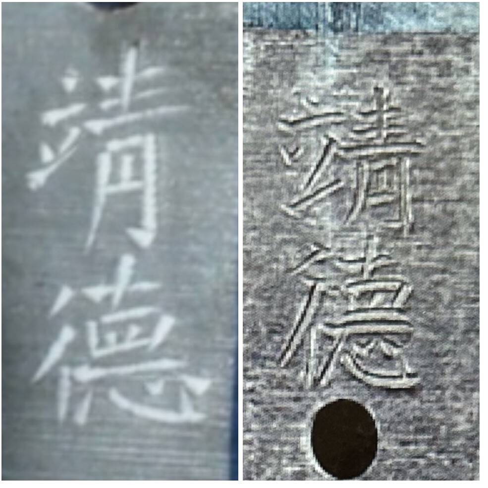

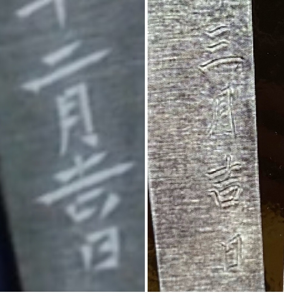

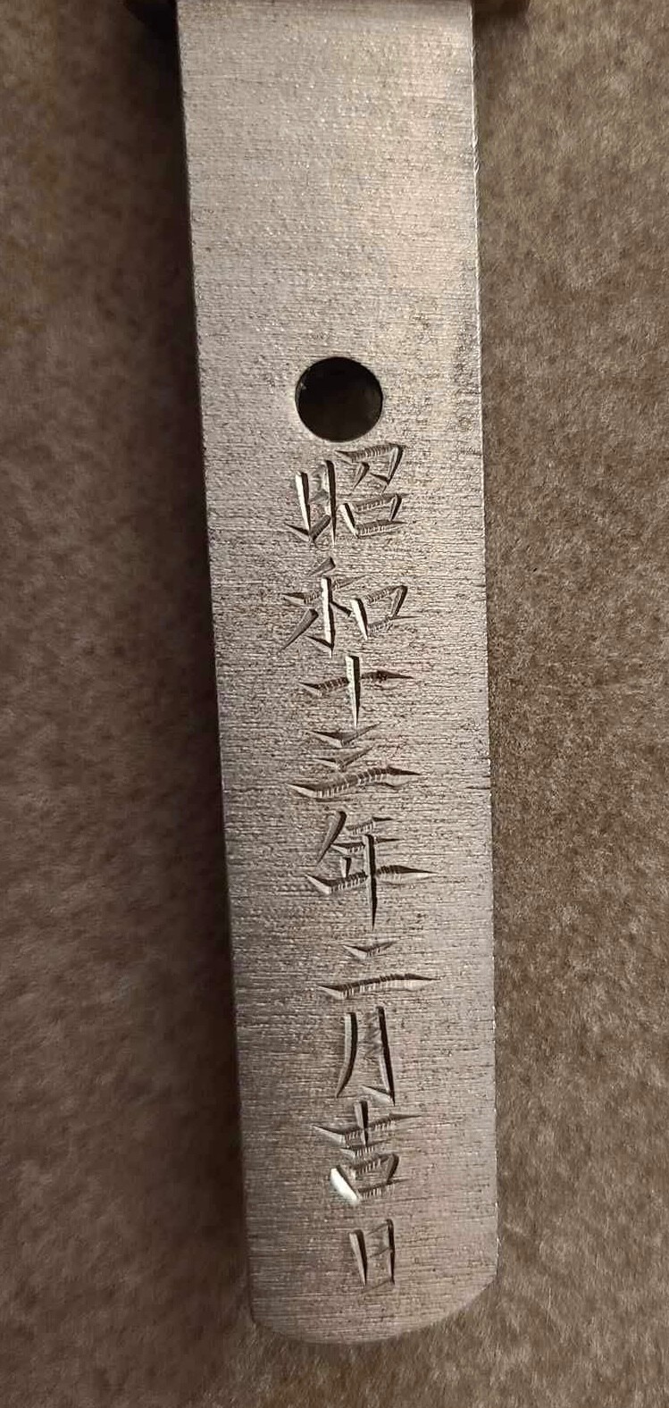

Showa22 on the left, Tokuho papered Yasutoku on the right.
I've only compared part of the date in the second photo but looking at the signature should be enough.

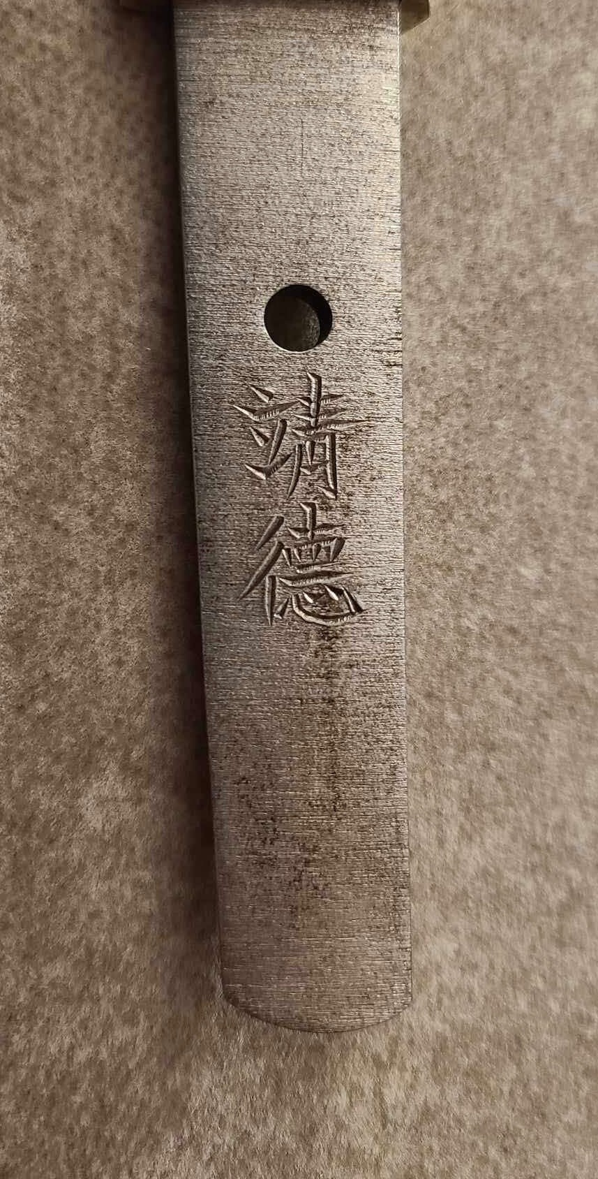

Regardless of the shape, the mei is fake.

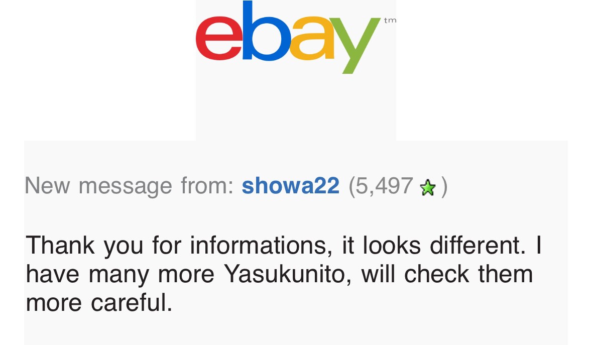

I just sent Showa22 an eBay PM telling him the same - so I'm waiting for the inevitable "Eff off and mind your own business" reply.
The Yamashiro style jiri seems a bit different as well. The OP is straighter across rather than that slight upturn typical of Yasunori.

6 hours ago, Hokke said:
Definitely not hira zukuri….looks more like kanmuriotoshi-zukuri?
You are (almost) correct Calabrese,
in the description (which I should have read before writing....) the SUGATA is mentioned: UNOKUBI-ZUKURI (鵜首造):

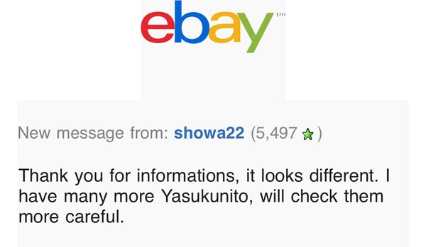

This is the response I received from Showa22 after pointing out his tanto was gimei.
His reply speaks volumes.
You and I both......ah well, one day I'll get something right, then I'll know it's time to hang it up and retire on an upnote

Well, now that I've shown him a real one, he's probably gotten his chisel guy to copy that onto all his mumei gunto.
