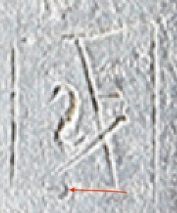

Lewis B Posted August 31, 2025 Author Report Posted August 31, 2025 To my eye this looks like a deliberate strike of the chisel. Why would this be here in the tachi mei above but no other examples I can see..... except the 1308 tanto? Both also have the horizontal strike (shallow but present) above the mirrored 'S' which is absent in most mei. Quote

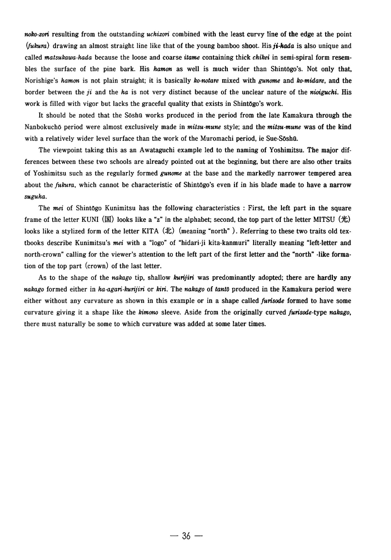

Okan Posted September 1, 2025 Report Posted September 1, 2025 Dear Lewis, This is a research study by Nobuo Ogasawara, conducted for and published in the Tokyo National Museum magazine in 1981. Although I made some small corrections, the translation(AI assisted) still contains some errors, but it should give you the general idea. "" The inscriptions of Shintōgo Kunimitsu, as can be seen from the rubbings presented here, each display individual differences. Broadly speaking, example 1 can be regarded as a representative inscription of the hidari-ji hokan style. Examples 2, 3, and 4 are similar to this, with example 4 bearing the latest date of Gen’ō, and is sometimes regarded as the work of a second generation. What is common among these four pieces is that the forging exhibits a well-developed ko-itame grain pattern, the ji-nie is present, and the blade shows clear ji-kage, resulting in a bright and lively jitetsu. The hamon is a straight temper line (suguha) with well-developed ko-nie, and it features pronounced kin-suji, demonstrating lively activity and excellent workmanship. In contrast, examples 5 and 6, dated to the Kagen and Tokuchi eras, show inscriptions that are finer and weaker in appearance. Despite being early in date, they convey the impression of late-period inscriptions. In terms of inscription style, they are clearly different from examples 1 through 4. Furthermore, the forging shows a pronounced masa-gokoro (straight-grain tendency), and compared to the previous four blades, the nioi-guchi of the hamon is tighter, there is less activity within the ha, and the fukura (blade curvature near the edge) tends to sink. Stylistically, examples 12 and 13 are similar, though their engraving chisels (tagane) are finer and the inscription style differs slightly. Examples 7 and 8, as well as those bearing the Buddhist posthumous name Kōshin, do not use the hidari-ji style, and example 7 also lacks the hokan (north-crown) character. These are considered a different type from examples 1 through 6, though stylistically they resemble 5 and 6. Examples 9 and 10 have overall solid inscriptions, with the third stroke of the ko in Mitsu rendered as a plain “tsu” rather than the variant “フ”. Example 9 features a midareba (irregular hamon) with pronounced kin-suji, and the forging shows a raised texture. Example 10 has an ordinary straight suguha. Example 11 differs greatly in inscription style; although it uses the hidari-ji hokan style, it shows unique characteristics not shared with the others. If anything, opinions have shifted toward a broader view that the pieces in question may date from after the inscription bearing the Buddhist posthumous name Kōshin in Shōwa 4. In that case, the works of Bunpō, Gen’ō, and Genkō would be considered second-generation. However, when it comes to pieces with only the two-character inscription, such as the famous Aizu Shintōgo Kunimitsu, it becomes difficult to determine whether they belong to the first or second generation. A detailed examination of Shintō Gokunikimitsu inscriptions shows that each character varies slightly, making it virtually impossible to estimate the production date based solely on a two-character inscription. Nonetheless, in addition to the common inscription style featuring the “left-character” with a north-crown (hidari-ji hokkan), there are several distinct variants: 1. Those executed with a fine chisel (hoso-zan), where the inscription appears somewhat larger (though in reality almost the same). Examples include works dated to Kagen 4 and Tokuchi 3 (Important Cultural Properties), and, although tachi, the famous Mutsu Shintōgo is included in this group. 2. Those not using the left-character north-crown, such as pieces in the Tokyo National Museum or those bearing the Buddhist posthumous name Kōshin. 3. Those where the “kuni” character is a left-character but the “mitsu” character does not have a north-crown, or where the third stroke of “mitsu” is unusually firm, as seen in the famous Ran Shintōgo. 4. Those with large inscriptions and a firm, rigid style, such as the famous Kojiri Gokunimitsu and the tachi passed down from the Tokugawa family. The four types described above differ from the typical left-character north-crown (hidari-ji hokkan) inscriptions. Based on these differences, it can reasonably be concluded that the inscriptions were not cut by a single hand. Rather than strictly distinguishing first and second generations, it is more plausible to view the head smith Kunimitsu as a single master while Shintō Kunimitsu operated as a collective workshop consisting of multiple smiths. Naturally, certain stages of sword-making required a lead smith, and there may have been several lead smiths working simultaneously, making the finished products the result of collaborative effort. On a larger scale, tasks such as forging, finishing, hardening, and polishing were likely divided among specialists. Although it is difficult to determine the precise scale of the Shintogo Kunimitsu workshop in Kamakura, it is reasonable to assume that multiple smiths inscribed the Kunimitsu signature during the lifetime of the head master. "" 7 2 1 Quote
Lewis B Posted September 1, 2025 Author Report Posted September 1, 2025 I enjoyed reading that treatise Okan. Certainly provides more food for thought and some hypotheses regarding the organization of the Kunimitsu atelier. I thought what was especially interesting was the use of a thin chisel between 1306 and 1308, and the differences in forging style with pronounced masa-gokoro during this period. It will be interesting to see if this forge welding pattern is present in my 1308 tanto after polish. Another useful datapoint is that the Buddhist koshin inscription was posthumous. Given this fact, did Shintogo Kunimitsu die in 1310 or earlier (the 2nd character for the tachi nengo is a little unclear)? I like the idea of a collaborative/cooperative working environment. This would fit many of the theories that connect the different smiths, both directly as apprentices and possibly later as a partnership with 2+, more or less independent groups, working in the same atelier. Headed by the master Shintogo Kunimitsu with his own apprentices, Kunihiro, Kunishige, Norishige and Kuniyasu (Daishinbo), whilst on the other side there's Yukimitsu and his son by birth or adoption, Masamune. 1 Quote
Okan Posted September 1, 2025 Report Posted September 1, 2025 I believe the use of “posthumous” was just a simple translation error. I’ve checked the original text again, and it does not say anything about “after death.” Other sources suggest that Kunimitsu likely took Buddhist vows while still alive, and the work dated 1315 may have been made by him personally, maybe his last one. Some sources also suggest that the blade is a work from his advanced age. There are no clear records of the date of his passing, and the blades bearing dates later than this (1319, 1321, 1329, etc.) are attributable to Kunimitsu II. Overall, I believe all of these attributions are best guesses based on the available evidence, so it’s best to wait for the sword to be polished, which may reveal more definitive information.. Quote

Lewis B Posted September 21, 2025 Author Report Posted September 21, 2025 Is it possible to determine if the mei is in gyakutagane (reverse chisel/raised edge) left to right style, as opposed to sakatagane, from these photos? Quote
Lewis B Posted September 22, 2025 Author Report Posted September 22, 2025 Why is this an important characteristic, especially when discussing Etchu vs Sagami smiths in general, and Norishige in particular? According to AI using historic Oshigata references, together with extant work, the following is stated: Quote
Shugyosha Posted September 22, 2025 Report Posted September 22, 2025 Hi Lewis, Have a look at Michael's post in this thread on the subject which might help you come to a conclusion. I can't draw a firm conclusion and it doesn't help (me) that this is an older form of the kuni kanji. To my eyes the second horizontal stroke off the central diagonal in "kuni" looks like it might run in the opposite direction to normal and the bottom stroke of the enclosure is a possibility too but less obviously so. The long horizontal bar on "mitsu" also looks like it has been done right to left to me but it's finger in the air stuff. I think the best opinion you will get would be from @Nobody san. 1 Quote
Lewis B Posted September 22, 2025 Author Report Posted September 22, 2025 Thanks John. I saw that thread when I searched gyakutagane. Interestingly there is very little discussion about this feature, but it could turn out to be a decisive argument, if confirmed, for daimei-daisaku by Norishige. The impression I get is that to be sure, the mei has to be examined in hand, since all we see in photos and oshigata are a 2D representation. A shadow effect for incised chiseling is often cited as being indicative of sakatagane but would depend on the direction of the light source and need to be off axis. To my uneducated eye the feature that shows promise are the numerous areas where the yokan-iro either side of the strike marks has been worn away because they are raised above the metal surface of the nakago. 1 Quote
CSM101 Posted September 22, 2025 Report Posted September 22, 2025 Something about the mei and how it is cut... Quote
