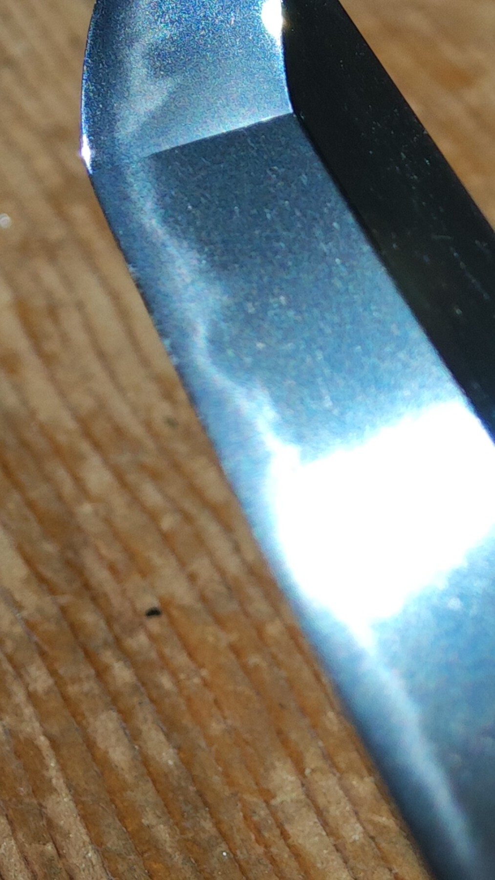

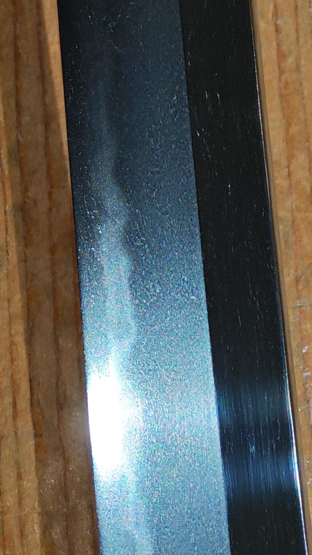

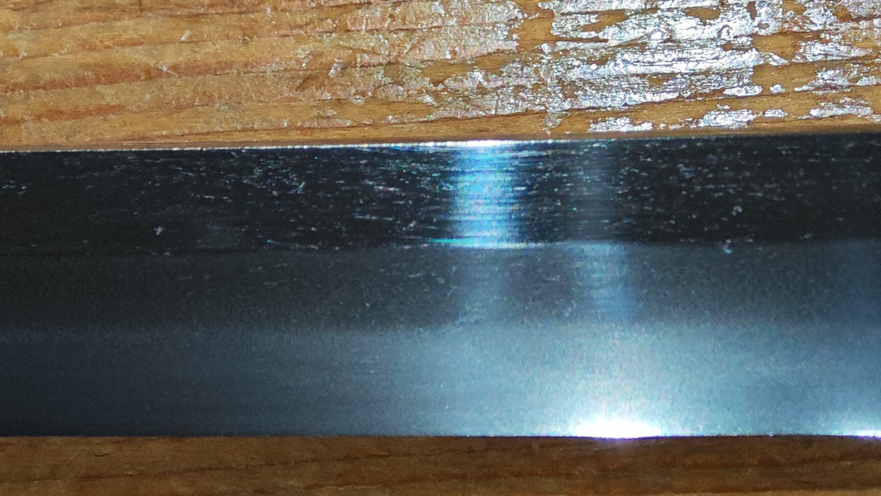

RichardY Posted May 28 Author Report Posted May 28 @Bugyotsuji misspelled and yes still new. My agreement with the seller is I have to hand carry it back lol. Both comes with koshirae. I'll attach the papers shortly please do correct me if at any time I'm wrong @Ray Singer there is a post somewhere about sukehada and the inscriptions .. so this one only name and date .. No commissioned by. I prefer the mumei because of the hamon whereas the sukehada hamon is suguha. I think I have a very good picture of the mumei but not the sukehada blade, only the inscriptions on the tang 1st 2 pictures are the mumei blades followed by the paper. Quote

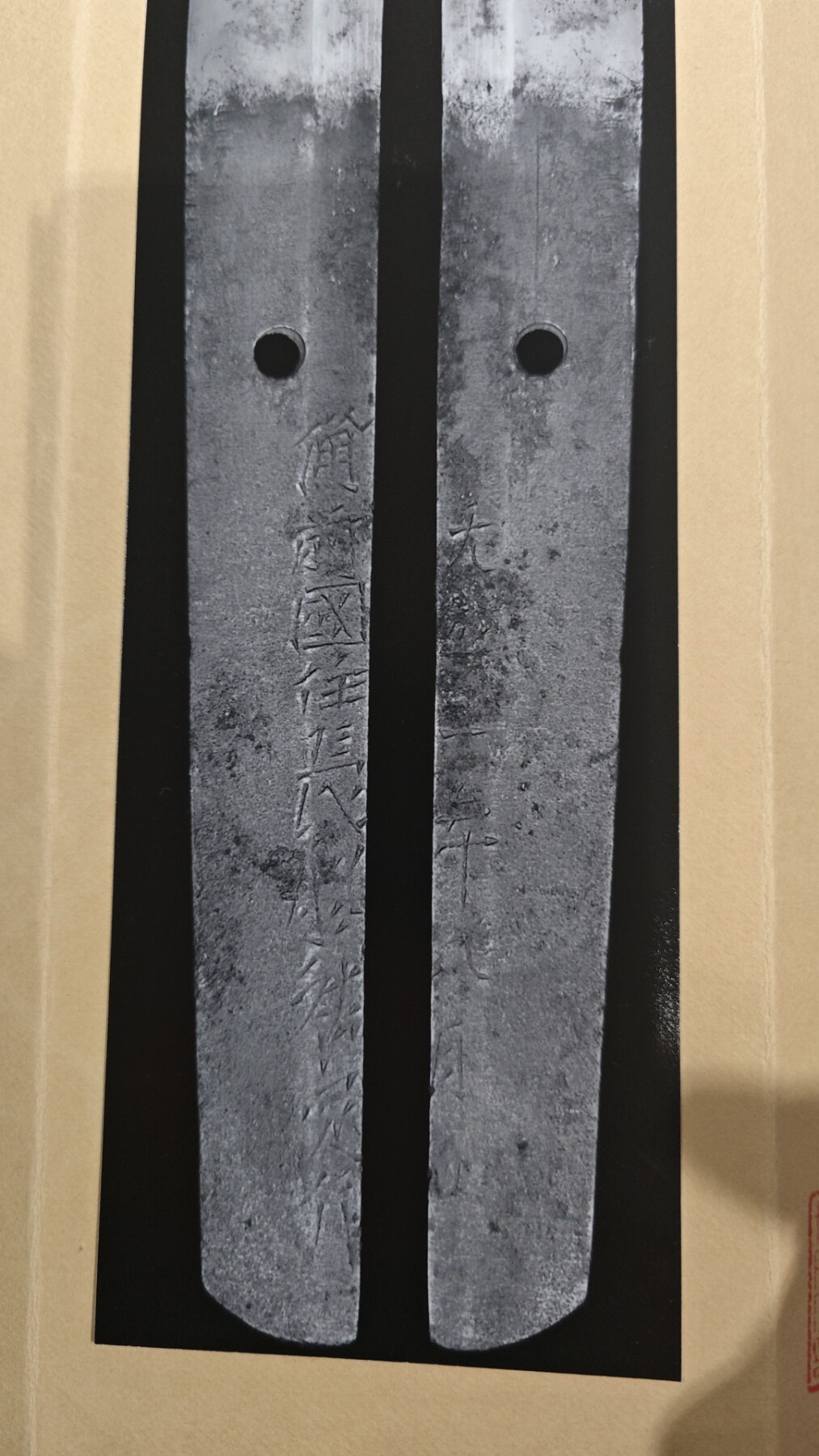

RichardY Posted May 28 Author Report Posted May 28 This is the sukehada blade. Sorry for multiple posts I'm limited in size of attached files Quote
Ray Singer Posted May 28 Report Posted May 28 The osuriage blade is attributed to den Rai Kunizane. A famous smith from late Kamakura into Nanbokucho who studied under the Saijo smith Rai Kunitoshi. The Sukesada is signed Bizen no kuni Osafune ju Sukesada. The date unclear due to the inscription being damaged by rust. If you have the entire paper, please share that one with us. There were many Sukesada in the lineage, with multiple individuals using the same name at the same time in parallel. Unless the papers provide more specificity, this would be a generic Sukesada working at the end of the muromachi period (one of many, with it being difficult to identify a specific individual). Quote

RichardY Posted May 28 Author Report Posted May 28 2 hours ago, Ray Singer said: The osuriage blade is attributed to den Rai Kunizane. A famous smith from late Kamakura into Nanbokucho who studied under the Saijo smith Rai Kunitoshi. The Sukesada is signed Bizen no kuni Osafune ju Sukesada. The date unclear due to the inscription being damaged by rust. If you have the entire paper, please share that one with us. There were many Sukesada in the lineage, with multiple individuals using the same name at the same time in parallel. Unless the papers provide more specificity, this would be a generic Sukesada working at the end of the muromachi period (one of many, with it being difficult to identify a specific individual). 1 hour ago, Brian said: Sukesada, not Sukehada. There were a prolific number of smiths with that name, and tbh, the average ones aren't highly regarded. They made practical swords, more function than art. Lol my apologies.. I'm dyslexic sorry Quote
nulldevice Posted May 28 Report Posted May 28 8 minutes ago, RichardY said: Lol my apologies.. I'm dyslexic sorry The date is "A day in August of Tensho 2" which is 1574 1 Quote

RichardY Posted May 29 Author Report Posted May 29 6 hours ago, AlexiG said: One has to wonder why a Kamakura or Nanbokucho sword attributed to a well-known school will be priced the same as a late-Muromachi sword from a "generic" school. Is the den Kunizane sword tired, or is there something special about the Sukesada sword that has not been discussed yet? Alexi Actually the Den Rai costs much more .. but I specifically gave a budget and the seller brought out 3 blades but found out the later price was much higher for the Den Rai, so he honoured my budget.. 2 said katanas and 1 more from even earlier Kamakura period mumei o suriage 6 hours ago, Ooitame said: Hi Alexi, Since it is mumei, O suriage, and Den vs specific Smith would be my guess for price difference. Also depends on more pictures needed for possible ware, and if they come with Koshirae or Shirasaya and those conditions. That was my initial dilemma and doubt .. why would a Mumei be more expensive than a named sword (thanks to everyone here I now know the difference) Sorry I do not have photos of the Koshirae but both blades come with koshirae and both look nice and fitting. 1 1 Quote
Hoshi Posted Friday at 11:29 AM Report Posted Friday at 11:29 AM Quote That was my initial dilemma and doubt .. why would a Mumei be more expensive than a named sword (thanks to everyone here I now know the difference) It's not a named sword, this would be a sword with Go (Name). It's a zaimei Muromachi blade, from a group of makers that have been extremely prolific. These blades are commodities, with the exception of the rare custom ordered ones that generally (but not always) carry the full name of their maker (e.g., Yozozaemon, Gembei...). Nakajima Rai is a bucket attribution for blades that are "almost Rai Kunimitsu" but show less ji-nie, less nie-utsuri, more nagare...etc. It's second tier Rai. Even mumei Rai Kunimitsu is also often a problem, there are just too many of them, with a significant portion being rather uninspiring. That said, a length of 75 cm is rather rare, especially for the Muromachi Sukesada, which could point towards a custom order. Unfortunately, without detailed photos or videos, it's impossible to say more. Perhaps, the less risky strategy is to buy the cheaper 75cm Sukesada, study it and save money. Quote
