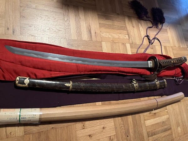

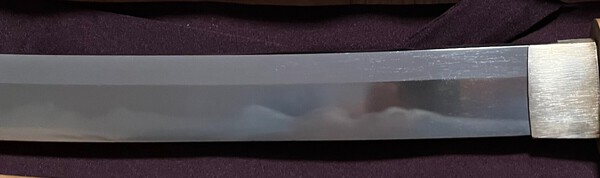

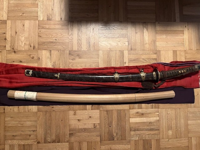

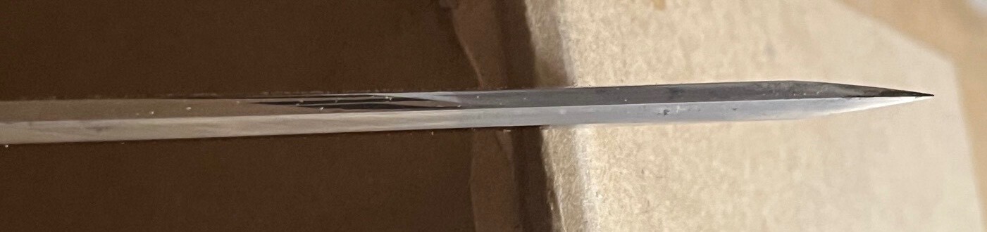

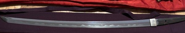

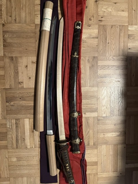

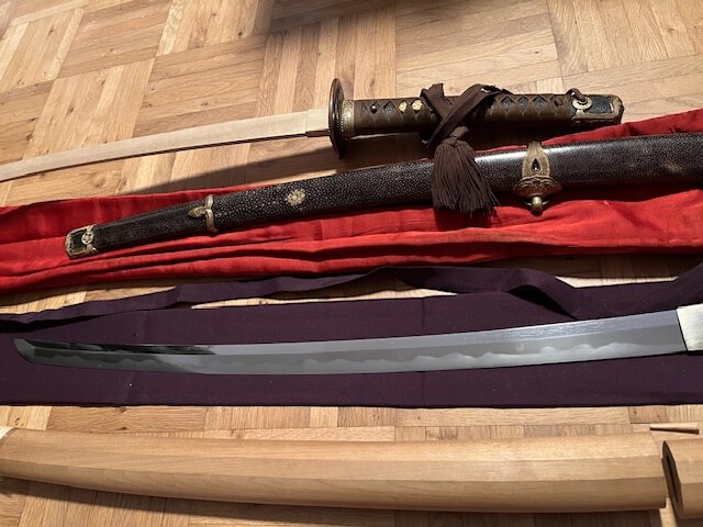

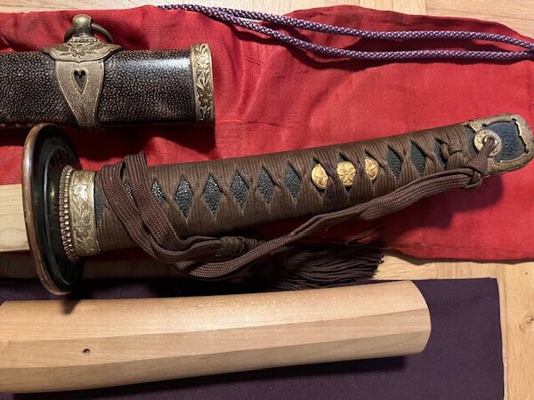

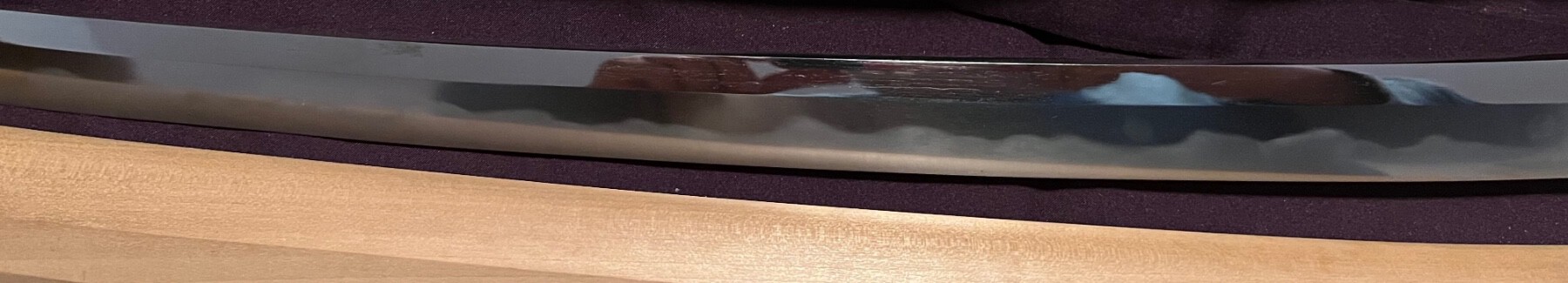

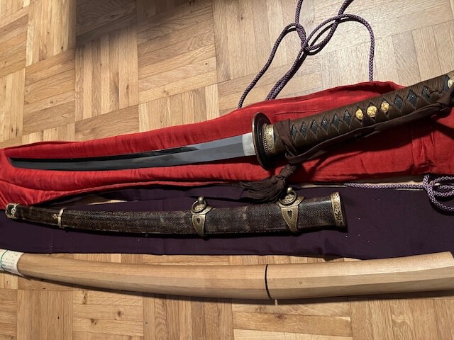

this Kai Gunto marine sword is for sale near me. Is it a good one? Is it possible to tell something about the age of the blade and polishing?

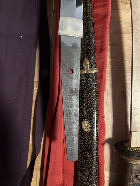

Looks like a traditionally made blade in high quality military mounts.

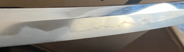

With good photos of the NAKAGO (plain, dark, non-reflecting background, photos presented as cut-outs, no HABAKI) and close-ups of the blade you may get more feedback in the NIHONTO section.

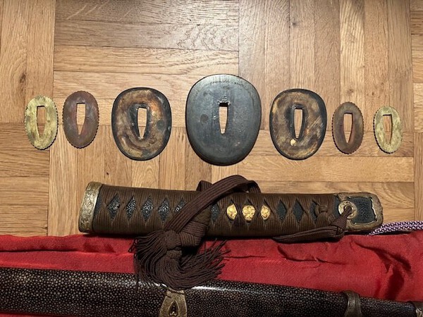

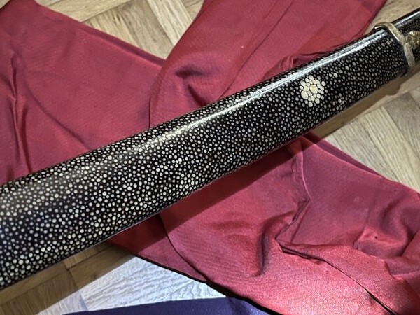

The koshire (especially the ray skin saya) is very fine. This suggests the blade for which it was made is equally valuable. Being mumei and o-suriage I would assume its quite old (family blade?)
It's also not common to see a tsunagi/shirasaya setup on WW2 swords like this. Somebody must have recognized the quality post-war, and commissioned the shirasaya.

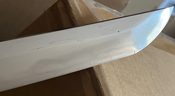

Blade looks older than WW2 to me. Wish we had more sugata photos, but my gut leans toward shinto period :dunno:
I am making some assumptions, obviously - but it all bodes well for a potentially quality piece.

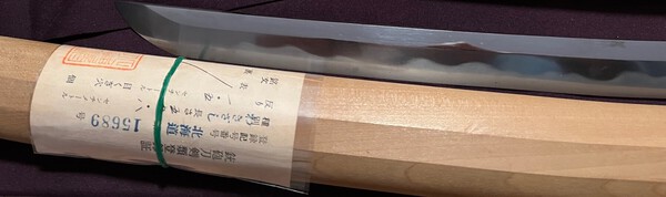

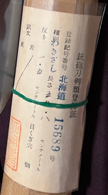

Nice looking blade, and it looks like a wakizashi, since the torokusho states the cutting edge being 5?.8cm. The mounts are very nice, especially that area of the ray skin that looks like a chrysanthemum flower. This is probably a sword that came from a collector in Japan, judging from the attached torokusho.
BTW, the tang is ubu, not osuriage.

Ubu yet mumei? An interesting discussion here around the subject.
https://www.militaria.co.za/nmb/topic/14981-ubu-and-mumei/#comments

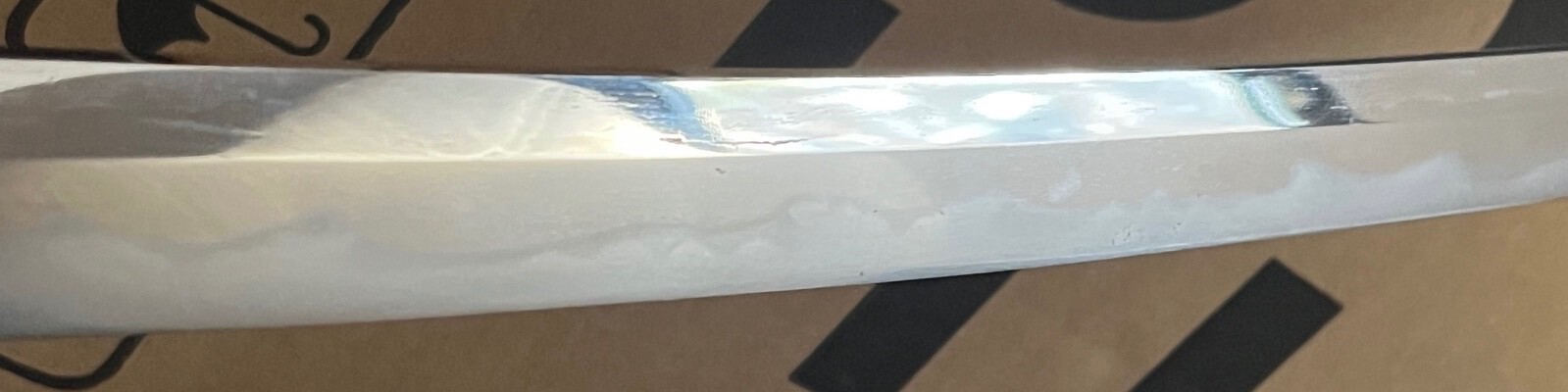

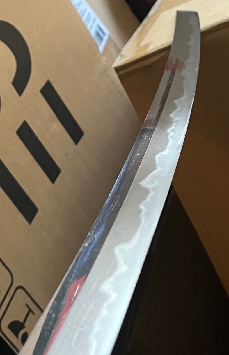

This one, based on the pictures, looks like a very nice O-Wakizashi/Ko-Katana. In decent polish and with nice looking, original Gunto Koshirae. Blade might be Shinto Echizen as per my first guess.
I wouldn't mind to have one like that in my collection. IMHO it is easily worth minimum 3k$. Even without papers (although for some collectors they are mandatory).
