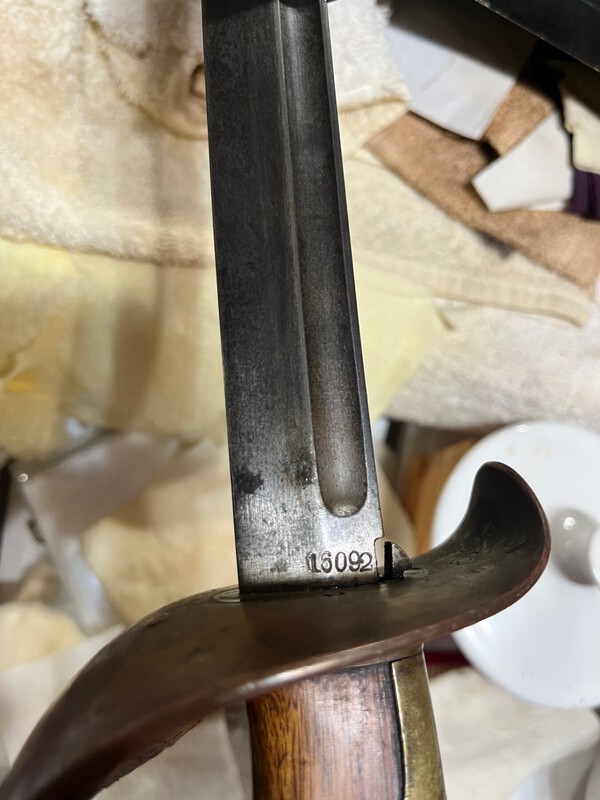

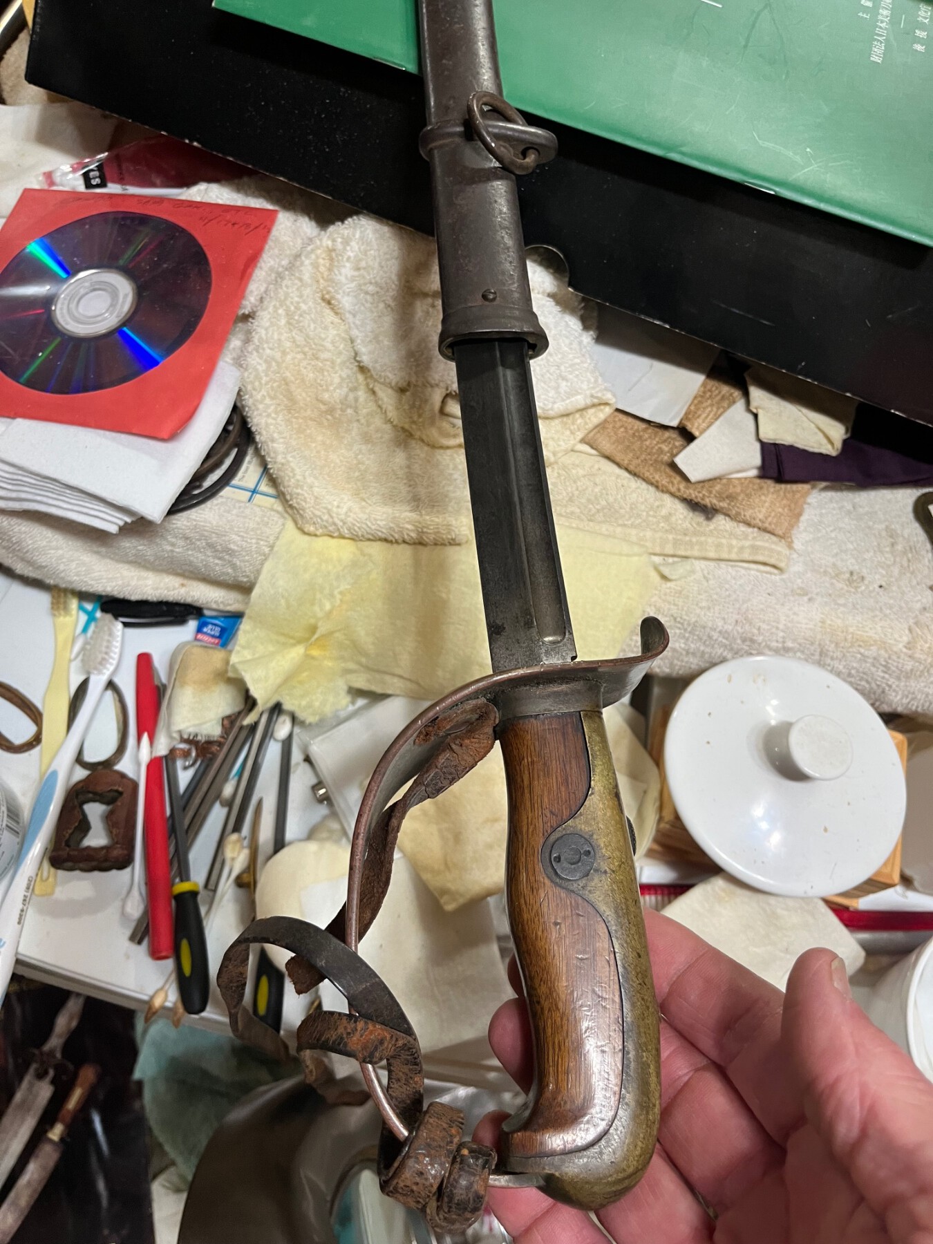

Bruce Pennington Posted June 3, 2025 Report Posted June 3, 2025 Here is one for you, John. Comes from Leo Monson’s collection. 2 Quote
John C Posted June 4, 2025 Author Report Posted June 4, 2025 Thanks, Bruce. 16092 is now logged under Leo Munson. BTW, second to the oldest on file. Still seems likely only 17,000 were produced. John C. 1 Quote

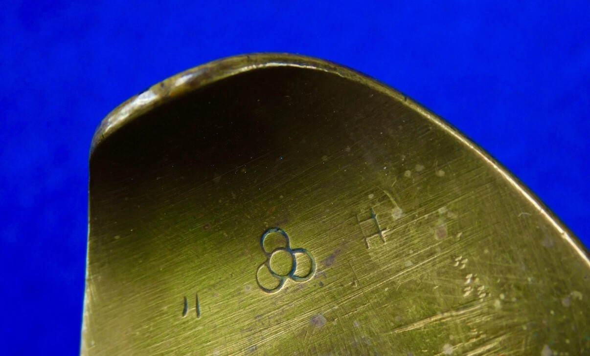

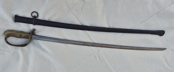

Scogg Posted December 6, 2025 Report Posted December 6, 2025 Spotted on eBay https://ebay.us/m/HpCkpX 2 Quote
John C Posted December 6, 2025 Author Report Posted December 6, 2025 Thanks, Sam. That's a new one for the list. Up to 42 examples. Interesting that the seller lists it as "WW1." I assume he means Japan-Russo war (~1905) and even then it wasn't widely used with the introduction of the type 32. John C. 1 Quote
Bruce Pennington Posted December 6, 2025 Report Posted December 6, 2025 Very strange that both sides were ground down to make machi, as if someone was going to mount a traditional samurai style handle. Quote
Kiipu Posted December 6, 2025 Report Posted December 6, 2025 I think that is a fold of blue background cloth overlapping the blade? Quote
Scogg Posted December 6, 2025 Report Posted December 6, 2025 Both sides were definitely ground down, for reasons I fail to imagine. Bruce's theory makes as much sense as any, but then, why stop half-way through the conversion? Have you seen any others with this "machi-okuri situation" @John C? 1 Quote
John C Posted December 6, 2025 Author Report Posted December 6, 2025 6 hours ago, Scogg said: Have you seen any others with this No. Nothing like that. In fact, I thought for a moment that a digit might have been ground off, however the gap between the blade and latch is only slightly wider than what I would expect. John C. 1 Quote
Bruce Pennington Posted December 7, 2025 Report Posted December 7, 2025 I admit, too, John that I'd never noticed that the 25s were stamped on the hand guard like the 32s. Quote
John C Posted December 7, 2025 Author Report Posted December 7, 2025 13 minutes ago, Bruce Pennington said: never noticed that the 25s were stamped Looks like the inspector stamp was on the blade side opposite the serial number, with the Tokyo and date stamps on the guard, through around 13,000. Then all the stamps moved to the guard. Of course, this is based on a very limited sample size and may not be completely accurate. John C. 1 Quote

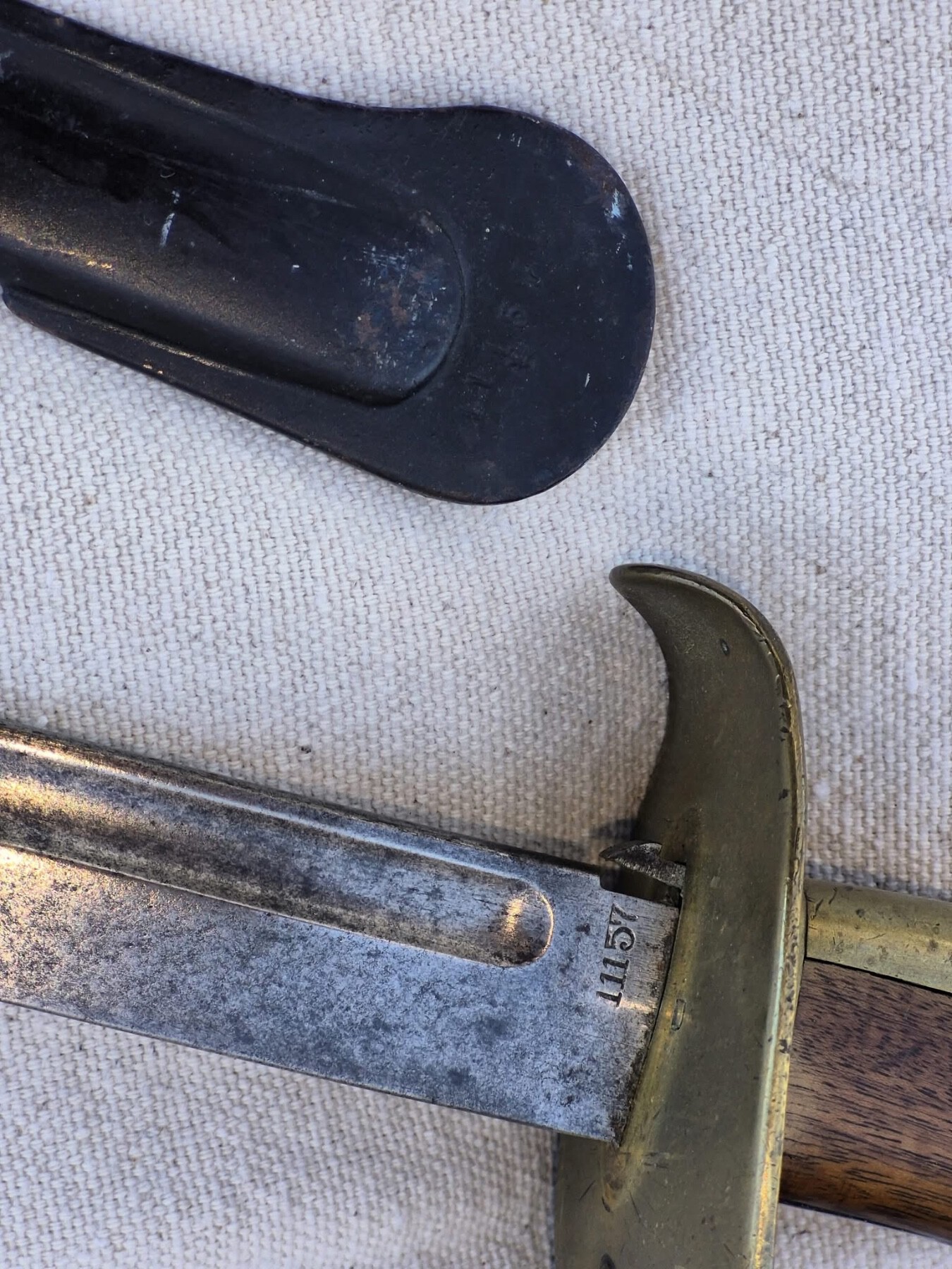

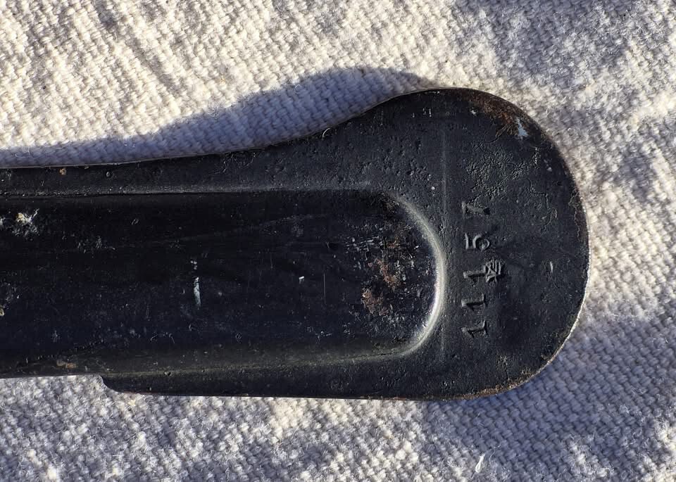

Shamsy Posted January 13 Report Posted January 13 For your work. No markings on the guard or anywhere else I can see. Scabbard drag matches 1 2 1 Quote
John C Posted January 13 Author Report Posted January 13 Excellent, Sham. Added to the list! John C. p.s. That's 44 serial numbers on record; that particular mark is seen on the serial number side up through about number 1,000, however there is a large gap between 1,000 and 1,900 so unsure of the exact point the mark changed. 2 Quote
