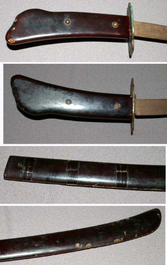

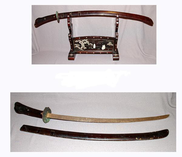

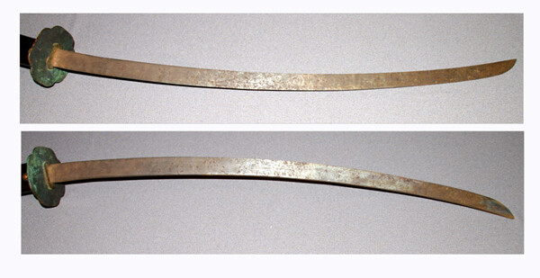

sanjuro Posted January 26, 2010 Report Posted January 26, 2010 In one's search for all things Nihonto, and the necessary trawling of auctions, I came upon this little item for which I have no explanation. Not having access at present to my own library, and also not having by any measure an encyclopeadic knowledge, I was wondering if anyone out there can enlighten me as to what this actually is. It is described as a Keiko To, which I have never come across before, and which unfortunately Google does nothing to explain. It brings to mind a keiba no dachi but doesnt quite fit that description either. Quote
John A Stuart Posted January 26, 2010 Report Posted January 26, 2010 A keikoto is a practice sword, 稽古刀. If this is what they are refering to. I have not seen one like this with a single handed grip, but, should have a blunt edge. John Quote
Toryu2020 Posted January 26, 2010 Report Posted January 26, 2010 Looks more like a theatrical item, as might be used in Gagaku performance rather than something for kenjutsu practice. MHO -tom Quote
Grey Doffin Posted January 26, 2010 Report Posted January 26, 2010 Are we even sure this is Japanese? Grey Quote
sanjuro Posted January 26, 2010 Author Report Posted January 26, 2010 Grey The dealer is known to me and I have had some excellent items from him in the past. He assures me this is indeed Japanese, and quite old. By old he usually means pre Edo. Further information he has provided is that the blade is steel but without an edge. If it is indeed a practice sword then it would certainly have that feature. The blade can be withdrawn from the tsuka and has two mekugi of black horn. There are still a few odd features about this though. Quote

IanB Posted February 1, 2010 Report Posted February 1, 2010 Two aspects of this object strike me as being unusual: Firstly the 'blade' has no habaki and secondly the archaic shape of the tsuka. I suspect, like Tom, the object is a prop for one of the ancient court or shrine dances, a factor partially supported by the flimsy nature of the tsuba. Back in the late 1960's I once owned a jitte mounted as a sword. It looked exactly like a wakizashi, with all the usual fittings, including a kozuka, except that the hirazukuri blade had a rounded edge and was unhardened. I remember the saya was a pleasant buff colour. At first I thought it was a sword that some idiot had blunted until I noticed the habaki was shaped internally to fit the rounded edge. Wish I still had it! Ian Bottomley Quote
