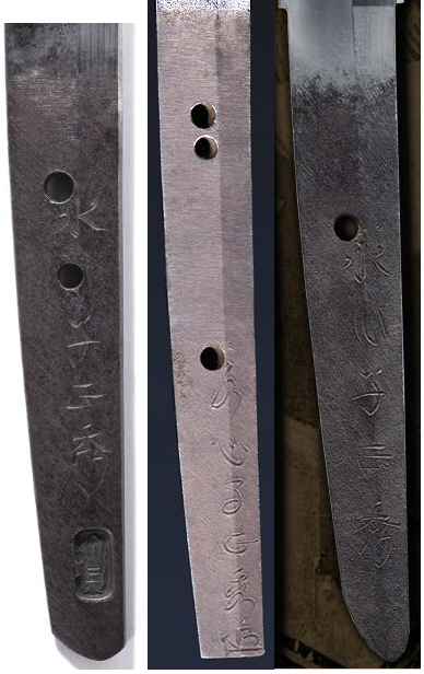

Stephen Posted December 21, 2009 Report Posted December 21, 2009 John I can understand you want a second opnion, Please not all Caps it same as yelling!!! heres the pix, i thought you seen it cropped and reduced in my later emails, the link for this board was to get a feeling for the mei, shoshin? gimei? second gen ? third. you come off not wanting to provide info...dont understand this point. anyway heres your pix. lets ask nice please. Quote
Mark Posted December 21, 2009 Report Posted December 21, 2009 tang says it was made by Masahide Quote
mdiddy Posted December 21, 2009 Report Posted December 21, 2009 Here's a link to the post on another forum with more pics: http://www.wehrmacht-awards.com/forums/ ... p?t=402176 Tang is signed 'Suinshinshi Masahide' but sure its gimei. Mei is pretty far off, filemarks are wrong, etc. Not another gen. either. On the bright side it's definitely Japanese not Chinese. The fittings could be nice. I'm not yet very knowledgeable on fittings so will let someone else comment but looks like a nice tsuba and waribashi. Quote
Toryu2020 Posted December 21, 2009 Report Posted December 21, 2009 Most definitely not Suishin-shi Mashide Can't see the photos unless I join the Wermacht... -tom Quote
Stephen Posted December 21, 2009 Report Posted December 21, 2009 John if you do a search here youll see Masahide talked about quite a bit. here is one post to show Masahide mei. if you ask kindly (i no longer have the book) a scan of NihontoKoza Shinshinto it has a whole page on shoshin and gimei Masahide mei that shows strokes and how gimei are off. Quote

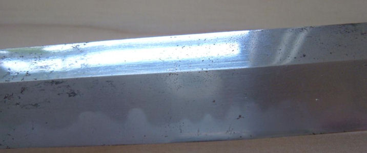

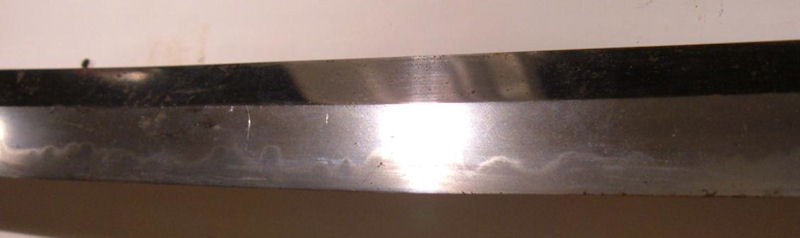

JOHN MACK Posted December 21, 2009 Author Report Posted December 21, 2009 From what i am slowly learning as a new collector is that i will need to buy other books. ok so i read that gi- mei is put onto swords of lesser blade smiths and unmarked swords to increase the value ,i do not yet understand why this katana has the expensive hardware , it may very well be as you have suggested that the markings were added to honor this smith , can this be one of his students swords ? the hammon does not look of the edo period , at least to my inexperience eye that is.i am only doing a book comparison to edo hammon styles . again bear with me as i am learning ... Quote
nagamaki - Franco Posted December 21, 2009 Report Posted December 21, 2009 From what i am slowly learning as a new collector is that i will need to buy other books. ok so i read that gi- mei is put onto swords of lesser blade smiths and unmarked swords to increase the value ,i do not yet understand why this katana has the expensive hardware , it may very well be as you have suggested that the markings were added to honor this smith , can this be one of his students swords ? the hammon does not look of the edo period , at least to my inexperience eye that is.i am only doing a book comparison to edo hammon styles . again bear with me as i am learning ... Hi John, 1) A good library is essential to nihonto collecting, especially if you intend to advance your knowledge beyond a beginners level. Attending shows that offer educational programs and joining study groups is also part of the program for serious students. 2) Learn kantei, it is the foundation for sword appreciation. 3) A good or poor quality sword can be found with good or poor quality fittings. 4) It is true that very, very, rarely, a sword's signature can be attributed to a student signing for the sword smith, but that is for a shinsa to determine. Quote

ottou812 Posted December 22, 2009 Report Posted December 22, 2009 Here's the scan of Masahide' mei from the book. Quote
Stephen Posted December 22, 2009 Report Posted December 22, 2009 Thanks James wish i still had the Koza books, there was a chapter in there about a famous forger so famous his gimei was sometimes sought after. what was his name and did he do Masahide also? sorry to have such a tired memory. Quote
Jacques Posted December 22, 2009 Report Posted December 22, 2009 Thanks James wish i still had the Koza books, there was a chapter in there about a famous forger so famous his gimei was sometimes sought after. what was his name and did he do Masahide also? sorry to have such a tired memory. Hosoda Naomitsu alias Kajihei. Quote
Stephen Posted December 22, 2009 Report Posted December 22, 2009 Thank you Jacques, yes thats the name me old fog was trying to pull out. Quote

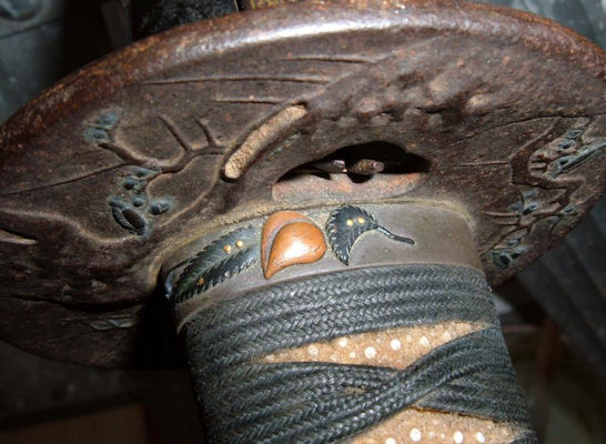

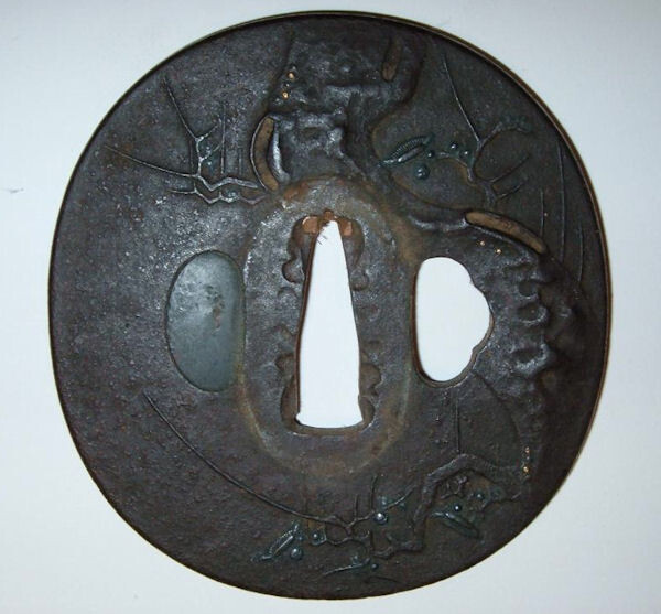

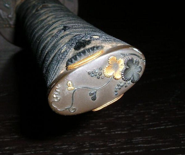

JOHN MACK Posted December 22, 2009 Author Report Posted December 22, 2009 Thank you James , , so in the reality of things , the blade seems to be of excellent quality non the less and the hardware looks high end , is it recomemded that i have this blade resored and what sort of value does this gi mei sword hold? i appreciate all of the help on this ,john Quote
John A Stuart Posted December 22, 2009 Report Posted December 22, 2009 So sorry to be a grinch, but, the sword will need a full polish and will cost a buck. If you consider it is gimei and devalued because of it, I would get it to someone to assess in hand before sinking cash. The fittings are nice, although not high end. I like to see swords preserved, however, unless cash has no relevance, tread carefully and decide why this sword is worthy of a polish to you. john Quote
