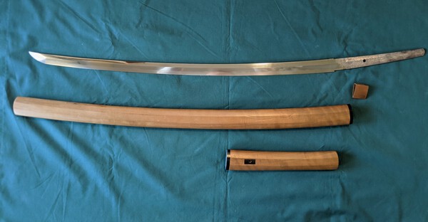

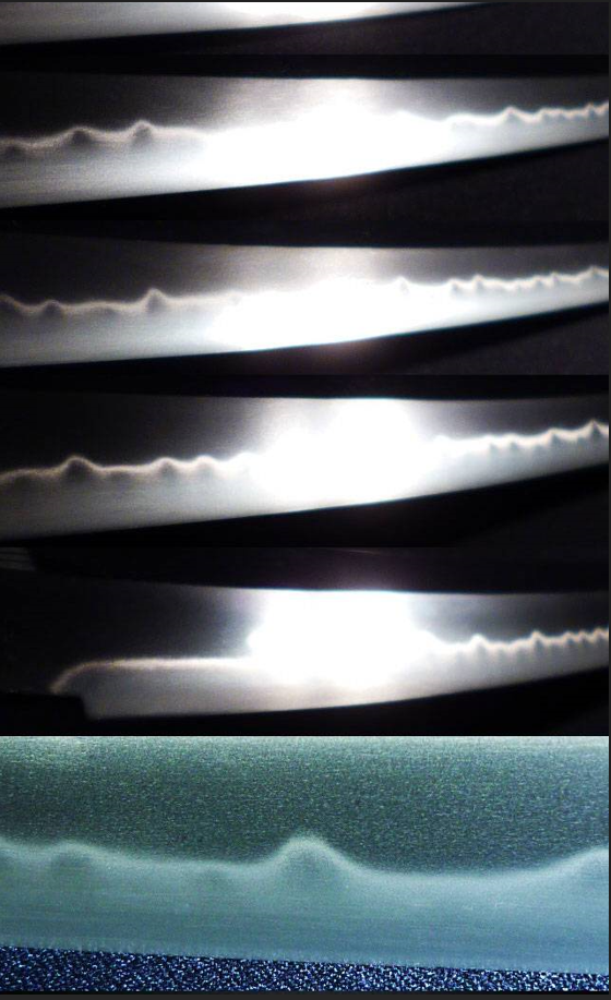

Thought I'd share this oddball koa isshin mantetsu blade that I acquired years ago, that has a nioi based gunome hamon. Has anyone seen another non-suguha koa isshin blade?
  • Wow 1
image.thumb.jpeg.2d89d2121c68f90e34cb6eeb3cd4cd6d.jpegimage.thumb.jpeg.959b0e1aab99bcb0ccf5cfbb3d218dba.jpeg

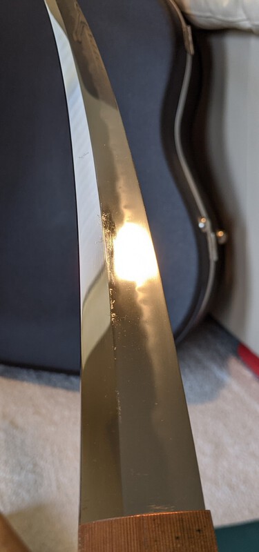

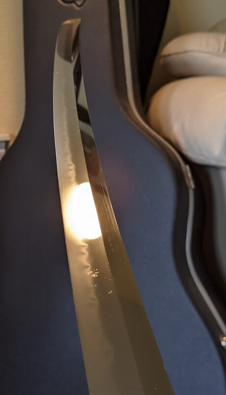

Ah, good point. Oddly enough, it doesn't have any serial number on the nakago. The person whom I purchased it from says he suspected it was a sword made for the mantetsu exhibition, hence it's in a nice horn fitted shirasaya.

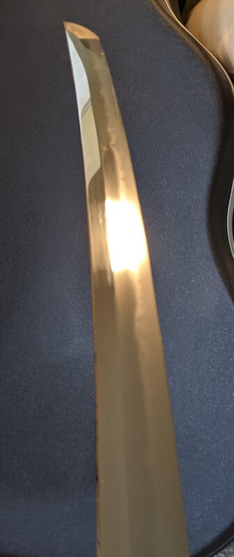

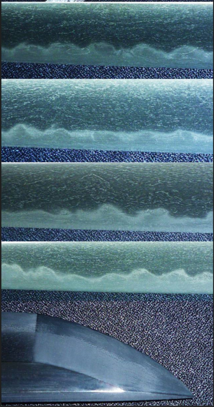

And this shot shows that the hada is quite evident, so the blade does seem forged, and not mill produced showato. If it's a gimei, it's the first I've heard of a mantetsu gimei, ha ha.

lets apply Occam's razor to this sword .
1-hamon,  clearly oil quenched,  clealy in the mino seki style know to be mass produced during era.
2-kissaki dosnt match koa isshin mantetsu  "a robust ko kissaki" the above has more of a chu.
3- very fresh mei that dosnt even match the patina of the clearly cleaned nakago
4-nakago shape tapers to much
5- the poorly finished yasurime,  koa isshin had etremely well finished nakago and yasurime.
so go with whats the simpler explanation or most obvious.
IE a mumei seki/showato tarted up at look like a more commercial sale to the uneducated white man, compared to a mumei seki-to that wouldnt evan sell on fleabay.
stick that in your fife and smoke it
