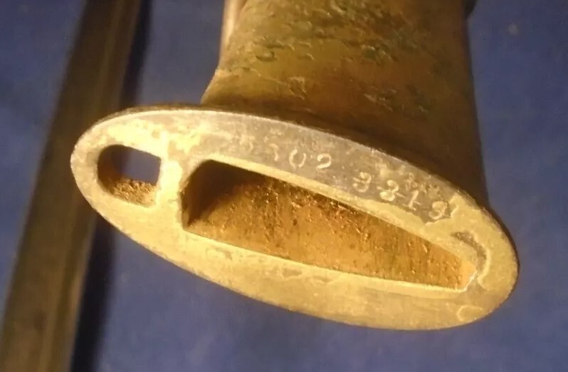

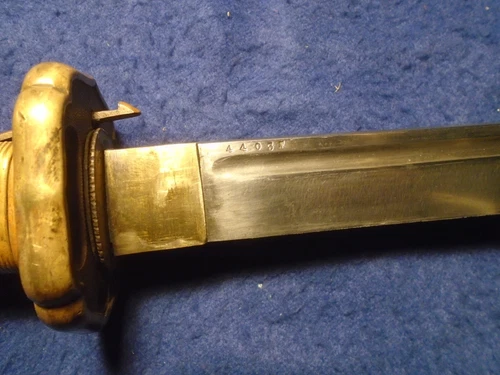

Conway S Posted April 10, 2024 Report Posted April 10, 2024 Greetings, It looks "real" to me, but something about these listings always seem a bit off. Maybe it's the glare and grainy quality in each photo. Plus the seppa are in the wrong order. Looks like the saya had two different serial numbers at one point. https://www.ebay.com/itm/235514477237 Conway Quote
John C Posted April 10, 2024 Report Posted April 10, 2024 Serial number on the blade seems to be in the right range; stamps on the fuchi look legit. But we always have to take that seller with a grain of salt. John C. 1 Quote
drb 1643 Posted April 10, 2024 Report Posted April 10, 2024 It looks like a legit copper hilt with a correct but mismatched saya. Tom Quote
lonely panet Posted April 11, 2024 Report Posted April 11, 2024 Looks too good for the reputation of the dealer Quote
Bruce Pennington Posted April 12, 2024 Report Posted April 12, 2024 Wow, that's a fascinating saya, all by itself! Two previous numbers, and neither the number on the blade. The first number was actually struck out when they added the second number, which is oddly higher than the number of the blade. 2 Quote

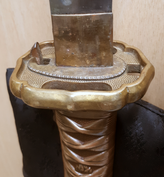

Conway S Posted April 13, 2024 Author Report Posted April 13, 2024 Also odd that there are two seppa on the front end of the tsuba. One is the correct style for NCO swords while the other appears to have a smooth edge. Conway Quote
vajo Posted April 15, 2024 Report Posted April 15, 2024 This seppa is on the wrong side. It must be on the habaki side. The smaller seppa is on the fuchi side. I think it is assambled false. 2 Quote
Conway S Posted April 19, 2024 Author Report Posted April 19, 2024 3 hours ago, DTM72 said: Sold for $2751 ! Yes I saw that too. The three seppa doesn't seem right...Praying hands emoji for the person that bought it. That's more than I would be pay for one, at least in that condition. Conway 1 Quote
