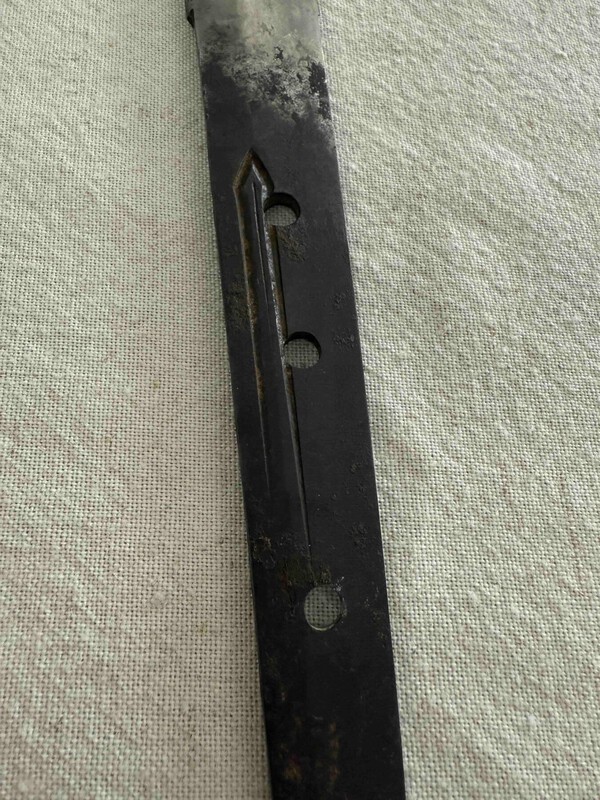

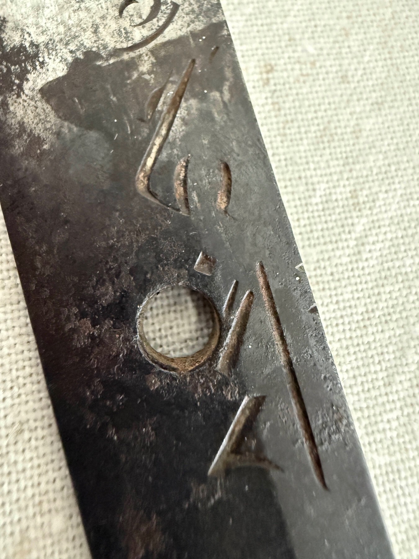

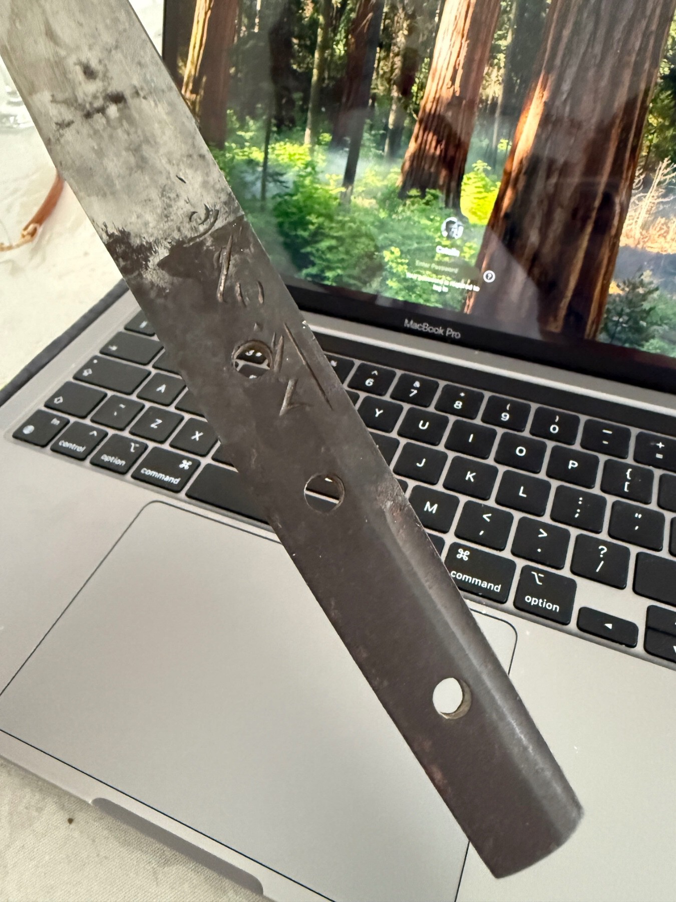

Catalin Posted April 22, 2025 Author Report Posted April 22, 2025 Any chance to identify what is written here ? Also, what do you think ca be this an original piece ? Thank you in advance of any opinion. Quote

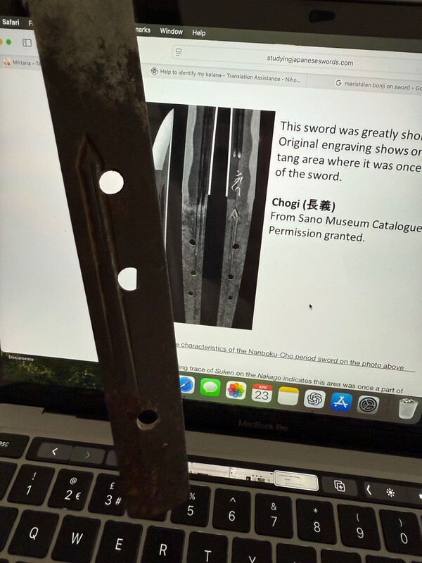

Geraint Posted April 22, 2025 Report Posted April 22, 2025 Dear Catalin. This appears to be a bonji horimono, have a look here and you might find it, https://swordsofjapan.com/nihonto-library/Japanese-bonji/ This would originally have been carved on the blade above the habaki and so its presence here suggest a sword which is suriage/shortened. The presence of two mekugi ana at his point suggests that it has been shortened quite a lot. A picture of the whole blade without the habaki might help us here. So far this looks like an original piece but the condition of the blade really matters so photographs please? All the best. 3 Quote

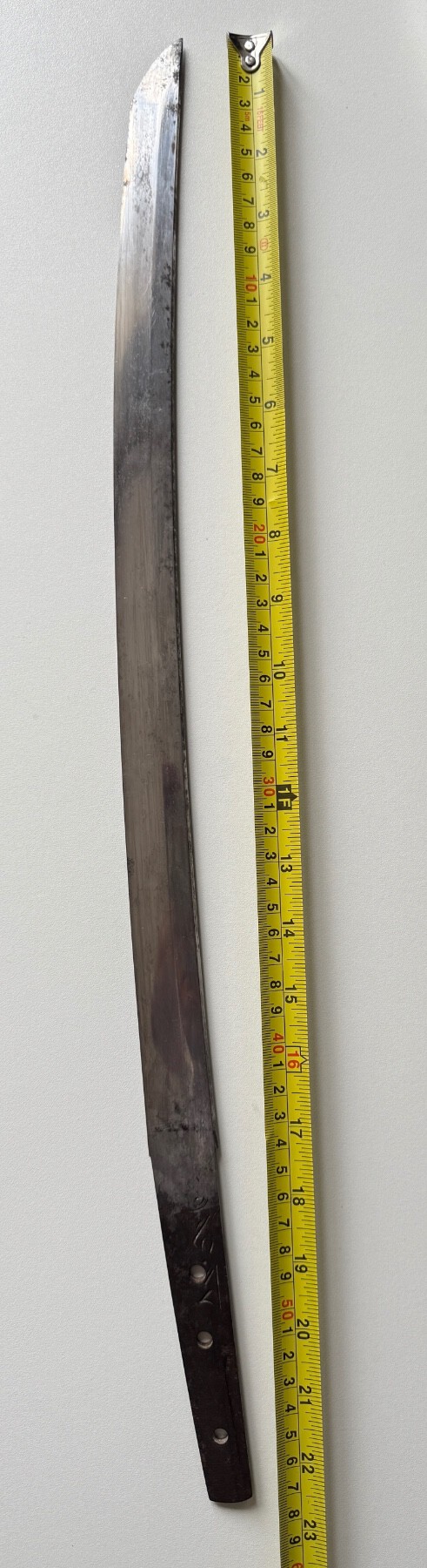

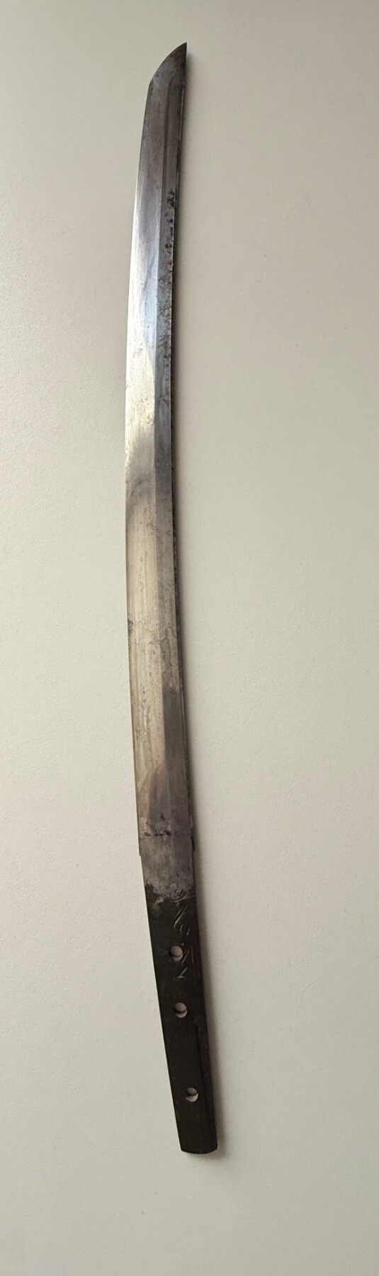

Catalin Posted April 23, 2025 Author Report Posted April 23, 2025 Dear Geriant, Thank you so much for your thoughtful reply and the valuable insights you’ve shared. The link you provided with the Sanskrit characters is incredibly helpful — although, as someone without much experience, I find it a bit challenging to match them precisely to the engravings on my sword. I’d really appreciate your opinion — which character do you think it most closely resembles? Interestingly, there’s a Suken engraved on the reverse side of the blade. Could this possibly indicate that the sword dates back to the Nanboku-Chō period? I’ve attached a few photos, taken as clearly as I could manage. The blade doesn’t seem to be in great condition, and I’m definitely considering restoration if it turns out to be a particularly special piece. It appears to have been significantly shortened — there are not just two, but three mekugi-ana, which is quite telling. I’d love to hear more thoughts — what do you think, which period might this sword be from? Quote

Scogg Posted April 23, 2025 Report Posted April 23, 2025 (edited) Hi Caitlin, I believe that you have a genuine Nihonto. Like you suggest, it appears to be o-suriage (greatly shortened). It's hard to put a date on your item, especially from photos. It's made even more difficult because it's been shortened, and the original shape has been lost to time. If you are interested in restoration, please keep in mind that it's a very expensive and long process. I would recommend finding a well respected and recommended TOGISHI to have a look at your sword, and help you determine if it's worth the price to restore or not. Unfortunately, I am in the USA and not the UK, and am unfamiliar with togishi over there. Maybe someone can chime in, and help. Best of luck, cool sword, and welcome to the forum! All the best, -Sam Edited April 23, 2025 by Scogg Edit: this is in reference to sword #2 with bonji 2 Quote
Brian Posted April 23, 2025 Report Posted April 23, 2025 Confusing matters by posting 2 different swords in this thread. The original sword is a repro. The second one looks to be a decent one. Swords with bonji and horimono on them, even if shortened until they are in the nakago, should be looked at more closely for quality, as it could be a decent sword. 2 Quote
Catalin Posted April 23, 2025 Author Report Posted April 23, 2025 Thanks everyone for your comments. Bit by bit, I’m starting to find some useful information, even a few blades with inscriptions that are somewhat similar. Unfortunately, it looks like someone may have tried polishing the sword at some point, because from what I'm seeing with the naked eyes the hamon is no longer visible. That said, despite not being professionally restored, the blade is still razor sharp. I gave it a quick test by running it lightly over the hair on my arm, and it actually shaved it clean off . Quote
ROKUJURO Posted April 23, 2025 Report Posted April 23, 2025 Catalin, even in this condition, any skin contact should be avoided with your blade. Don't test your sword! If it was mine, I would make the best photos possible and send them to a traditionally trained polisher to get a first assessment. In case the HAMON is really gone (by a fire), the blade has not much value left, but it may well be concealed by an improper treatment (when trying to polish it). 1 Quote
