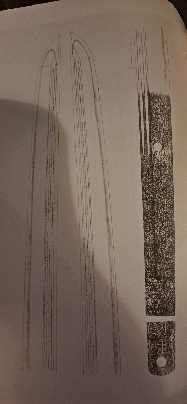

As I mentioned being extra careful in removing things, here is a heartbreaking example (I have read about other mei removals too but don't have picture documentation of them)
20231204_165137.thumb.jpg.523c4d7a08d49facc3f3906899135540.jpg20231204_165248.thumb.jpg.86697e8cb3c78de0f314b24cf4a3e665.jpg
This tachi by Enju Kunimura has had the signature removed (luckily the piece was preserved). It first passed Jūyō shinsa 22. Then mei was inserted as gaku-mei and it was updated in Jūyō 49 session. Then after that it has passed Tokubetsu Jūyō session 18. Now here is the fact that makes it so bad in my eyes, as I am bit obsessed in finding old work, I have so far found only 8 authenticated signed tachi by Enju Kunimura... Instead of highly precious historical tachi it is now "just a katana" instead, fortunately this has been documented and signature preserved as gaku-mei but in my eyes it is not nearly the same as it would have been preserved as a tachi.
As Mark asked about mei of original smith being added after shortening, there are examples but they are quite rare. Added mei in general is called kiritsuke-mei. There are also examples with to kiritsuke-mei ga aru, meaning the presence of kiritsuke-mei is noted but it's authencity is not yet 100%. For 100% authentic and where smith is noted this JūBi Kanemitsu is one that comes in my mind, it is famous sword Omachi Kanemitsu, it was shortened in 1442. It was owned by Uesugi Family and is now in private collection in Japan.
