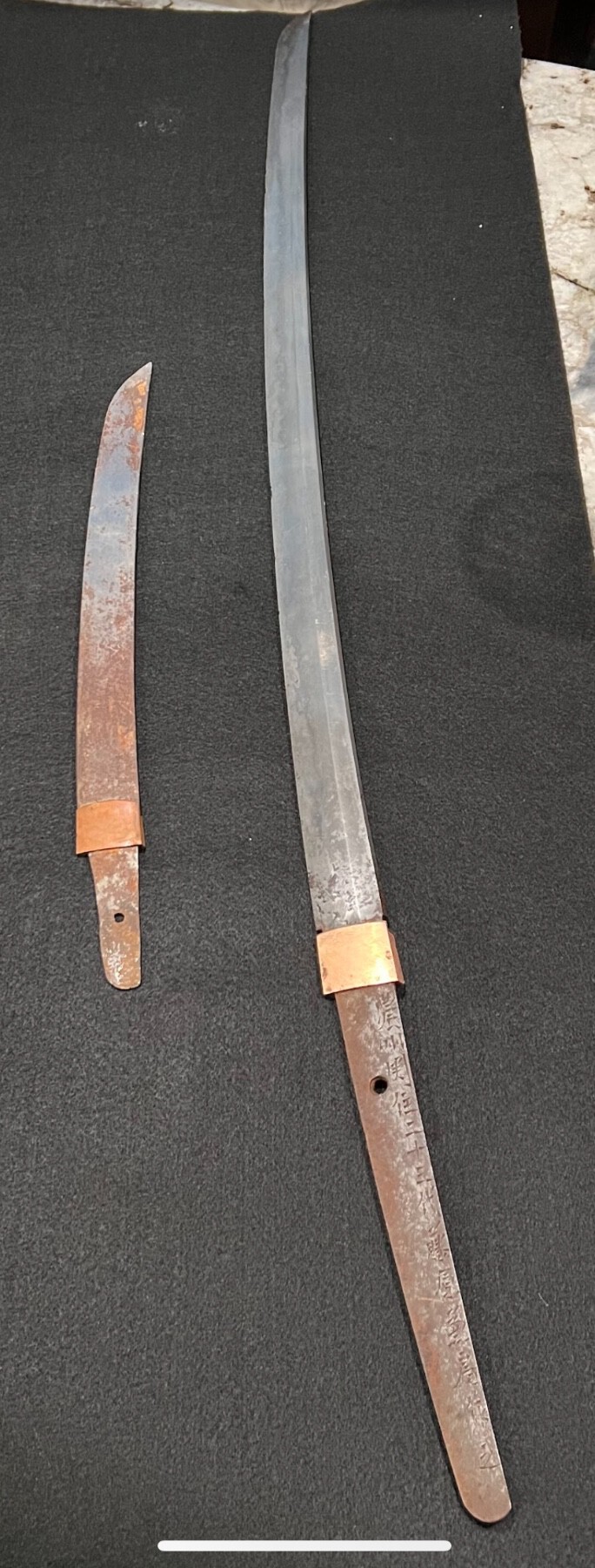

An old house out side of Artesia New Mexico, out in the desert, was to be bull dozed. Some relatives were  curious and went through the old house. They found these Items tucked away in a closet. Two Japanese's ink on silk paintings, a Katana and what looks like a small version of a sword. I said they looked cool and they said here you can have them. So now what. the best I have found is that the sword (kantana) is by Fujiwara Kanefusa 23rd generation. It is in what I think rough shape. I cleaned it the best I could without any strong abrasives and a wet sponge. The sword has a slight bend in it and the blade edge has what I would call bite marks in it from another edged weapon (maybe??). While giving it a basic cleaning, I thought about what history or stories it could tell...LOL..I became sentimental. Now I am wondering if I should have the blade restored or even if it could be,Picandswords.thumb.jpg.2bc5a60bfe53889c87ed6f988834af06.jpg who does it. I will attach pictures of the find in New Mexico. Please give opinions, they are free, Good advise tends to cost money.

Do no more cleaning of anything on either sword; well meaning amateurs often do damage. The short sword is a wakizashi. Pictures of both blades bare of their mounts, on a dark background, will allow us to tell you more about them. Coseups of both tangs (blade inside the handles) even if the wakizashi isn't signed, will help.

As to whether you should have it polished, that depends on your hobby budget and plans for the blade.  He was a WWII era smith that was known to make traditionally and non-traditionally crafted blades.  Without seeing some detailed photos, it's impossible for us to say what you have.  You'll pay over $2,000 for a polish, but since the sword cost you nothing, you could pay for a polish and have a really nice blade for an overall reasonable price.  If you still want recommendations for a polish, let us know, and guys can make recommendations.

a traditionally trained polisher (TOGISHI) can do a lot in case the blade's value warrants the costs. Your longer blade seems to be quite damaged indeed, but that was not done in war but probably much later by Western idiots.....In my opinion, this KATANA (not KANTANA) might have been traditionally made, so there is some hope.
The small blade has a bad NAKAGO (tang) and - judged only by photos - is likely a later tourist souvenir with not much value. Nevertheless, it might have been made pre-war, or even pre-1900. An expert could tell you more seeing these blades in hand. Perhaps you have an NMB member close nearby? A sword exhibition would be another possibility.
you are right on the small blade, it feels like a piece of sheet metal

To take a proper measure of sori (curvature), you should measure from the mune-machi (notch where the habaki sits on the transiton between the nakago and the mune of the blade) to the very tip of the boshi. The sori is probably around 1/2" just from a glance though.
The blade is a very standard size for a WWII-produced blade and may very well end up being gendaito (which could warrant a polish). Just based on what I am seeing, there is a good chance of that. So definitely find a token kai or collector near you for assistance!

If I was in your shoes, I'd not have the sword restored and just oil the blade to keep as a keepsake in your gun cabinet. Who knows and perhaps your lucky find may spur you to go deeper into the nihonto hobby. You may decide to even find and purchase a fine gendaito in very good condition like the ones here being sold on this forum. Years ago, while browsing one autumn morning a the local Goodwill Thrift Store I stumbled upon a genuine complete wakizashi with koshirae for $19.99.  That purchase spurred me into finding out about Japanese swords and I got some books about it and attended a local sword club meeting. My wakizashi was not worth the $2,000 polish and the long waiting for shipping to and fro to Japan for restoration. A year or two later my interest piqued high enough that I got my first katana, a piece that was once in the sword collection of a well known sword collector named Col. Dean Hartley. Congratulations on your lucky find.
