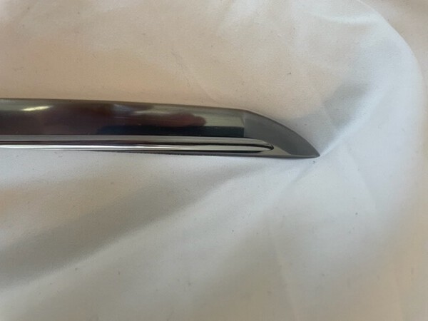

Saint-Just Posted September 29, 2023 Report Posted September 29, 2023 Dear New Friends, I am new to this forum. After long waiting and saving, I bought a Ko Naminohira Tachi. The Sayagaki (from 1952) says: Hogen- era (late Heian, 1156). So say the sellers - both in Japan and here in Holland. Other people with knowledge maintain, though, the Tachi (which has one almost unreadable 'An' character near the peg hole) is of later date: Kamakura. Not necessarily based on the nakago - in the National Museum in Tokio there are a few Heian tachi's who don't have the characteristic Heian 'Pheasant Leg' but a nakago similar as mine ('chestnut') The Tachi is ubi, 77 cm cutting egde, 99 cm in total, has a relatively low waist - but you please judge it yourself - and weights a little 623 grams. It has its Tokobetsu Hozon and is judged als Jidda: Hogen in 1952. Is there anyone who is at home with the newest insights? For details, please see: https://kyodaiorigin...satsuma-by-yasuyuki/ Many thanks, robert 8 Quote
Ray Singer Posted September 29, 2023 Report Posted September 29, 2023 Hi Robert, you may know already but the NBTHK papers themselves just indicate that there is an unreadable mei. Unlike the previous posting for the Narishige, where there was enough of a kanji remnant to determine its reading, in this case they did not find the mei to be readable at all. 5 Quote
Jussi Ekholm Posted September 29, 2023 Report Posted September 29, 2023 Congratulations on a fine sword. I remember eyeing at the Japanese dealer but it was way above my level of collecting. I do have it saved as Kamakura period work in my files. Unfortunately I am not a home during this weekend so I don't have access to all of my data. Ko-Naminohira attribution spans from late Heian into late Nanbokucho period. Late Heian - early Kamakura Ko-Naminohira work is very rare (as so early swords usually are). The Japanese dealer who had it online is often quite optimistic in age attributions. Also I believe the sayagaki would be by Honami Nisshū (本阿弥日洲) and to me the date would be Heisei 2 (平成二) 1990. I am bit curious who told 1952 to you? I am not well versed in Nisshū sayagaki but I would compare it to other examples. You do have very nice tachi and I hope you will enjoy it. I can write better post next week when I am at home. I have c. 100 Ko-Naminohira swords recorded so I think I can dig up few similarish ones. 11 2 Quote
Saint-Just Posted September 29, 2023 Author Report Posted September 29, 2023 Thank you RAY SINGER, thank you Jussi Ekholm. I am new on fora and quite a digibete, so I hoop this message is reaching you. Yes, Ray, google translate told me the mei is unreadable. The original seller says it is the character An - and makes some far-going conclusions about that. I am just happy there IS a mei, on the right Tachi site :-) Hi Jussi. So you saw the blade. It was - and actually is - quote on top of what I could afford. But it came to Holland last year and I simply fell in love with it. I suspected the Japanese dealer has been quite optimistic in age attributions - but only after I did put the sword on hold. With Kamakura, perhaps I can live - the sword has a great size, a great elegance and seems very healthy to me. Late Nambuchoko periode would be unacceptable - and then I really should ask the dealer to reverse the sale. (I already HAVE a Nambuchuko katana). No hurry, but would you have a look in your files? I would be much obliged. It could be very well the sayagaki is from 1990. At the Tokubetsu Hozen paper one reads the blade is registraties May 1 1952 - so I simply thought the sayagaki would date from the same time. Mr. Honami Nisshu - according to my google translate camera - writes on the saya: Hogen-era. Now we must know of Mr. Nisshu has some authority. Really looking forward to your reply - take your time. Warm regards from Amsterdam, robert robertdulmers@gmail.com Quote
Gakusee Posted September 29, 2023 Report Posted September 29, 2023 This is clearly Nisshu sayagaki - his calligraphy is my favourite among the sayagaki writers. What I cannot understand is why he is mentioning something like Juyo Bunkazai at the bottom of the sayagaki next to his signature. Jussi has made the appropriate comments. This is an old blade and sometimes it is not clear what is late Heian and what is early Kamakura. Here the sugata is consistent with “no later than early Kamakura” assessment. I would recommend that you go with the ToHo certificate evaluation. The Nisshu sayagaki attributes it to Yukiyasu. THE Yukiyasu was the son of the Naminohira school founder and a famous and respected smith. He has various top level blades. Several generations bore that name however. So, unless there is further attribution to a specific period, one can probably assume Nisshu thought highly of the blade and could have attributed it to the shodai. I recommend that you pay for the services of someone fluent in Japanese like Markus or Steve to have the sayagaki properly translated. Read about the Naminohira school and Honami Nisshu, look at your blade and compare it to published and signed examples. Draw your own conclusions now that you have two attributions. Also, if you find somewhere to X-Ray the tang, it might reveal more of a signature. This has been done before. And in facf, just for fun, I attach images of the same Ko-Naminohira Yukiyasu with two Juyo papers. The earlier one only describes it as mumei Ko-Naminohira. Around 20 years later it was resubmitted and somehow they deciphered the mei or it had been scanned / X-rayed and now the signature had been partially read. 7 1 1 Quote
Saint-Just Posted September 29, 2023 Author Report Posted September 29, 2023 Hi Gakusee. Thank you for your insight. Nice to hear mr. Nisshu has a solid reputation. Yes: My google translate camera picked also up Important Cultural Property. And I was puzzled. It is a beautiful tachi, ubi and of goog health and perfect dimensions.... But do you think the sugata is consistent 'with no later than early Kamakura' assessment? Is that your profound assessment or is it written somewhere on the saya? In other words: no fears it will be ... Nambuchuko? (I can judge that a little in the main Yamato streams, in Bizen but not in a province as far as Satsuma - where perhaps swordsmits did not follow the most actual trends? Although thinking buying a late Heian: with an early Kamakura I can live. With a Nambuchuko I can not (I already have a katana from that era). By the way: my 3 swords, the ubi Tachi, the o-suriage Den Ryumon katana and the Mihara wakizashi - all Yamato-style - give a good insight in the development of the Nihonto - and I plan to donate the set in a few years to the Amsterdam Rijksmuseum (which does not have any proper blade). Nor much knowledge on Nihonto. So you think it is not later than early Kamakura? That would be perfect. Thank you. Warm regards from Amsterdam. robert 6 1 Quote

Rivkin Posted September 30, 2023 Report Posted September 30, 2023 Don't know where it goes, but: ko versus sue are specifically introduced to avoid any controversy related to when the school first appeared. There is no certainty in regards to what is the earliest Naminohira blade (there is a dated example but...), and in principle only Senjuin (Mogusa?) and Sanjo (and related) schools more or less certainly were present in the Heian period, the rest borders between "likely" and "not likely". Nishu's sayagaki are seldom associated with the top blades, though there are some. Dr. Honma has been the golden standard and I have not seen a sayagaki of his that has been challenged. That's been the status from the beginning, and he is the founder of the modern sword appraisal and mofrtn understanding of smith's genealogies. Kanzan Sato wrote a lot of sayagaki and I would estimate 5-10% of those have been successfully challenged in modern papers, especially those written in 1974-1976 (by memory). There are various explanations, some say they are faked often (and they are), but then in most cases they are also green papers issued by the head office with the same judgement. Honami Nishu was considered third choice compared to these two gentlemen and the last option for those not satisfied with other opinions. I probably have two dozen photographs of his writing with the NBTHK differing greatly. Lots of Ichimonji classified into Ishido, Hosho into Sendai etc. With each blade I've seen NBTHK position was easy to understand. 5 1 Quote
Saint-Just Posted September 30, 2023 Author Report Posted September 30, 2023 Good morning all! Dear GAKUSEE: thank you for your encouraging words. I will get into it: Mr. Nisshu and the possibility of X-ray. Markus Sesko I already emailed - and I am waiting for his reply? Who is this Peter you are talking about? Thank you for the scan of the Juyo papers. For my blade, please see the pictures below (cannot upload them in a higher resolution). Dear STEPHAN, GREY, BRIAN,: thanks to you too! Grey makes a point. The Rijksmuseum, for over 200 years depending of gifts by the public and government money to buy the Rembrandts, happens to have no collection of Nihonto, except from some rusty Edo-swords taking by the Dutch from the island of Decima in the 1600's. They do rank in the top-10 of the worlds greatest museums (along with the Louvre, the British Museum, The Met etc), they have a huge department for conservation, and both the General Director and the head curator of Asiatica will accept my swords on the condition they will be on display. As did they do with some other artefact I transfer to them. I see Menno, the head curator one of the coming weeks, so I will surely take up the matter of conservation with him. Thanks for pointing this out to me. But a museum as the Rijks, with its Rembrandts, its Vermeers, its great collection of mediaval textiles etc must be able to attract the right staff and knowledge. I will keep a close watch though. Dear RIVKIN: I begin to realize that appraisal is a science as such and a matter of permanent deliberation. Rather than sticking to what the sasaya reads, I turned to this forum and wrote an email to Markus Sesko - the Sword has to be judged, more than just the sayagaki. Many thanks to all of you for your input ! robert 1 1 Quote

Saint-Just Posted September 30, 2023 Author Report Posted September 30, 2023 IMPORTANT! Respons of Markus Sesko :-) He asked me to share it with you: Dear Mr. Dulmers, I had a chance to look at the thread on NMB. First, I can confirm that the sayagaki by Hon’ami Nisshū is indeed from 1990. His direct attribution to Naminohira Yukiyasu is where the confusion starts, if you will. The problem with Japanese sword attributions is that they are objects-based on the one hand, and based on period records on the other hand, with the latter often overweighing the former. That is, Nisshū coming to the conclusion that the blade was a work of Yukiyasu, he so to speak “had” to quote the accumulative period lists of swordsmiths (referred to as meikan), which state that the smith was active around Hōgen. We find several later Yukiyasu smiths in the same meikan, one, e.g., as having been active around Bun’ei (1264–1275), which means that Nisshū regarded the blade as going back to the hand of the earlier Yukiyasu and not to him. In other words, Nisshū can not pick Yukiyasu and then opt, for example, for an era from the 1230s. He is traditionally bound to either pick Hōgen or Bun’ei, or a later era. Another difficulty lies within the fact that there were different lineages of appraising swords, e.g., Hon’ami vs. institutions like the NBTHK or NTHK, which slightly (or greatly in some cases) differ in their approach. Institutions have become more conservative over the years (partly connected to liabilities, partly to changes in leadership, experts panels, etc.) and are often not comfortable to nail down an attribution to a single smith (if there are just not enough individual characteristics to say this with some certainty). Thus, judging the blade in quesion as an “early Naminohira work”(which would be the literal translation of Ko-Naminohira) is a sensitive approach. With this, however, we are facing another difficulty, which is that the NBTHK often does not specify further on the Hozon or Tokubetsu-Hozon appraisal level. Again, there are times when they were, and it seems that they are returning to this practice a bit in more recent years when we see supplements in parentheses like “late Kamakura,” “early Muromachi,” “end of Nanbokuchō to early Muromachi,” etc. Looking at the pictures of the blade and the description of the seller, it is with a motohaba of 3.2 cm (if this is correct) on the wider side for Ko-Naminohira. I quickly checked some of my references and most of such wide Ko-Naminohira blades were dated by the NBTHK to the end of the Kamakura period. That said, what I would like to see, if possible, is a shot from top of the area of the blade transitioning to the tang (without habaki) (like the picture attached). I would like to see how thin it is and how much material it has lost due over time due to polishing. I will go into more specifics about dating after that. I will elaborate more on the museum/collector issue shortly. Best regards, Markus 6 1 Quote
