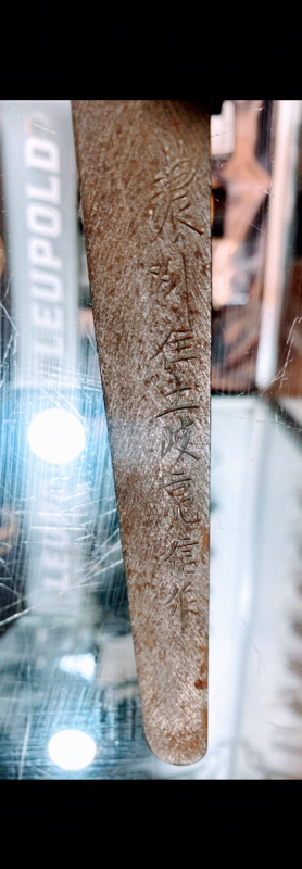

xiayang Posted March 20, 2023 Report Posted March 20, 2023 It's a WW2 blade. 濃州住土岐亮信作 = Nōshū-jū Toki Akinobu saku (made by Toki Akinobu from Nōshū province) 3 1 Quote
Stephen Posted March 20, 2023 Report Posted March 20, 2023 Austin I see you got your translation. In the future make sure phots have tang end down. Quote
mecox Posted March 20, 2023 Report Posted March 20, 2023 Jan is correct, but 亮信 in this case is read as Sukenobu not Akinobu. Family name is Toki. There were two brothers Sukenobu and Kanemasa making swords in WW2. Family background and examples here: 5 2 Quote

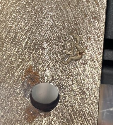

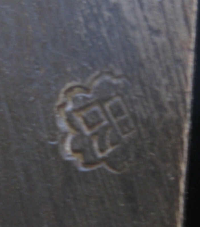

John C Posted March 20, 2023 Report Posted March 20, 2023 Austin: Some additional info about the blade. The small stamp looks like a Gifu stamp, which would be correct for an Army WW2 blade. The white painted numbers (3, ?, 6, 1) on the tang are assembly numbers and may or may not match the numbers on the rest of the parts (46 in your case). It is good that all of those parts have the same number. The handle, however, looks like it has been recently re-wrapped. Difficult to say without better pics of it. And not sure, but the hamon looks like a classic oil quench to me. This all adds up to a standard Showato from WW2. Probably a type 94 or 98. It would have been carried by an officer. John C. 1 Quote

Bruce Pennington Posted March 22, 2023 Report Posted March 22, 2023 Austin, For those of us who collect WWII gunto, they ALL hold historical value. I do not follow the smiths, but the price of a WWII gunto can be higher if the blade was made by a popular smith, like Emura or Mantetsu (ok not a "smith"), I don't know where Sukenobu falls in that category, @mecox might have a feel for that. Average WWII gunto pricing is a bit wobbly in the market right now, but they are traditionally in the $900-1,400 range. Variation mostly depends upon the condition of the gunto. You don't show the fittings, and that can affect price. To my novice - grasshoppa' eyes, I'd say this is showato (non-traditionally made) and the stamp is the Showa stamp. The blade is a nice one with a good looking hamon and the bohi is popular with some collectors. Assuming the fittings are nice, it would easily sell above the 1,000 mark. Showa comparison: 2 Quote
