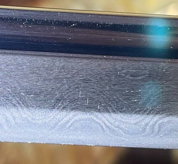

Bryce Posted September 11, 2022 Report Posted September 11, 2022 G'day Guys, Here is a basic question for you. What is it that causes nie to form in some layers, but not others? In this Gassan example what are the likely differences between the two steels that form the contrast in the ayasugi hada? Cheers, Bryce 2 Quote

Jacques Posted September 11, 2022 Report Posted September 11, 2022 3 hours ago, Bryce said: G'day Guys, Here is a basic question for you. What is it that causes nie to form in some layers, but not others? In this Gassan example what are the likely differences between the two steels that form the contrast in the ayasugi hada? Cheers, Bryce Nie are martensite particules you will find them in steel with a high carbon content https://en.wikipedia.org/wiki/Martensite 1 Quote
