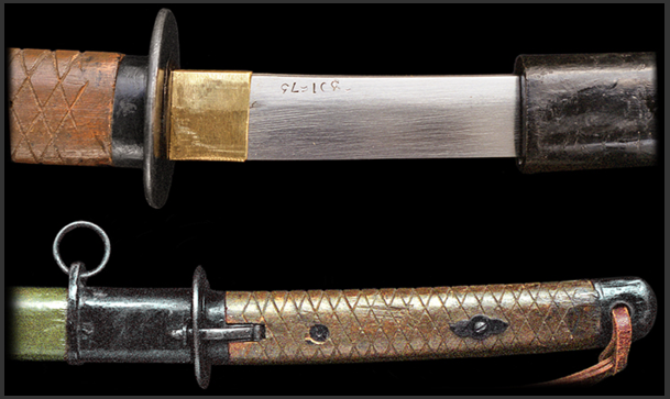

Misconstrued Posted June 20, 2022 Report Posted June 20, 2022 As these are decently rare guntos, here's a study piece for your eyes! Its made by Jinsen Arsenal. (Sorry for the bad lighting, these are the only decent photos I have of now.) Story: My Great Grandfather picked this Gunto off a deceased Japanese Officer and took it home with him. 4 Quote

Shamsy Posted June 20, 2022 Report Posted June 20, 2022 Lovely and completely genuine pattern 6 Type 95. They are quite rare, so nice to have one in such great condition. Could you please take a close up of the serial numbers and stamps and try to get good light and focus? The combination of lines and circle has different meanings as to what the blade was intended to be used for. Can't quite see what the mark before the numbers is... 1 2 Quote

vajo Posted June 20, 2022 Report Posted June 20, 2022 This one is from the Ohmura study site. Same style stamped numbers. I think its time for me to search for a late pattern 6 NCO to have one in hand. 3 Quote

Shamsy Posted June 21, 2022 Report Posted June 21, 2022 52 minutes ago, robinalexander said: @Misconstrued Hi Jace, out of interest it would be good to know if the saya throat is numbered? It won't be numbered on the saya. It is the pattern 6 which had a wooden scabbard with unstamped, sheet-metal throat. They start at 300,000 serial range and are stamped on the blade. Best you'll likely find for stamps on the saya are the little, inverted ticks, as with the blade (that's what is after the number, thanks Bruce for the better pic). Just to confuse things, I have seen ONE single pattern 6 with a numbered throat before. But I didn't buy it so never got a good look). What you have posted, Rob, is the far more common pattern 5 with metal scabbard. Here are comparison pictures from Ohmura. 2 3 Quote
