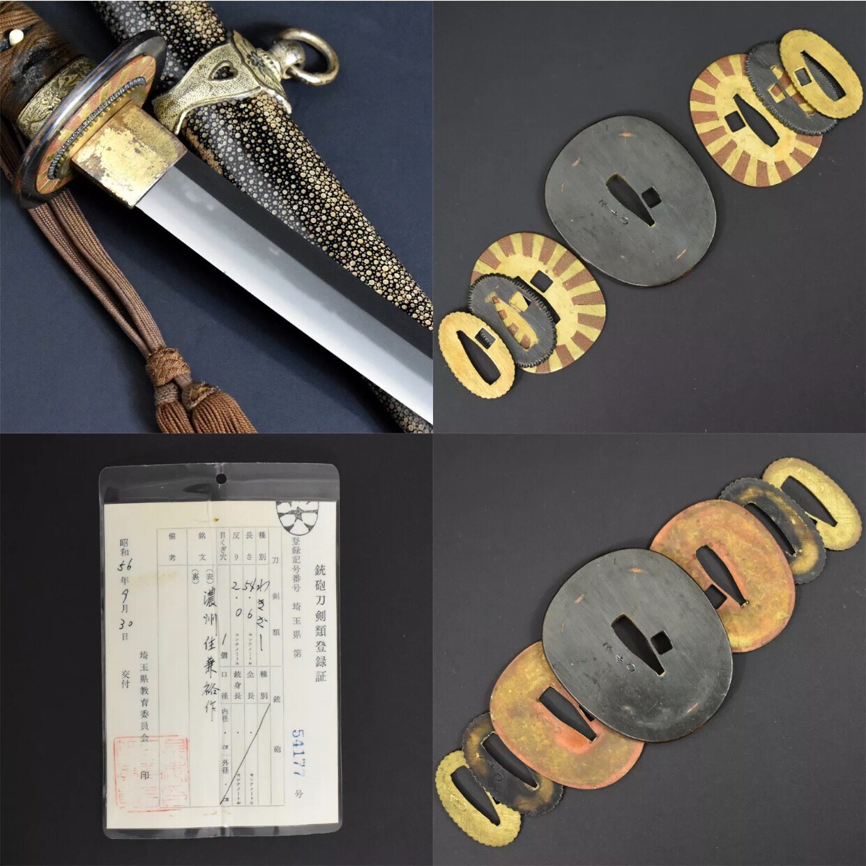

Swords Posted March 25, 2022 Report Posted March 25, 2022 Can any one tell me about this sword the hamon looks too straight to me Quote

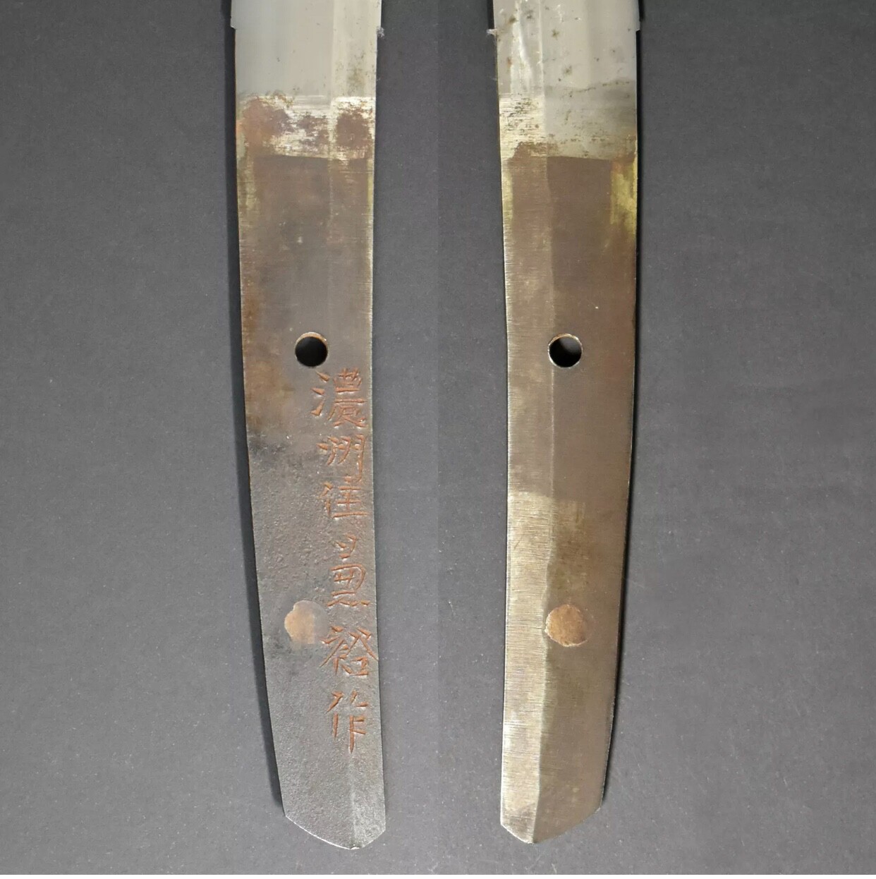

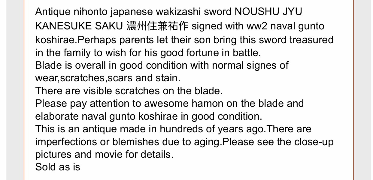

Geraint Posted March 25, 2022 Report Posted March 25, 2022 Dear Steve. Well it's a nice package, good condition Kai gunto with the better lacquered same saya. The seller calls it a wakizashi so we will have to take his word on that. Not sure how much you know about Japanese swords so please forgive me if I state the obvious. Straight hamon,known as suguha, is relatively common. In Mino swords it is often accompanied by fushi or thickets, little protrusions above the habuchi, almost as if the smith can't quite get sambonsugi out of his system even when doing suguha. However, the pictures don't show enough to base any opinion on. The seller describes it as awesome, that might be because he's a fan of suguha. It might also be that the hamon is masked by a heavy hadori, which would account for the width. I would guess that some of the work on the nakago was done when the sword was mounted in this koshirae. So what you have is an unpapered wakizashi with a hamon that you can't see, coming out of Japan in very nice Kaigunto mounts. Hope that helps a little. All the best. Quote
Brian Posted March 25, 2022 Report Posted March 25, 2022 You're not seeing a hamon. Tang patina looks fake as hell. Stainless? Quote
Nobody Posted March 25, 2022 Report Posted March 25, 2022 The smith name is not Kanesuke (兼祐) but Kanehiro (兼裕). 3 1 Quote
