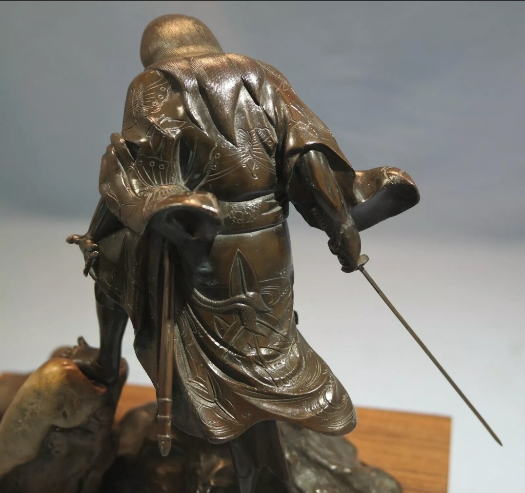

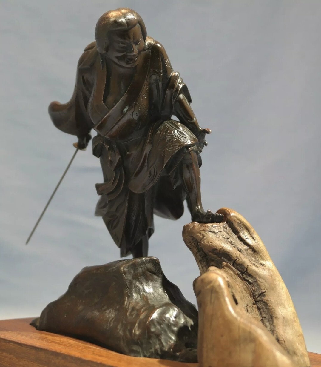

Was wondering if I could get opinions on this piece.
Perhaps there is a fable/character this possibly portrays?  How does the quality of work appear for those with trained eyes on such things?  Where would a signature usually be on these or does that just depend on artist?   Is wood and bronze integration something traditionally done by Japanese artists or could it be a later addition?  Also wonder if anyone has seen this statue before?
Lastly, hate to ask, but what is a potential fair value range for Meiji Bronze such as this (assume it is unsigned)?  Have an ebay offer on this, love it's look but have truly no idea on these bronze markets.
I think it may be demon related. Really not sure. But it is a quality item. I've been looking at a lot of them lately online, and most look good at first until you look closer. But this one has quality in the details and I don't think this is a cheaper one.
Don't know here it would be signed or if....but it's something I would like to own. Not top level by any means, but not the mass produced junk either. I'm not qualified to give values, but pure guess would be in the late 100's....around $1000 maybe?
Cheap ones seem to be $2-400...
Stephen, I get it, not for everyone.  For me however depict some historical mythology and I'm all about it.  Hoping I can find out if this does depict some known tale of an oni or possessed samurai perhaps.
Brian, thanks, that helps as I honestly have no comparison for quality and values.  I can see what sellers are asking for things but not what people are actually paying.  I got it for less than $600 so maybe did fine if I ever did need to sell it.  Just didn't want to largely over pay.
It (the guy) was cast as one piece.
I believe he is a demon possessed man.
Some good work was put into it.
Definitely like Brain said ....not your cheap typical tourist piece and I'm almost willing to bet it's one of a kind.
There may be another figure with similarities but the mount and wood/stone or bone( looks to be petrified wood or a tusk) he is resting on is all custom.

Agree with Malcolm on both posts. Like to see that join closer. Malcolm, do you think it was mounted to something else at some point, or maybe a join repair?
The joking aside, the expression is a Japanese aesthetic, used to convey how fierce they could be. I like it as a whole though. 85% of the stuff you will see on eBay is inferior.
Brian, ha! I dub this statue Oshikuru or Brian for short.
Baka Gaijin (nice name btw)  it does look like those masks and the transformation aspect could match what this statue could be about.  I'll take close up pictures once I have the statue in hand.  That base and that wood piece his foot rests on could have been added later.

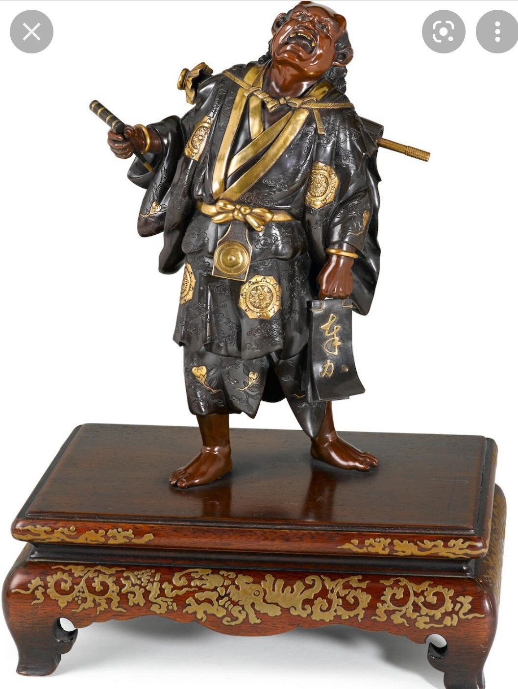

When it comes to Meiji okimono, there is a huge difference in the one-off and low number top class work you are referring to, and the export type pieces we are talking about.
Even among these "tourist" type export pieces, there are huge differences in quality. If we exclude the top works and are only discussing the sub-$1500 works that are more commonly seen, we need to be able to differentiate between the low detail mass produced items and those that were also more mass produced, but have more detail, unique subjects and less interest.
We mostly all know about the common advice to "check the toes" for detail. But there is an element of truth to that. I don't have time now, but am sure it would be easy to pull up details of the entry level works vs those slightly better. This isn't by any means a top quality work, but it isn't one of the $200 "tiger attacking an X" pieces we see so often.
I dont know much about these but judging from what ive looked at over the years i would expect folk to ask between $400 to $650 for it.
Its ok, but when i see these statues where the sword is out and with this kind of pose it kind of puts me off and reminds me of later stuff.
Seen similar in the past and when you scour the internet you find identical pieces at varying prices, sometimes low, sometimes high.
Be better if was signed but then again the price would likely be sky high.
Base looks cheap (which might suggest ?), would replace it with a nice granite piece if i owned it, find them for sale quite cheap.
Wish i was educated on these lol, as always wanted a nice example.

Hopefully just a bolt in the bottom and not glued.
I got one,  black marble (not granite) base from a trophy shop lol, they made me one to suit, long time ago but was only £15.
Will look so much better without the wood,

I'm guessing the example above sold or is estimated at around $30k.

Mark, almost right on the money.  Looked it up and that oni bronze from bonhams sold for $35k after fees.
Thank you for checking Adam.
$35k including Bonhams buyer's premium, by my mental arithmetic, would put the hammer price at a hair under $28k.
