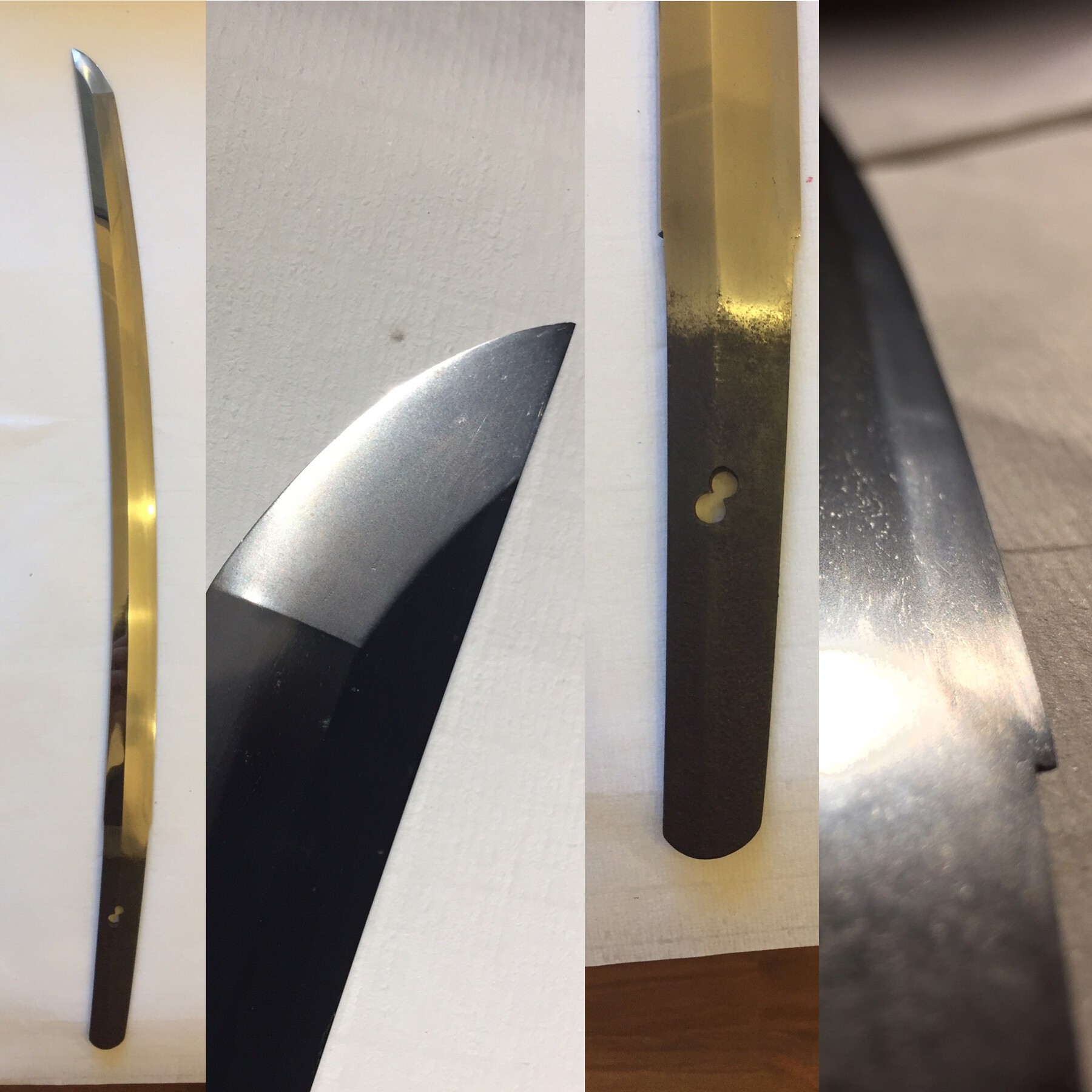

DoTanuki yokai Posted July 28, 2021 Report Posted July 28, 2021 Hi, nice blade, I think there is no signature on the tang because the blade is shortened. The blade is from mino province and maybe from the late Muromachi - early edo period. The hamon pattern looks like sanbonsugi but I would like to see more pictures Pictures of the whole naked blade and the tang. Also a close up picture of where the hamon starts and what it looks like in the tip. Thanks Edit: I added pictures that show what we need to see (not the best ones but That’s what I have on my phone now). Play a little with the lightning, it’s not easy to photograph nihonto. 1 Quote
Snuggs Posted July 31, 2021 Author Report Posted July 31, 2021 Sorry I was out of town for a few days. I removed the tsuka and took some more pics. The hamon pics were hard to get at the beginning of the blade. It seems like the hamon starts about 3in above where the blade starts. Quote
