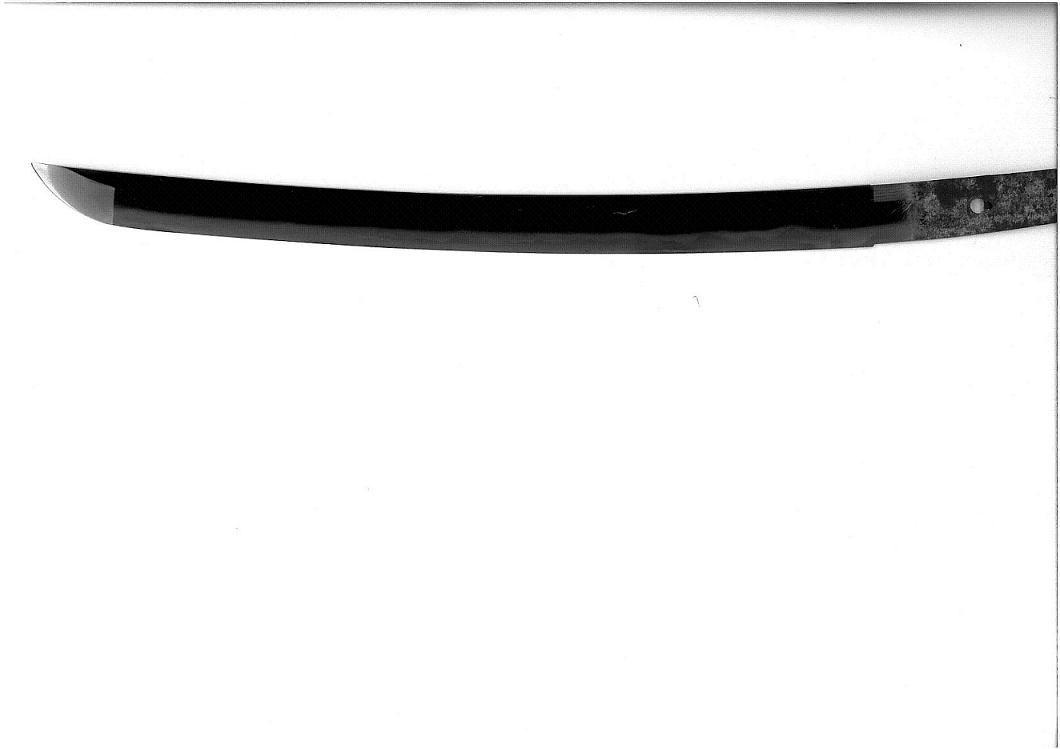

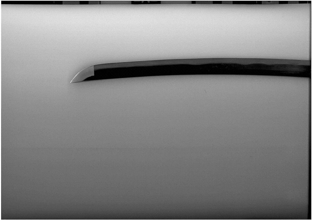

Justin Posted December 12, 2008 Report Posted December 12, 2008 Unfortunately, I don't have much. One photo, two scans and some images of the NTHK certificate (all poor quality). The certificate says: Front: Kanteisho Den Hosokawa Masachika Shoshin - Nagasa Isshaku Issub Kore ga ari ( The length is 1 Shaku, 1 Sun ) Date - Hansei Junu-Nen Ni-gatsu Juni-hi 11/02/2007 Nihon Token Hozon Kai (In Seal) Back: Dai: Ichi Roku Ni San Goju Go Meibun: (signature) Mumei Kitae: Itame Hamon: Gunome Midare Boshi: Midare Komu Hakeru Nakago: Mekugi ana: Is Yasurime: Kattesagari Biko: Musashi Kuni, Keio ? Probably not much help, but you might find something in there. As someone mentioned above, Henry Wilson has done a good write up about the history of this smith and included a nice oshigata of a Masachika tanto he owns/owned. It would be great to see some photos of your blade if you have them (I'm a bit of a fan of this school). I have a naginata by Suishinshi Masatsugu (Masahide's grandson) and a wakizashi by Ryusaishi Masashige (a pupil of Masahide). Quote
huntershooter Posted December 12, 2008 Author Report Posted December 12, 2008 Thank you Justin. Interesting that the "chika" kanji on your origami is different from the "chika" kanji on the NTHK paper with this blade (mumei). Apparently he (MasaChika) did use both kanji at different times. The blade is currently out of polish with little to no activity apparent. Perhaps by the time I have it polished I will be able to take and submit photos (afraid I'm a bit of a computer moron. Old school, resitant to change and all). Quote
