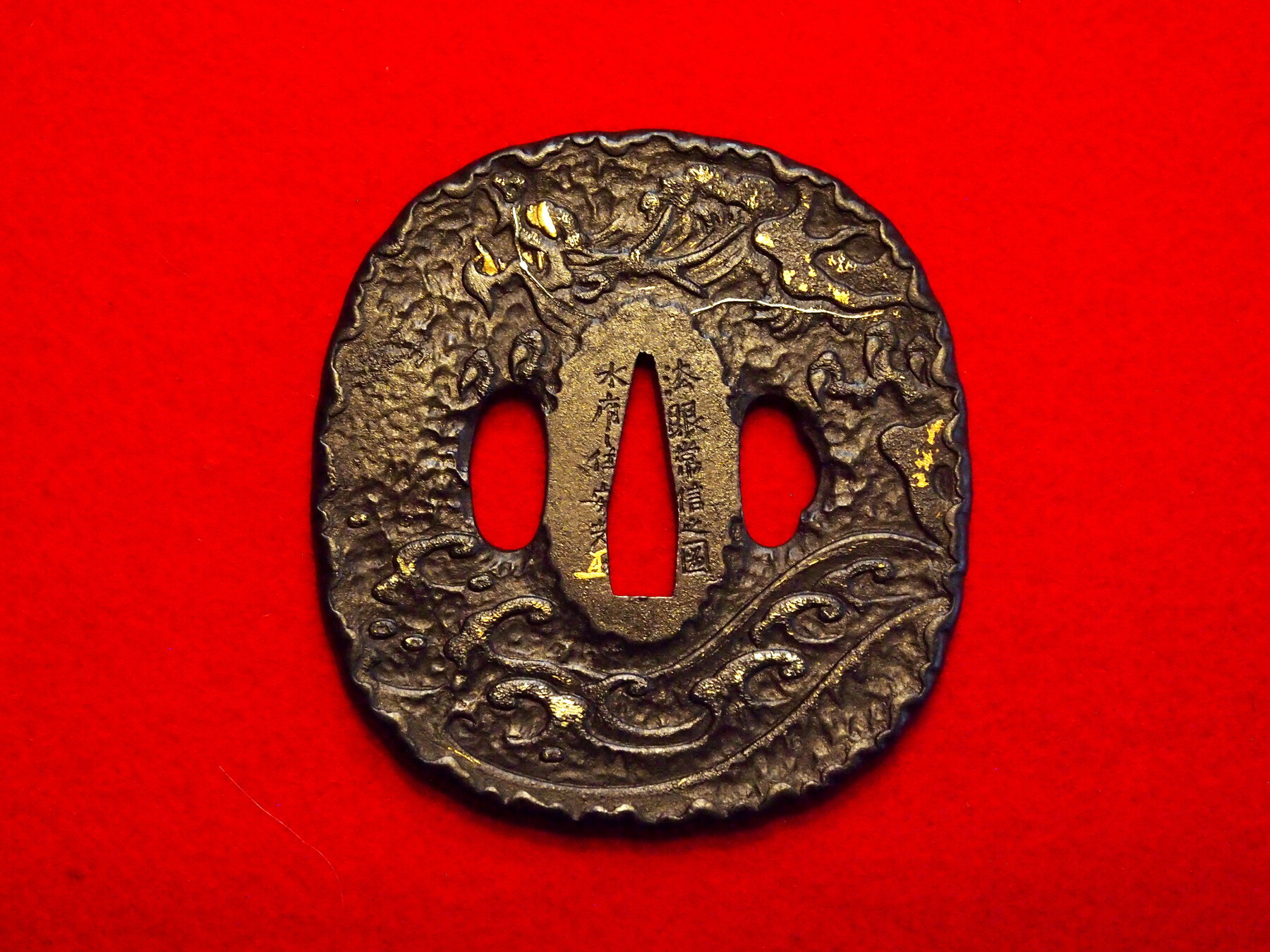

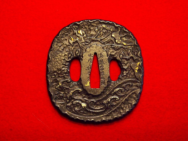

I totally understand where you guys are getting that view. I think the mei looks like a cast or imprint too. However it does have NBTHK Hozon papers (attributing to a Yasumitsu? But I believe there is 2 signatures on this tsuba and a collab work). Here's the full tsuba omote:

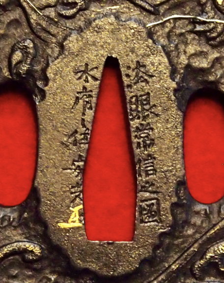

Tony,
there are many different techniques for surface treatment, so we may be fooled just by the looks.
I think I can see remains of YASU on the left side of the NAKAGO-ANA, but I don't see MITSU.
I guess you have it already Tony. If not, here my first try...
Right side: “㳒眼常信之図“ (first two possibly 法眼 = Hōgen)
Left side: “水市住安光” ?
But have still my doubts!
Thank you! I was wondering if this was truly a collaboration work between 2 smiths. I know one for sure is a Smith Yasumitsu from the Mito school, but the other one TSUNENOBU from Tanaka school?
No, just the work of Yasumitsu. I don't quite understand why the other name says Nobutsune no kuni. If I hadn't see the dealer's site, I might have also said the last kanji on the right side is 図 (zu - illustration) like Uwe. In any case, my guess it that it points to an inspiration - an original work from Nobumitsu that Yasumitsu is copying, or some effect Yasumitsu is trying to replicate.
Hmm, two wrong... :-?
Anyway, “水府” (suifu) is pointing to Mito (thanks Steve!!!) and “法眼常信” (Hōgen Tsunenobu)....couldn’t find him.
Steve, can we interpret “之図” as “圖”? “no kuni” makes no sense, I think!?
No, its supposed to be 国 (or any of the other million variations).
However, according to this site I just found today, it is a name (Yukikuni), and the work in question is indeed a gassaku.  Wakayama doesn't list this the name Yukikuni
(之国) under any of the four possible "Tsunenobu" entries, but according to this dealer it is supposed to be a name of Fujiwara Tsunenobu, a late Edo artist along with Yasumitsu. I guess this is validated by the authentication paper, but it seems slightly unusual to not find the mei in Wakayama.
http://aoyamafudo.co.jp/product/1630/
I think that the inscription on the right is “法眼常信之圖 (Hogen Tunenobu no zu)” as Uwe says. That means its theme was inspired by Hogen Tunenobu’s painting.
Ref. Tunenobu; Kanō Tsunenobu - Wikipedia
I suspect that the shop’s description which Steve refers is a misunderstanding.
There is a similar pattern of Yasumitsu’s mei on a tsuba inspired by Hogen Buncho no zu.
法眼文晁之圖, 水府住安光作
日本刀 猿猴捉月図鍔 法眼文晁之図 水府之住安光作 武龍斉|日本刀 刀剣販売 e-sword【イー・ソード】 (e-sword.jp)
  • Like 4
法眼文晁之圖, 水府住安光作
Wow, you just blew my mind. That  would make soo much sense! Kano Tsunenobu was an extremely famous painter early Edo period and that attribution just fits.
