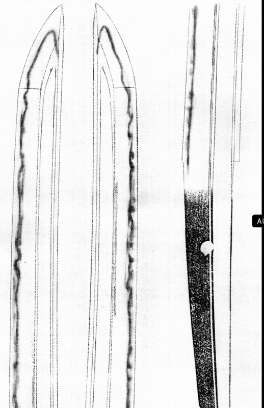

Now, there are various early Kamakura blades with o-kissaki but these are rare. Jussi’s blade might have a big kissaki, simply because it is a gigantic blade, but that does not make it o-kissaki (which is about proportionality).
Attached are examples: Yamato Kaneuji and Miike, dating to 1230-1250 roughly.

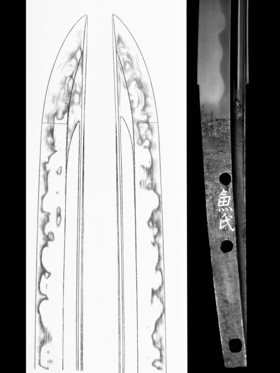

Yes, John, you are of course right and I mislabelled the Kaneuji, which is a later blade.
But the Miike example still stands.
Another interesting one is this special order Fukuoka Ichimonji Yoshifusa (he worked roughly 1230-1260, or along these lines) - see below.
I think this is your best bet of a “ signed and dated” example. Yoshifusa did not date his works but signed them.  Extremely valuable and pricy swords. We are lucky the mei was retained on this example.
So, apart from this Yoshifusa and Katayama Ichimonji converted blades (presumably originally nagamaki or naginata), I have not been able to trace too many other early examples.I have been able to find some generic Ichimonji blades (not attributed to a school), probably 4-5, and some Yoshioka blades too - another 4-5, in the Juyo volumes.  As we move towards the end of 13 century, 1280-1290, there are a few Senjuin and Taema blades with o-kissaki.
So, I think it is clear that while mid/late Kamakura examples do exist, they seem to be special orders, exceptions, rather than prevalent stereotypes. As we move into Nanbokucho, then the archetype shifts for the previously discussed reasons.

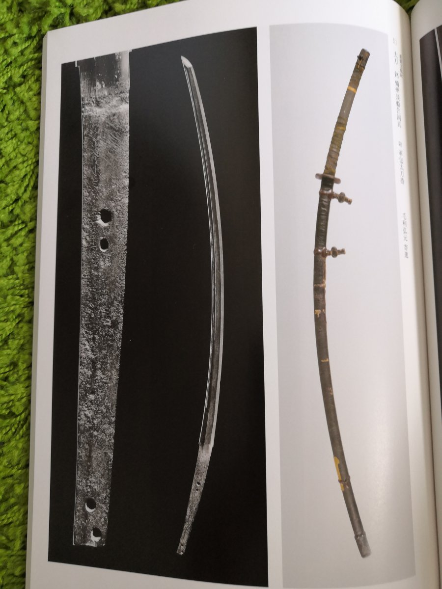

After turning a couple of pages I suppose this is the earliest shown form of an extended kissaki (I'm on my phone and don't know how to rename images; filename ends with 152).
Most of the larger kissaki shown within the first 100 pages are attributed to Soshu tradition. This is the first O kissaki (filename ends with 381).

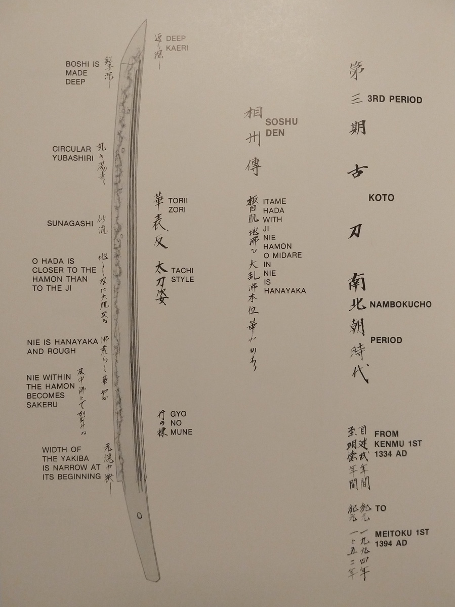

According to NBTHK, O kissaki is typical of the period starting Enbun ending in Joji ( 1356 - 1368)
Share this post
Link to post
8 hours ago, Gakusee said:
Hi Axel. Your post suggests the earliest o-kissaki swords are the Soshu ones.
as posted above, Yoshifusa did it some 50-70 years earlier.
Who am i to argue the information in the Teiryo Yoji. Whether or not it's correct, incomplete or lacking information is really not up to me. I'm too much of a novice.
They're all simply suggestions of what the swords look or should look like. It's very possible a Smith made o kissaki before anything shown in the book.
