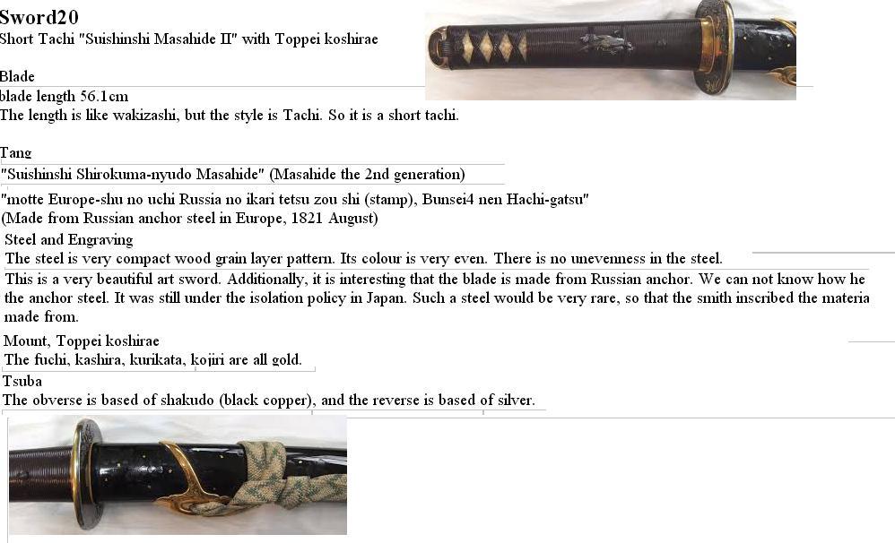

Blazeaglory Posted April 4, 2020 Report Posted April 4, 2020 Original posted on "usagiya". Would that be an Odachi I'm wondering? Quote
