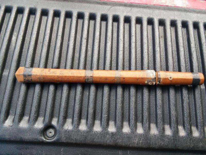

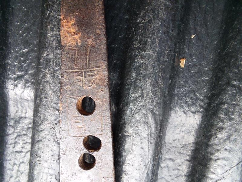

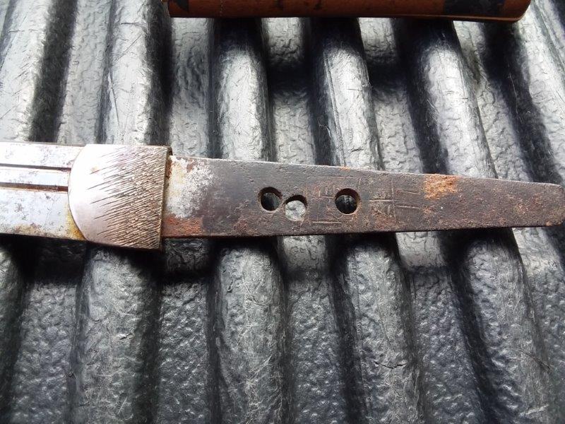

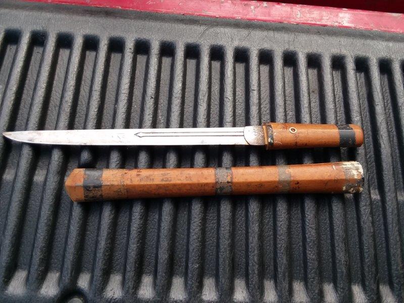

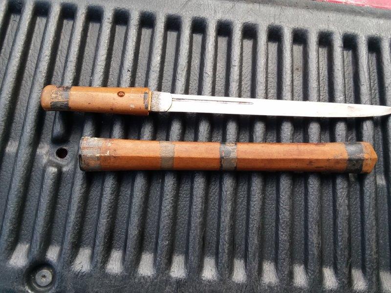

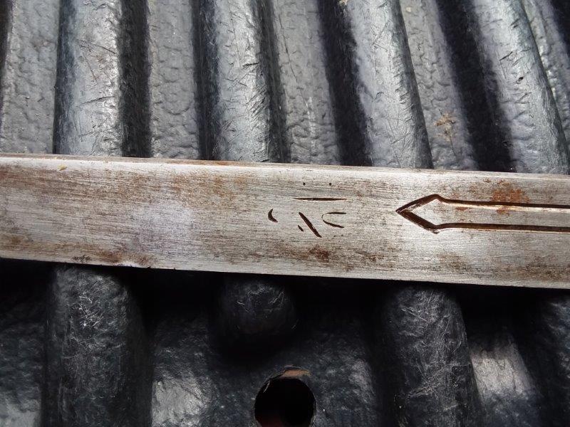

Rifleman Posted October 9, 2019 Report Posted October 9, 2019 I have this Tanto from a friend of mine.He and I are new to Japanese swords.WE would like to know what the tang markings mean.We know not to clean or otherwise do anything to the tang.Possibly the maker and mabe the age.There are not a lot of charaters on it and it looks like one of the holes went through one of them.Any help is appreciated.Thank you. Dale Quote
Stephen Posted October 9, 2019 Report Posted October 9, 2019 Kunimitsu Id guess koto Id clean the blade only with goo gone or goof off. https://images.app.goo.gl/E5R25WFfvFSqBPTU7 Quote
Grey Doffin Posted October 9, 2019 Report Posted October 9, 2019 Hi Dale, It is Kunimitsu and it wants us to believe it is Shintogo Kunimitsu, the #1 tanto maker of all time. First glance to me looks to be a forged signature (not legitimate. See below for the real thing from Fujishiro's book) but I can be mistaken and given how important this would be if it is correct, you need to proceed with care. DO NOT CLEAN OR TRY TO REPAIR ANYTHING IN ANY MANNER, PERIOD, NO EXCEPTIONS. Any amateur repairs can do irreversible damage. Someone who knows what he is looking at needs to see the tanto in hand. Grey 1 Quote

Brian Posted October 9, 2019 Report Posted October 9, 2019 Goo-Gone, isopropyl alchohol etc are fine on the blade (not tang)Would be nice to be able to see any hamon. This is old, and even if gimei it might be a nice tanto. Other than that...as per Grey, do the minimum. End with oiling the blade, and keep it lightly oiled. Quote
Rifleman Posted October 9, 2019 Author Report Posted October 9, 2019 Thanks for all the advice.When you say forged signature,do you mean a modern fake?Weren't forgeries also done in ancient times to fool buyers back then? Dale Quote
Rifleman Posted October 9, 2019 Author Report Posted October 9, 2019 Hamon is the temper line,correct?If I could get better photos vwould it show,possibly? Dale Quote
Stephen Posted October 9, 2019 Report Posted October 9, 2019 Hold the blade at angle to light bulb..look down the blade ..the hamon will show if visible. Quote
Grey Doffin Posted October 9, 2019 Report Posted October 9, 2019 Forgeries of important signatures have always been a problem, going back centuries. Grey Quote
Jacques Posted October 9, 2019 Report Posted October 9, 2019 Lot of Kunimitsu in Koto era.. This tanto seems being uchi-sori, right ? Nagasa ? Quote
